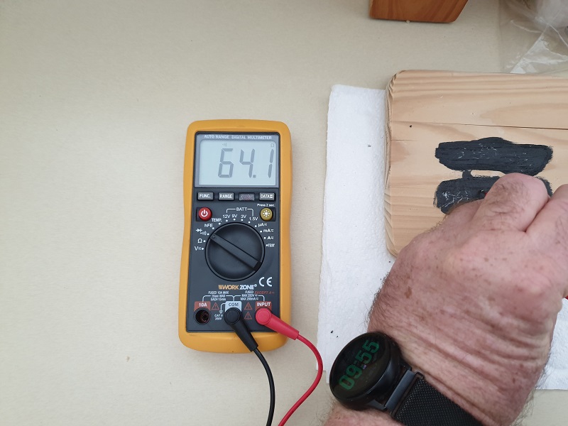

    I got nothing from the paper after four coats.
    I have now got three coats on an old cheeseboard and no go.
    Today I have added some more graphite and stirred in some water and the graphite. Now I have two coats and no connectivity again.

    Hi Ozzbike,
    the 2.9 k ohm resistance sounds reasonable(!) for a thin layer. But I'm not sure what you should be expecting!
    A 10 cm pencil line drawn onto paper typically has a resistance of somewhere between 10 k ohm to 100 k ohm - the variation depends on the type of pencil (or type of wax or binding agent holding the graphite lead together). At least you got less than that.
    What was the resistance of the 3 coats?
    Does the graphite powder conduct without the paint? Does the wet paint (with graphite) conduct?
    Also, how are you measuring the connectivity?

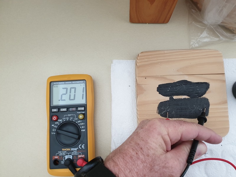

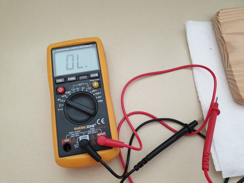

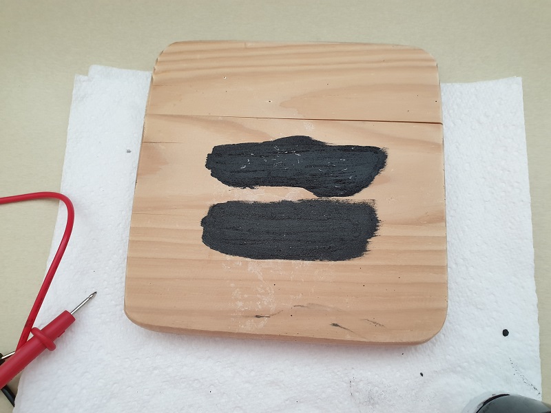

    I am using the digital multi-meter pictured.
    The top black line on the second pic has scratches from the red and black probes....not missing coverage. The bottom one has about four coats of varying ratio of graphite to paint to water.
    I am now getting some continuity giving digital number readings when the probes are about 30mm apart now. I still don't get a consistent steady reading on resistance.
    I will keep making tests and adding graphite until I either run out or get continuity and a steady measurement resistance.

    I have weird numbers on the meter...but they are consistent across the painted section now. No continuity beep....but I am getting numbers so something must be happening.
    That will do me now. I will have to think of how I can connect each cavity to the next. I think I may cut a small square of the copper tape...stick that to the painted wood and solder a wire to that.

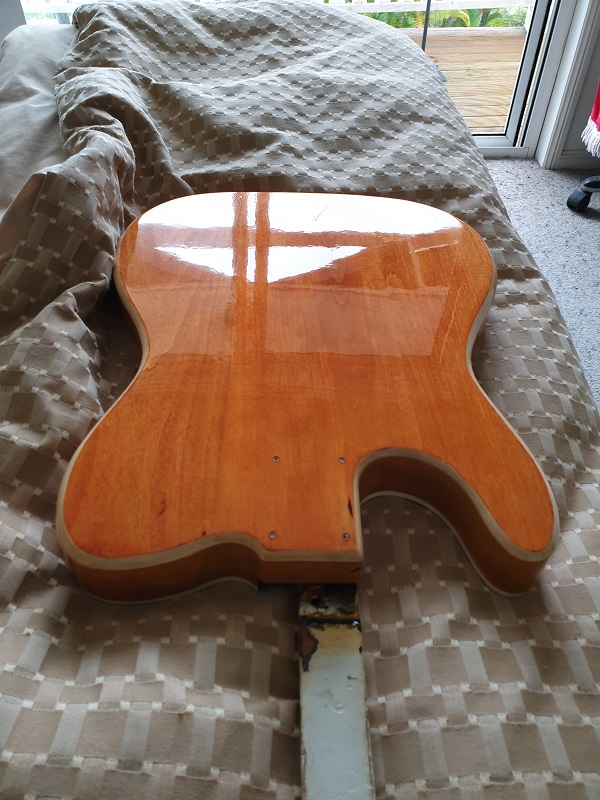

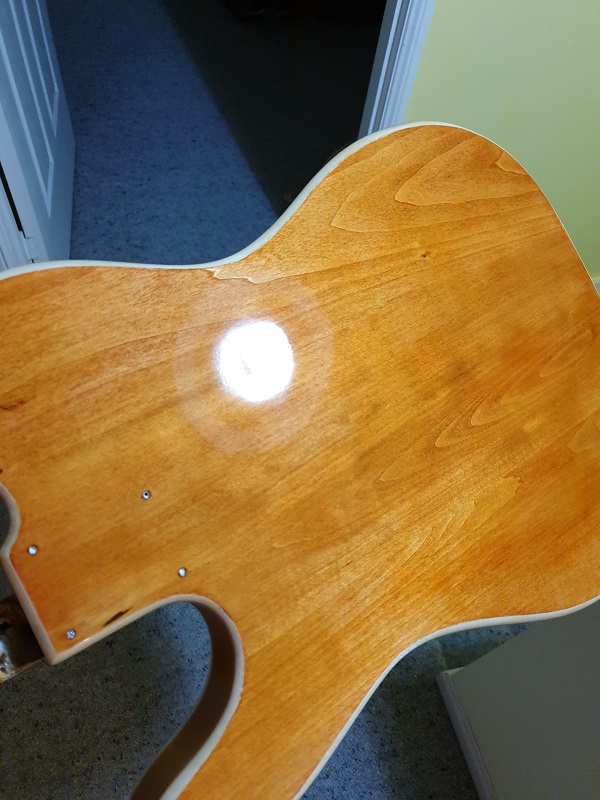

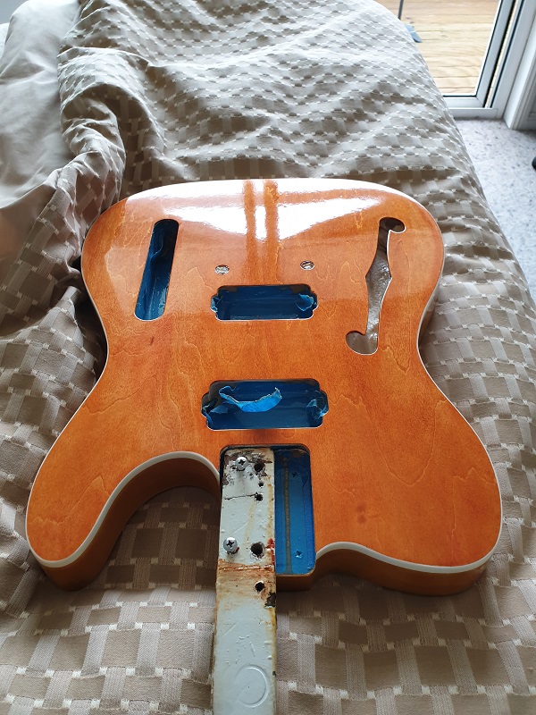

    Body shined etc by hand only.
    I have sanded (wet) at 2000 grit a couple of times all over the guitar body.
    Then 4 coats of Turtle Wax Light to Medium cleaner Polishing Compound. Then 4 coats of Meguiar's Ultimate compound, and then 4 coats of Meguiar's Scratch X 2, and then 3 coats of Bowden's Own Paint Cleanse and Restore, and then one coat of Bowden's Own Carnauba Body Wax.
    The two on the bed (the gold/brown looking thing) have been this morning buffed with one coat of Bowden's Own Lazy Wax, and then one coat of Bowden's Own Fully Slick.
    I will let it hang now as I do the neck...and then it may get some more hand waxing and buffing.
    The finish is not crystal clear, but I think it is a great outcome for hand polish/buff only.

  10. #60
    Mentor robin's Avatar
    Brisbane
    1,513
    Looks good Ozzie. You gotta be happy with that finish.
    By coincidence I have been checking out some of the same Tubes as you and was ready to pull the trigger on the DIY conductive paint. But I think I have enough copper tape for my next project so I might do some more research first. Plus my next will be single coils so it will need good shielding.
    Cant wait to see #38 when she is finished.
