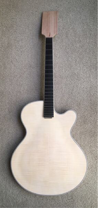

    I’ve had this sitting in the back of the cupboard for a while and thinking, “What am I going to do with this?”.
    Floating bridge and tailpiece is a gimme.
    I’ve been kidding myself that my first stained burst wasn’t a fluke and I have those stains at hand, or is it time for a red guitar?
    A couple (yes, two...but may only use one...options) of p90 humbucker sized pickups arrived this week and I’ve just sanded the neck to fit into the pocket, so it has officially commenced.

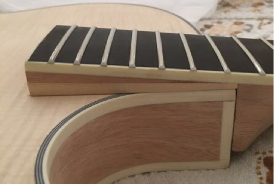

    Mentor DarkMark's Avatar
    Sep 2017
    1,578
    Credit where credit is due. The neck block in this kit is the best I’ve seen in a pit Bull guitar, proper solid wood.
    As I have to adjust the neck angle for a floating bridge (not the kit’s fault, my silly idea) I’ve glued in a wedge and started making the resulting adjustments. Not regretting my rasp saw purchase.

  12. #10
    Sep 2017
    1,578
    Tidy enough floating bridge adjustment for now.
    I’m still not settled on how I’m finishing this one. I’ve got about four different ideas, one a little more ‘out there’ than the others.
