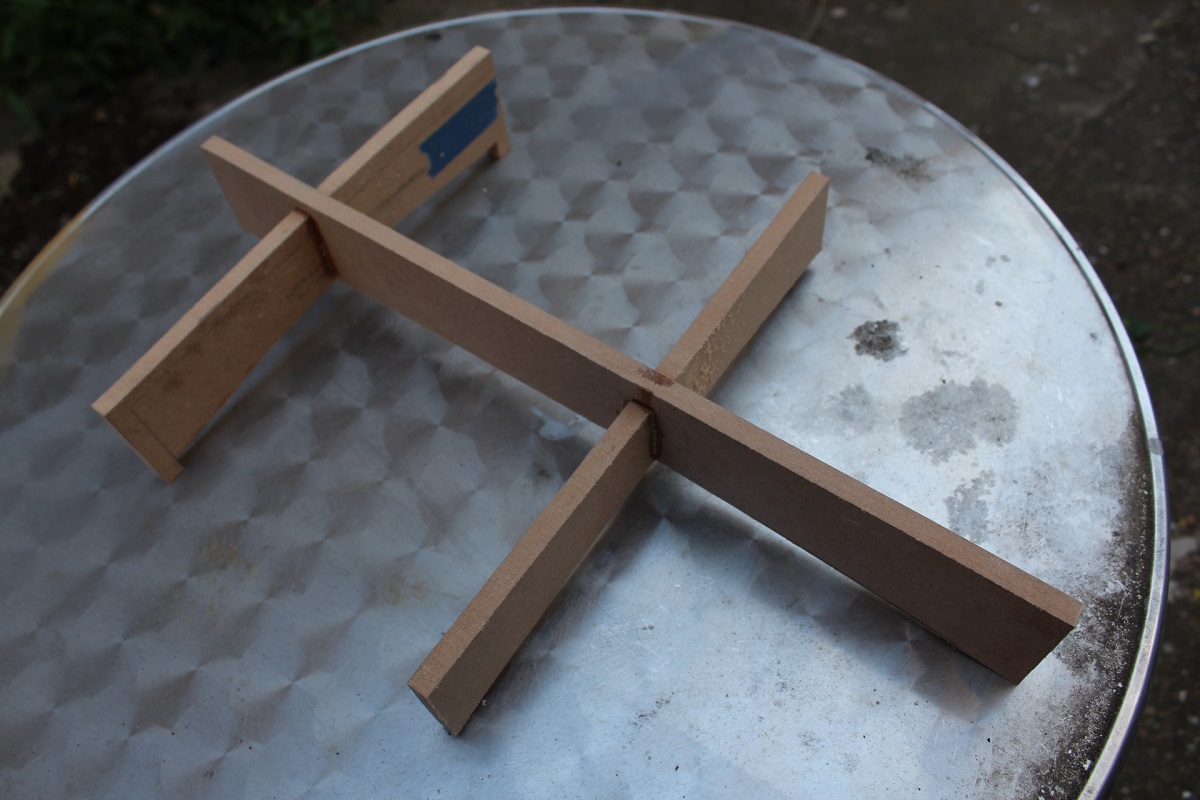

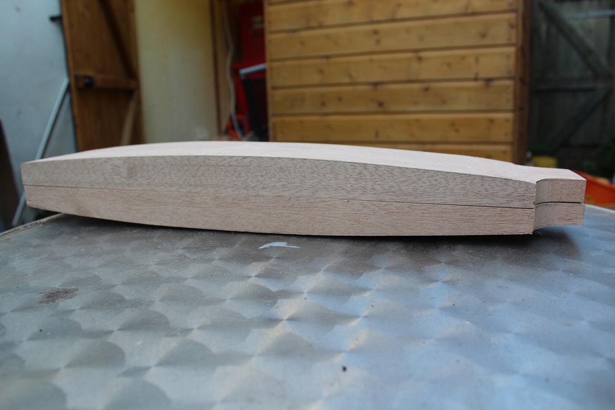

    2 body blanks made from 18mm mdf drilled for dowels for securing the laminated sides
    various templates of the archback profile made
    Neck template made
    All required timbers bought mostly finished to thickness.

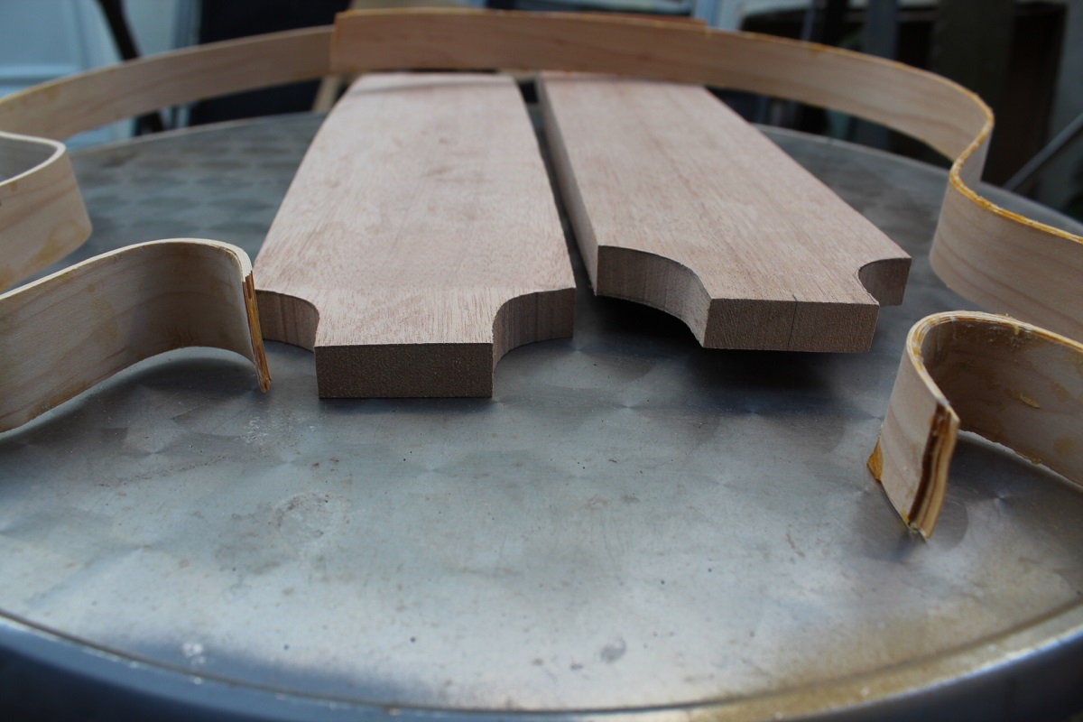

    Sides laminated from 0.6mm maple veneer (6 layers)

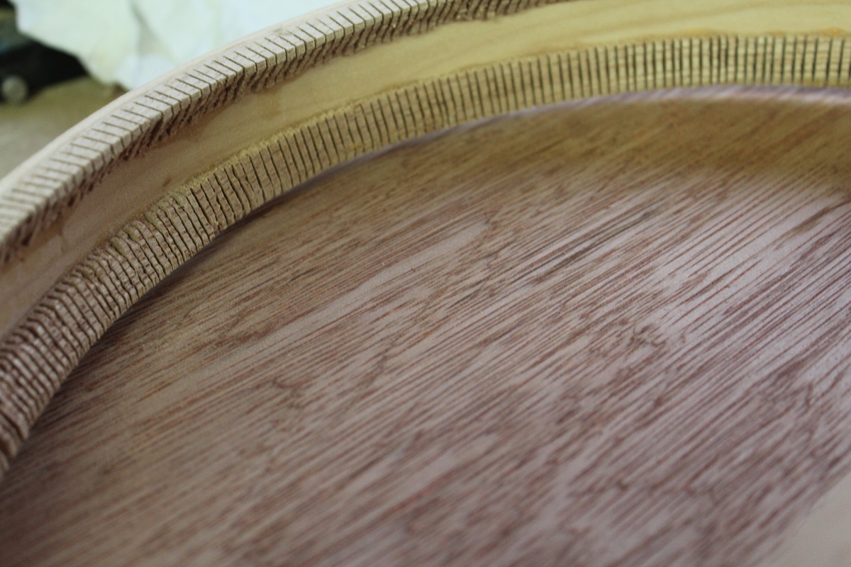

    Copious amounts of mahogany kerfing made
    Top and bottom cut from marine grade 3.6mm mahogany faced plywood.
    Maple veneer glued to the top. (first attempt was a failure but luckily I had 4 sheets so I can use the failed one as a practice top for fitting switches, knobs f holes etc. and for stains and sanding sealer).
    Centre timbers cut from mahogany and compound curved with a hand plane and sanding block

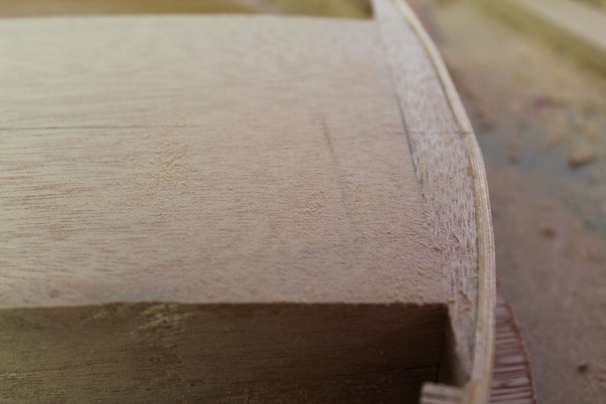

    End block for the timbers made (this is used at the rear of the body to take the neckstrap screw rather than screwing into endgrain).
    Next job is to glue the 2 timbers together and start fitting the sides. The sides are critical as where they fade into the neck it needs to be an almost invisible join.

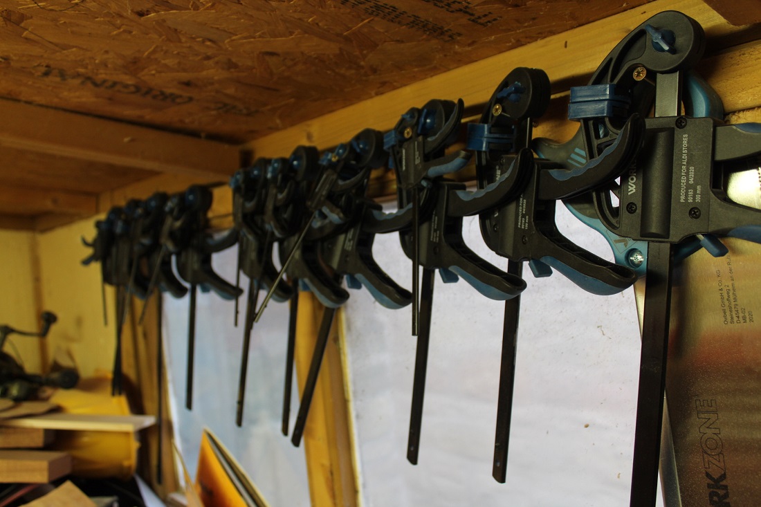

Name:	Can't have too many clamps.jpg

    I'm not clear on how you've shaped the top and bottom. I don't think I could take on that three dimensional shape.
    Build #4, pre-owned PB ESB-4
    Build #5, Lockdown Mandolin
    Build #7, Mini Midi Bass
    Apr 2020
    Northumberland UK
    124
    I took the profile from my ES-1GT kit using a form gauge (one of those tools with lots of sliding plastic sticks that follow a profile).
    Used it length ways and then multiple cross ways. Modified the actual thickness by checking specs for the Gibson online.
    A lot of careful hand planing to get the end to end profile and then hand sanded the profile constantly checking the templates.
    About a day and a half but it is pretty close now.
    I have not done anything this critical before but it was not too difficult - just take your time.
    The actual top and bottom surfaces are plywood sheet so will bend to their own profile - the trick is to not introduce too much stress into the plywood or it will pop the glue joints.
    As you can see in one of the pics, I have plenty of clamps available and I think about 20 will be used to clamp it all together!

    Time for a quick update.
    I have glued the 2 center blocks together and glued the rear block in place. the sides have been glued to the center block and the kerfing fitted and sanded to profile.
    I had cut the bottom plywood skin but on doing a test clamp of the top and bottom I found a mistake. The bottom was a fraction too small. It would probably have been OK as I will need to rout it anyway for the binding but I decided to cut a new one.
    I have now done the test clamp and it all meets where it should.
    It needed a lot more sanding to get a good mating surface with the kerfing though.
    No photos today but I will take a few tomorrow as I glue the bottom on,
    Just the bottom gets glued as this then gives me the chance of cleaning up any glue mess that could be visible through the F holes.

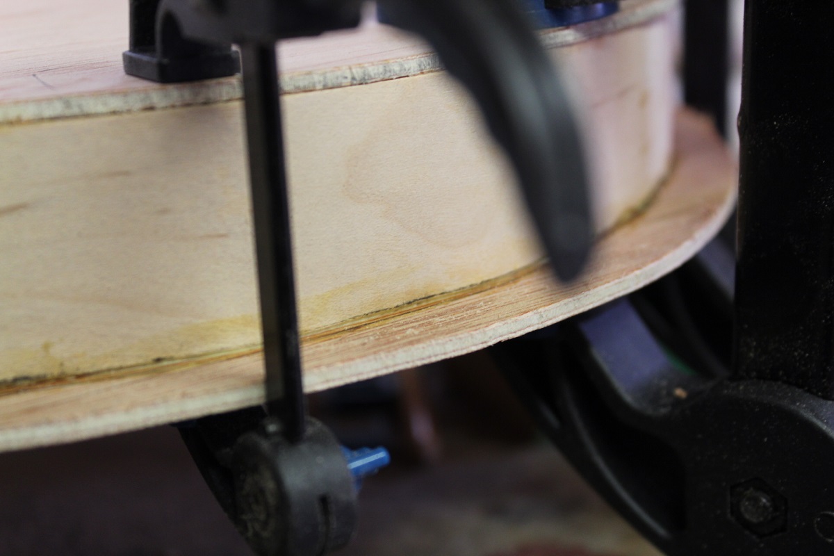

    Todays progress.
    I have glued the bottom on!
    Not sure that gluing one side at a time was a good idea though.
    When I take the clamps off, the back may try to revert to its original shape ..... FLAT!
    We will see.
    Glue line looks good but there will be a fair amount of cleanup required although the joint line itself gets routed for the binding.
