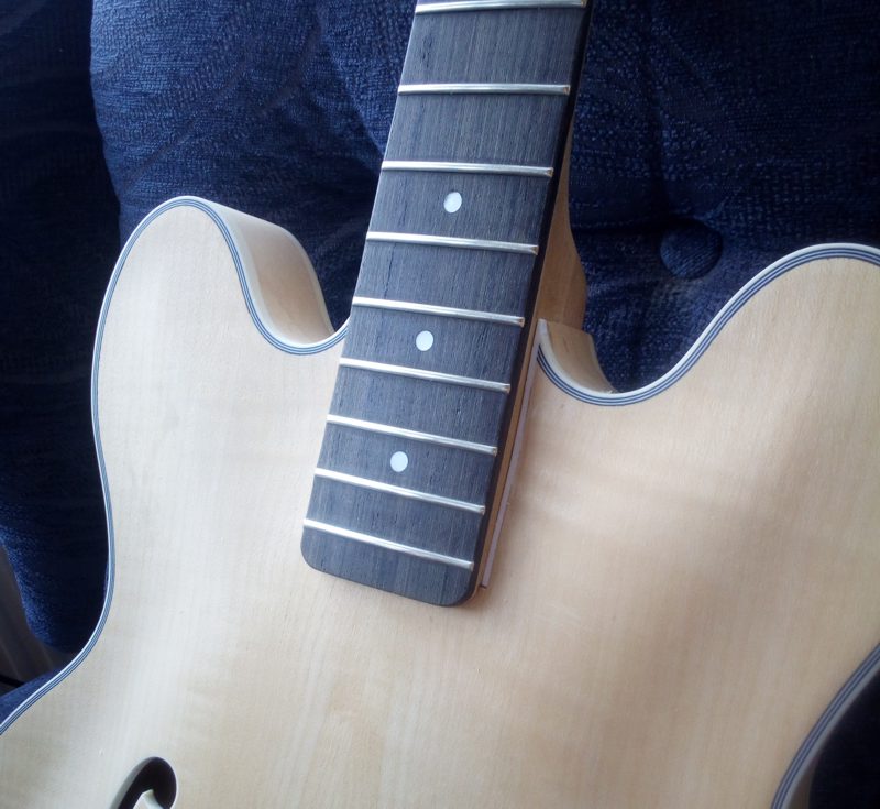

    Apparently the neck pocket wasn't quite as accurate as one might like, so he had shimmed it with maple veneer so the neck ran down the centreline, but this left the end of the maple shims exposed, which looked worse than one might hope. So to disguise this I first thought of a strip of maple each side, but the piece of maple I had didn't match the body at all. Binding and purfling right round the neck pocket might have been best, but I was unable to duplicate the purfling so I just put in some 2mm white plastic I had. The ends should probably have curved round the pocket, but i wasn't too confident about cutting a neat curve by hand, and it will be fine from five feet away...

    You got to love a free guitar! Sounds like it will be good project.
    re: the maple veneer shim, Can it not be trimmed back with a hobby knife/scalpel?
    It could then be "creatively hidden" during the finishing process in a number of ways I would think.

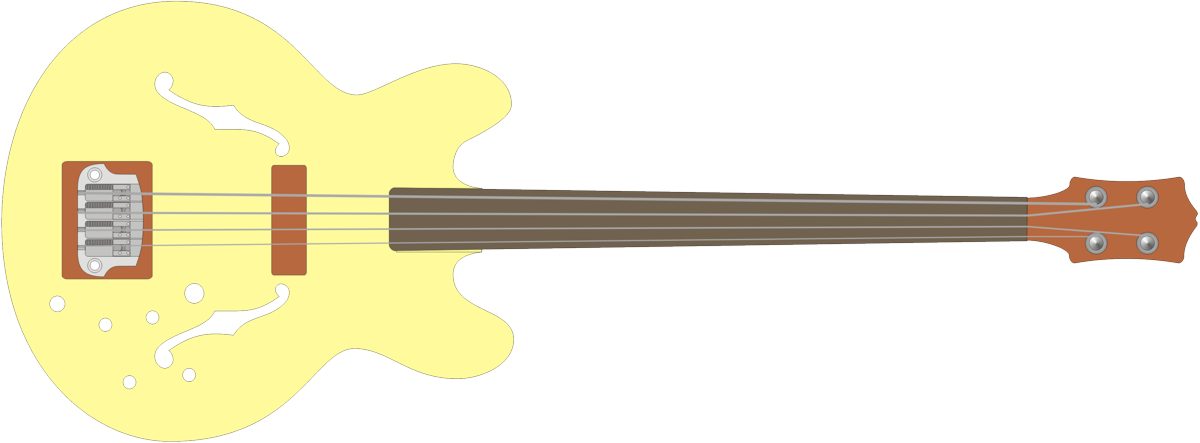

    Supposing I rout out a square in the top of the body, parallel with the fretboard, and glue a hardwood block into that. Make the block a suitable width, ie a bit bigger than the current centre block. That would give me a block a few mm higher than the body which almost any suitable bridge could be screwed down to. Then I thought maybe a veneer on the headstock to match the wood of the bridge block, and perhaps one of the Artec wood cased pickups to match too - bubinga for all three maybe.
    Might look something like this?
    Does this sound practical, or is there some obvious flaw I have failed to spot?
    [Later]
    I've decided against this. I realised I was starting to turn what was planned to be a budget project into a rather complex expensive one. I figure that if something does go badly wrong with the bridge mountings in the centreblock then that will be the time to do something radical, and if it doesn't then no problem. The only thing that worries me is that the surface the bridge is coming down on isn't flat, and I'll need to do something about that. I think its going to get the Maxon pickup (see above) as its main pickup, and an cheap telecaster neck pickup (also from the bits box) up against the neck, more to give a justification for the extra knobs there are holes for than anything else. I figure pickups can always be upgraded if need be.

    It's not an obvious flaw, it's just tricky... I am working on my second highly modified ES bass body, and I have found it really tricky and difficult to rout on a curved surface. I considered doing this with my two ES bass builds. At some point I decided it was too hard and went with two point bridges.
    If you do what you propose, I would ditch the three point, and use something with a smaller footprint like a Fender or a Badass style bridge. You should also do some careful measurements because I think the back of the bridge will have to sit pretty high. You should be sure you're happy with how it will look.
