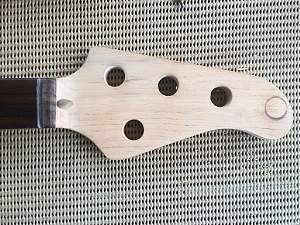

    Mucking around with the MM headstock on a PB paddle. I reckon I can make it work. A little bit more finessing, and a plan to cover the filled 5th hole with a decal perhaps.

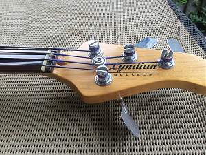

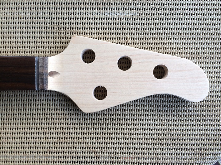

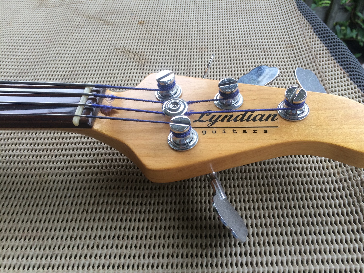

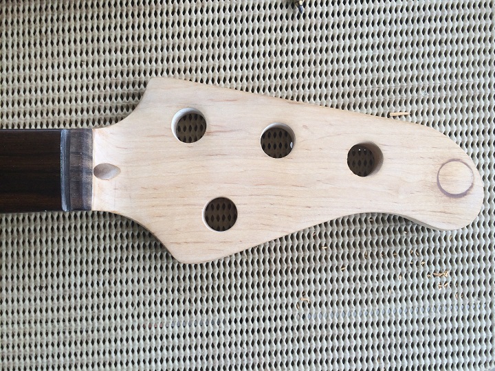

    Hey DM, I wanted to do a similar thing with the headstock of a 4 string fretless build. Handmade a plug and covered both front and back with some maple headstock veneer. Even at close inspection its almost impossible to tell its veneer.
    Before

    After
    Finished
    Cheers
    rob

    Very nice work. Did you sand off a mm or anything from the headstock before affixing the veneer?
