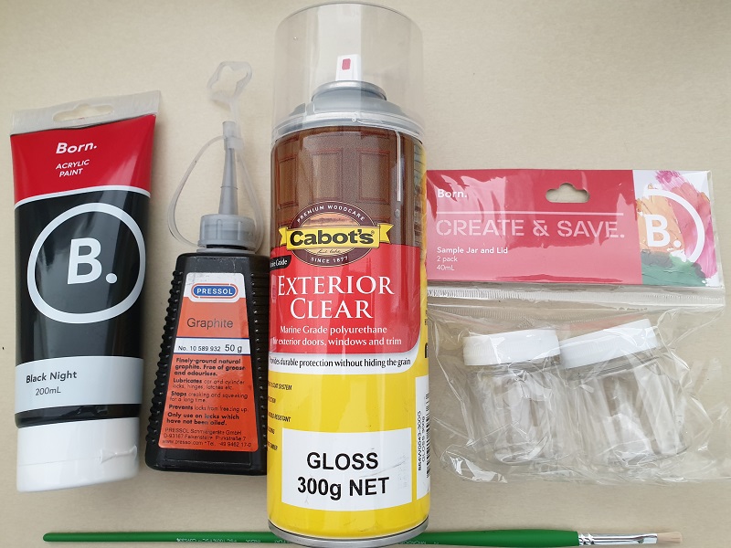

    DIY stuff.
    I had to go to the BIG Green shed today...and here on the sunny coast an Officeworks is right next door.
    So after reading some stuff...watching a video or two...I have decided to give making my own conductive shielding paint a go. I got some graphite powder for about $5 from the tool shop of the big green shed, the water based acrylic paint was $10 from Officeworks and the paintbrush was $1-70....I did not need the containers but I thought why not....$3-00.
    So lets see how conductive I can make it.

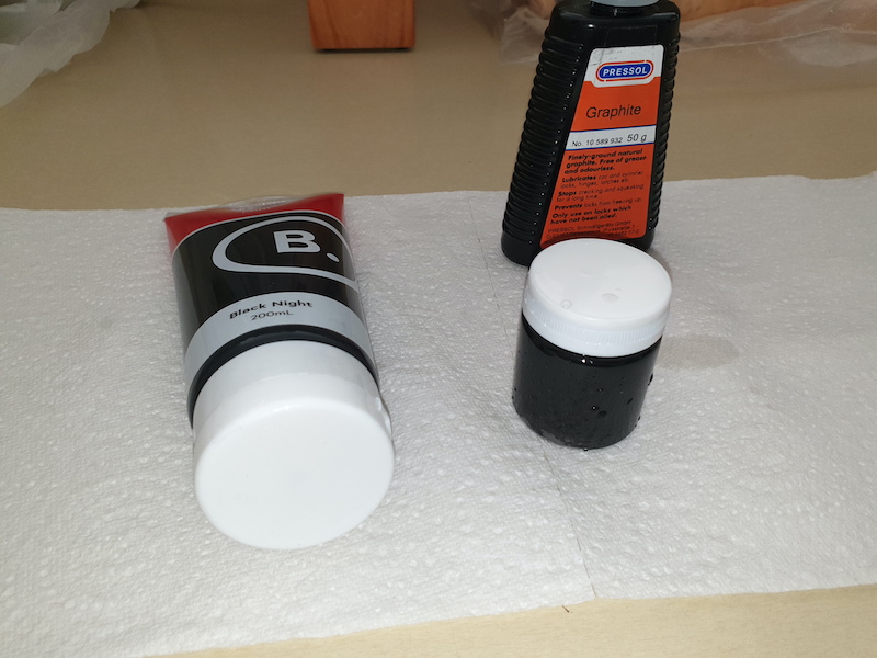

    The mix is made.
    This stuff is not easy to work with. WARNING...graphite is evil. It will get into...dust over...anything and everything.
    Lay out some paper towel before you start.
    The ratio was listed on one YouTube video was volumetric....imperial though....1 ounce of paint to 3 x teaspoons of graphite. So a google conversion from USA volumes to metric gave me roughly....30ml paint to 3 x 5ml (15) of graphite.
    I have a measuring cup and that works well for the graphite.....then just tip it into the container. (Oh get a bigger one then mine.)
    The paint measures fine as well. But how do you get it out....it is like honey....lots of end of spoon scraping.
    Mixing was fun too.....dribbles of water and end of teaspoon stirring until no more gritty feelings.
    I have a consistency of a thick shake will a little fine ground salt in it. One small strip on a double layer of paper towel.
    The absorbent nature of the towel may be closer to unsealed wood than I thought. I will leave it for an hour and put another layer on.
    I have dug out my multi-meter and will see firstly if we have continuity and then see if I can measure the resistance. Maybe somebody here would be able to advise if the end result resistance is any good as a shield to R.F.I.
