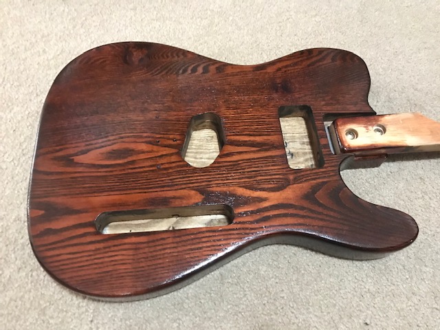

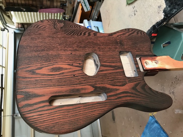

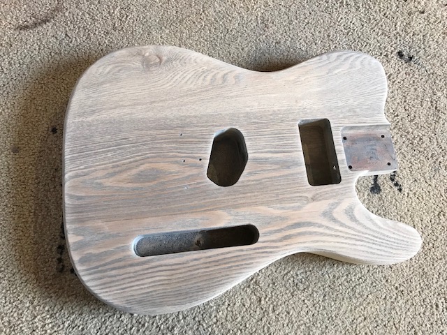

    Somehow I ordered a TLA-1 kit as a side project. The Kit looks nice.
    Started working on the body.
    Lots of sanding.
    Put on a slurry of ebony Timbermate.
    More sanding.
    Put down some FW jarrah stain.
    Then put on 2 brushed coats of tru-oil. Very happy with the result so far.
    Now I will begin the many thin coats of tru-oil.

    Oh wow, Trevor, that's looking very fine...
    I've also been tempted to accidentally order one of these kits. Standard hardware, or other?
    Mentor dozymuppet's Avatar
    Jun 2020
    842
    Also, is that a subtle burst going on there, or darker sides?
    2,039
    Standard hardware!
    Though the kit did not have a bridge and they sent me a replacement - but it is different to other kits.
    Also came with a Rosewood fretboard (and not the maple) and a pearloid pickguard. Go figure.
    2,039
    Quote Originally Posted by dozymuppet View Post
    The stain is a bit darker on the sides. No burst.

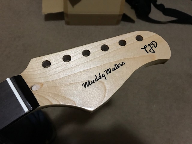

    Headstock shaped. The neck and body have been tru-oiled (about 20 coats). The logos are inkjet waterslide decal paper coated with tru-oil.
    Mentor Andyxlh's Avatar
    1,206
    The head stock shape and decals look really good. I like the body colour too.
