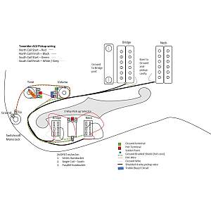

Mike here in Perth about to start my first build. I am waiting to recieve my PSH-1 kit which is hopefully only a few weeks away but I thought I would get started planning my wiring. Taking inspiration from Bakers Dozen's build I plan to add a couple of DPDT on/on/on switches to run the humbuckers in series, parallel and full split. If anyone has any feedback on the proposed routing around the F-hole I would be grateful. (see attached picture)
I am also debating whether to run a 0.47 Tone Cap or 0.22 Cap. I am looking for a fuller mellow sound hence the 0.47 Cap. Does anyone have experience with Cap sizes running teh Toneride AC2 pickups?
