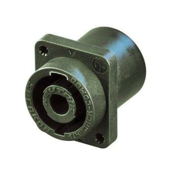

    On the other hand for someone building a cab, I think the Neutric combo jacks are still my favorite, due to their practicality. They are a good solid TS jack, but will also accommodate 2 conductor speakons Click image for larger version.
