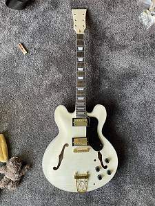

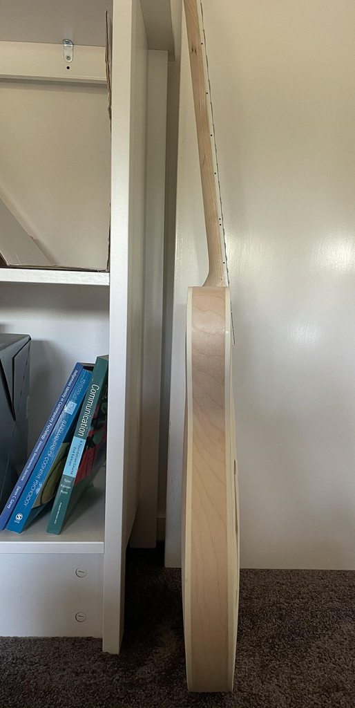

    Did a little mock build on the weekend with the spare time that I had to see whats what.
    Here's a few pics that show the angle of the neck which I now see as being quite normal:

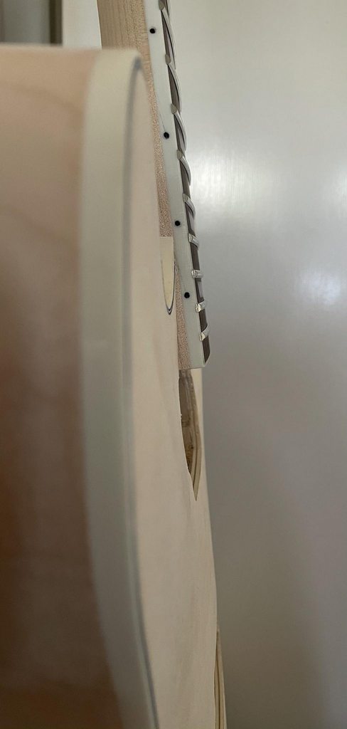

    There is a slight gap at the back where the neck meets the body. Not sure what I'm going to do about this yet. Maybe I will have to see what its like once its actually glued in. Filler of some sort?

    Everything seems to be in order though:

    That little gap under the heel isn't unusual, I had the same on my kit. Once clamped and glued if mostly closed up. I then did a coat of finish, let it dry, ran a bead of superglue along it, let it dry and recoated and it's fine.
    When you are clamping for glue, be careful how much force you put on the heel as it is possible to move the break angle in that process, worth checking and double checking as you go before letting it fully cure and bond.
