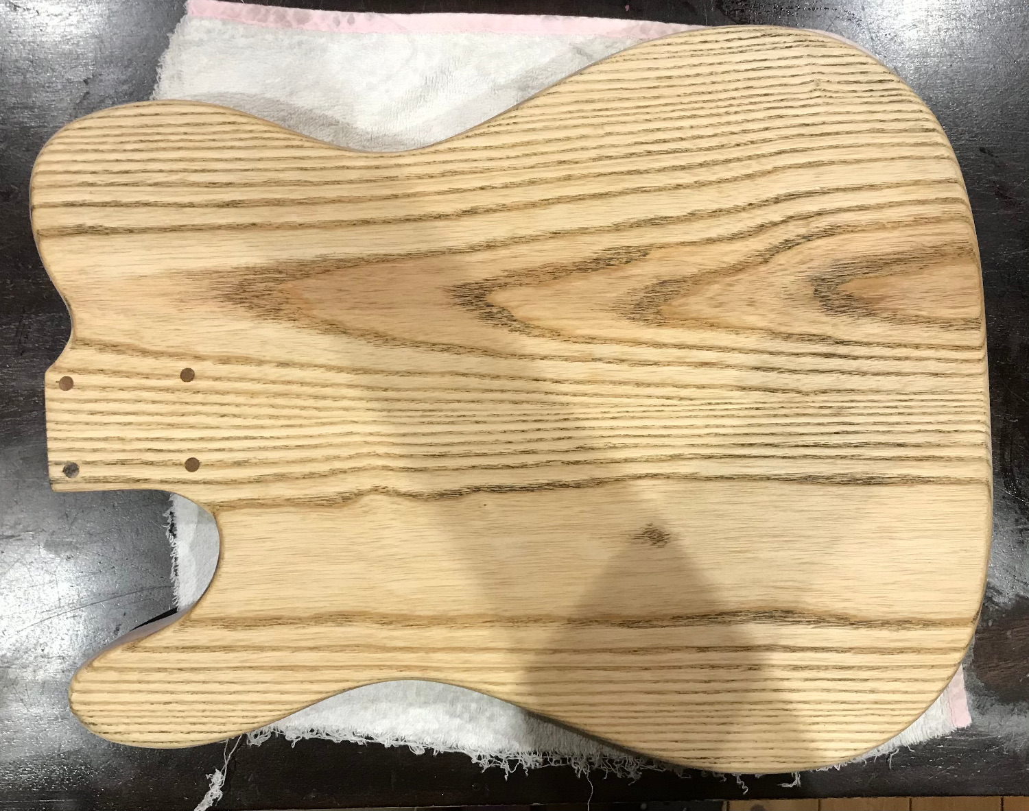

In the meantime, I had also given the body a coat of ebony timber mate, and sanded back. I ended up sanding pretty much all of it off to get rid of all the scratches and machining marks, but I'm pretty happy with it now.

At this point (i.e. after sanding, but before re-drilling holes) I gave it another coat of timbermate, and left it for a few days to let the filler shrink. Unfortunately, when I came back to it, I found that the body has split along the join.
