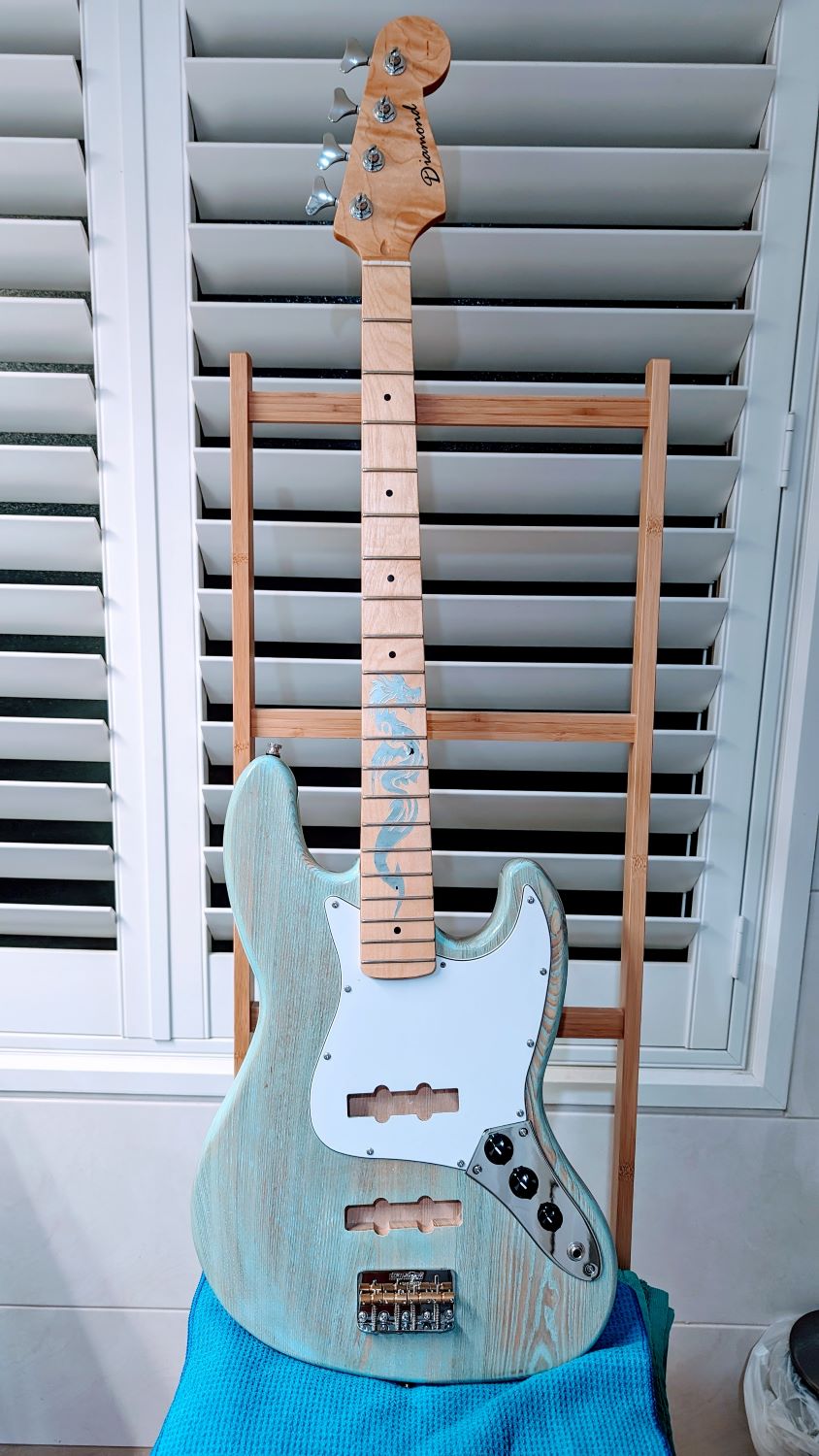

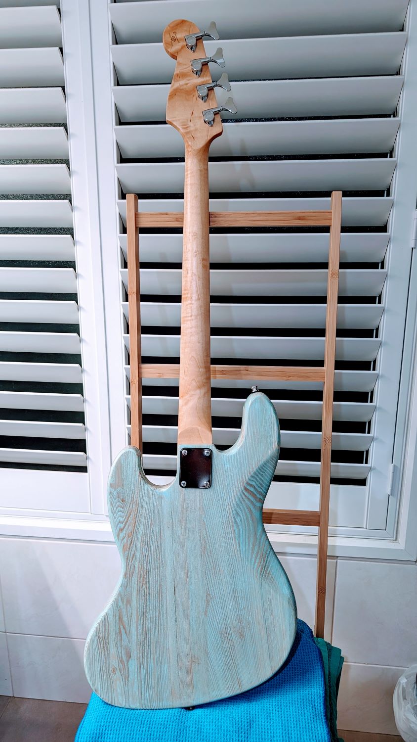

    Thanks everyone. I think I can solve the neck pickup issue with a new pickguard that has a standard cut-out. There's plenty of space in the cavity under the pickguard.
    For the Bridge, I used a sanding barrell on my dremel to widen the "ears" a couple of mm's. The actual pickup width is just right. It looks a touch strange to have lopsided ears but it really won't be noticed with everthing in place and the strings on. If it gets visually annoying I have found a US retailer that sells a pickup ring for a J-Bass bridge pickup. It wouldn't look too bad, I don't think.
    Have attached a couple of photos of the build so far. I'm really happy with it. It's a gift for my niece who has been learning to play Bass for a couple of years now.

    I should add, for those looking to build one of these kits with modifications:
    - The headstock holes are too big for the Grover Mini Machine heads. I had to use the ferrules from the kit machine heads to make them fit. Even with this, you can just make out the holes at the back of headstock as the Grover units are quite small.
    - The bone upgrade is an ok fit but needs some work
    - I got Pitbull to swap out the standard neck for a Maple one. It was an ok fit but just a touch loose for me.
    - The rest of it I am quite happy with but, apart from the machine head ferrules, I have swapped out every other piece of hardware (including the pickguard, once the new one arrives).
