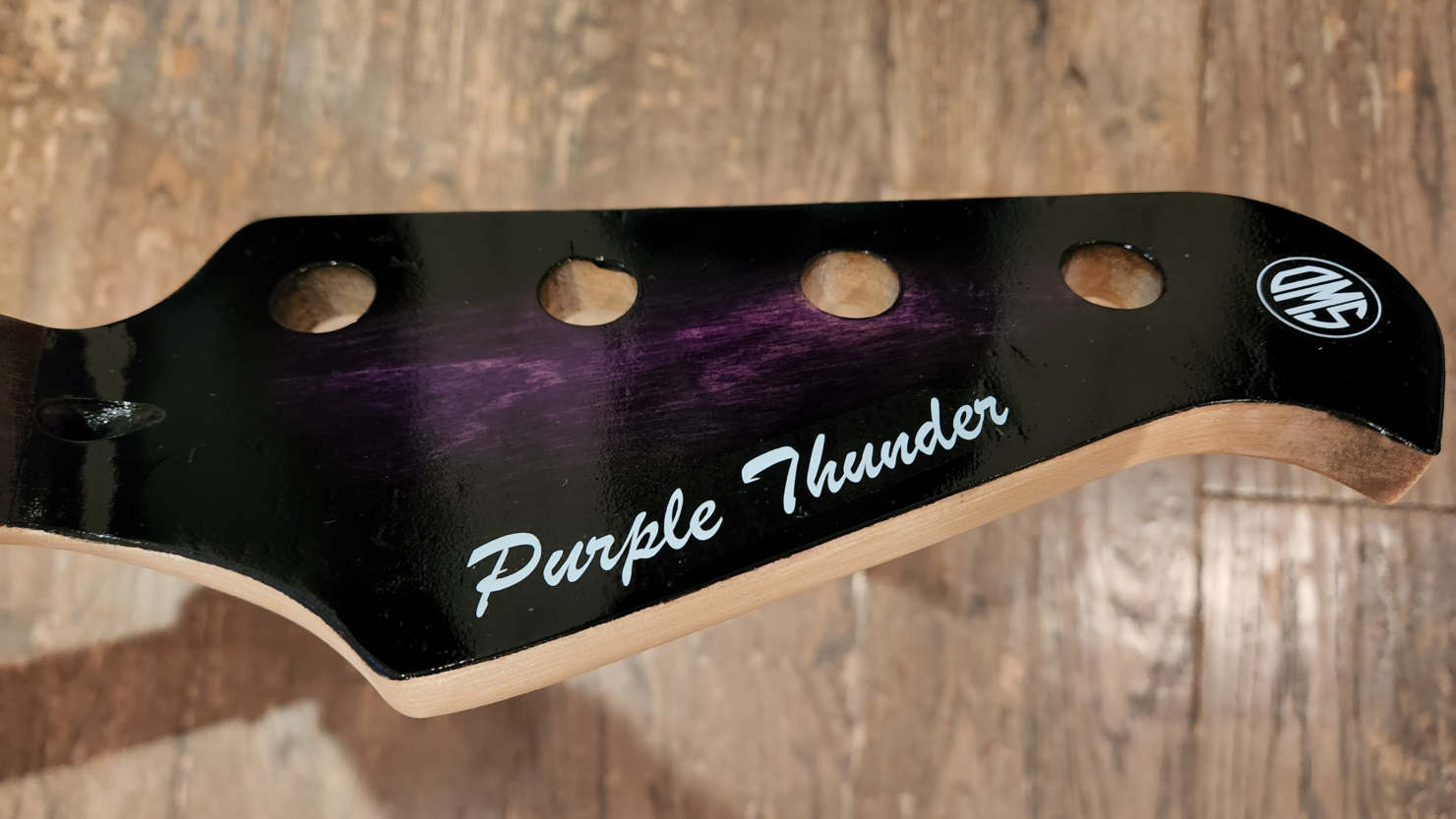

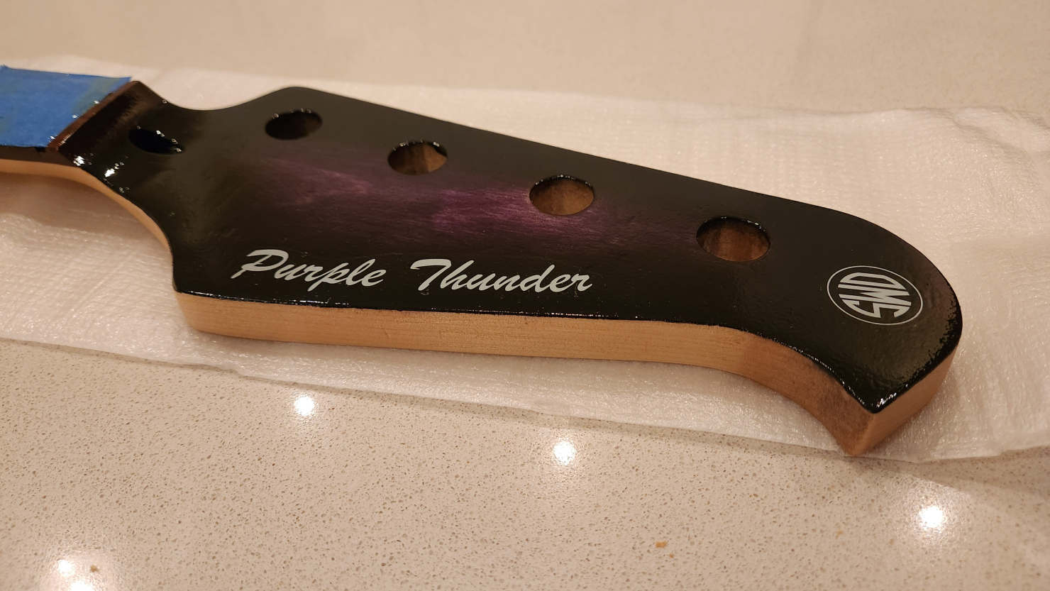

    6. Apply 1 double header coat of Cabot's Clear Stain Exterior Aerosol (Gloss) to face of headstock
    7. Spray burst face of headstock with Self-Priming Acrylic Aerosol Paint (Black)
    8. Apply decals produced on Waterslide Decal Paper
    9. Apply 5 coats of Cabot's Clear Stain Exterior Aerosol (Gloss) to headstock front, level sanding before final coat
    10. Apply 3 coats of Cabot's Clear Stain Exterior Aerosol (Satin) to headstock sides/back and neck), sanding to 2000 before final coat
    10. Level sand headstock face with 600 grit then wet sanding with Micro Mesh Pads (1500, 1800, 2400, 3200, 3600, 4000) changing sanding direction with each grit

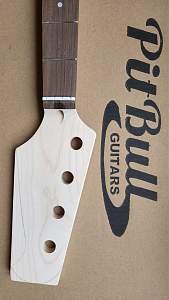

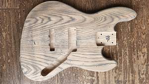

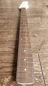

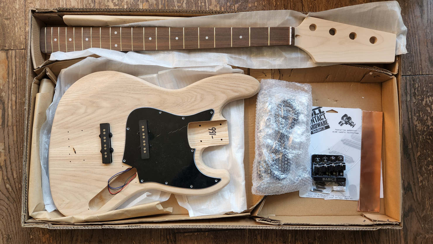

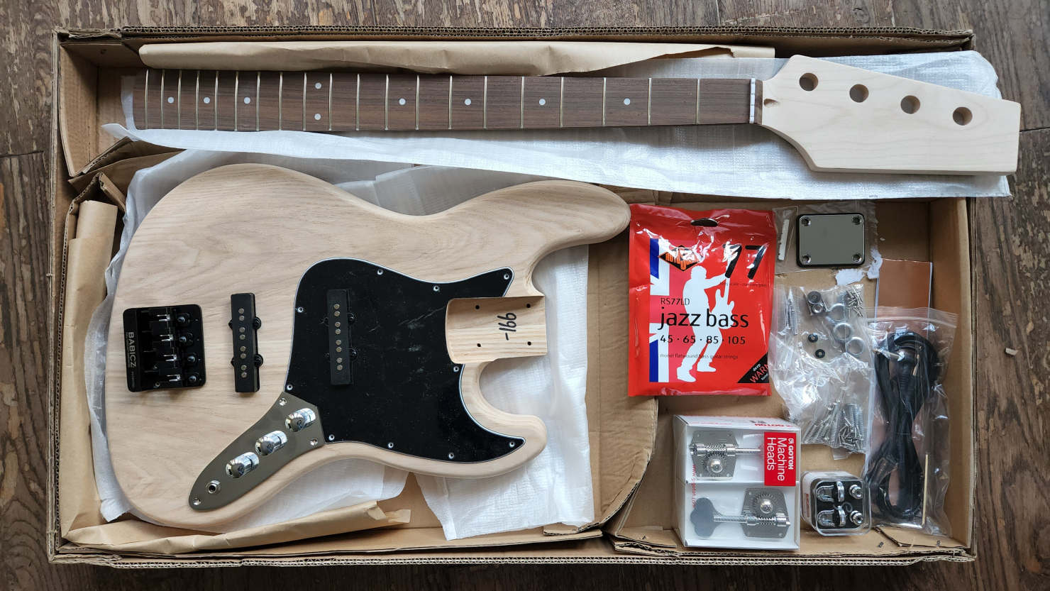

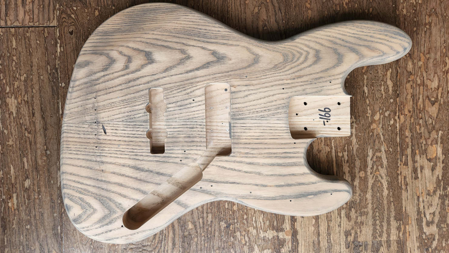

    My kit arrived in the post today. Just waiting for my toneriders to arrive tomorrow and I'll make a start.
    Surprisingly, the kit arrived with the stock pickups installed and the bridge screw holes pre-drilled.

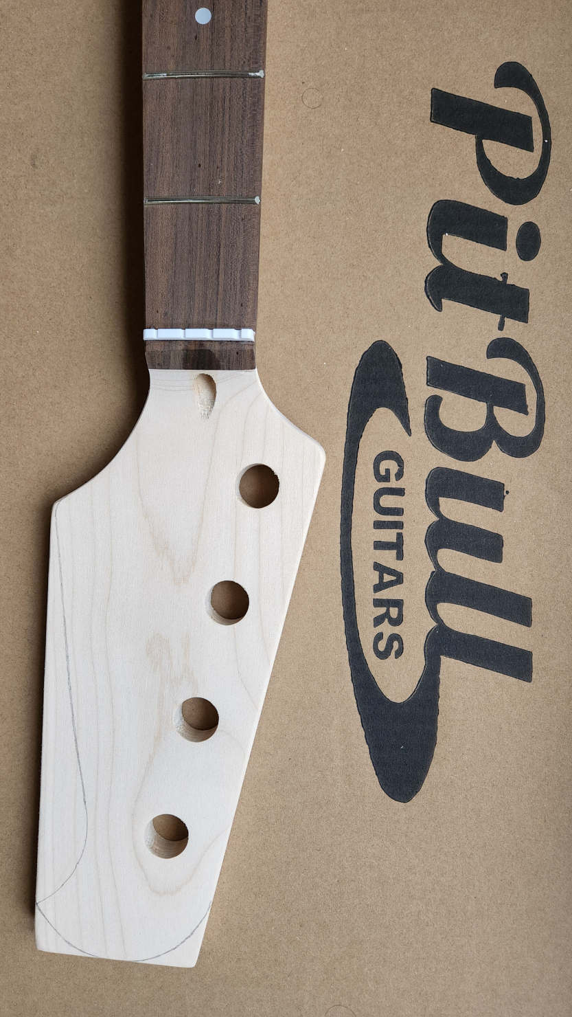

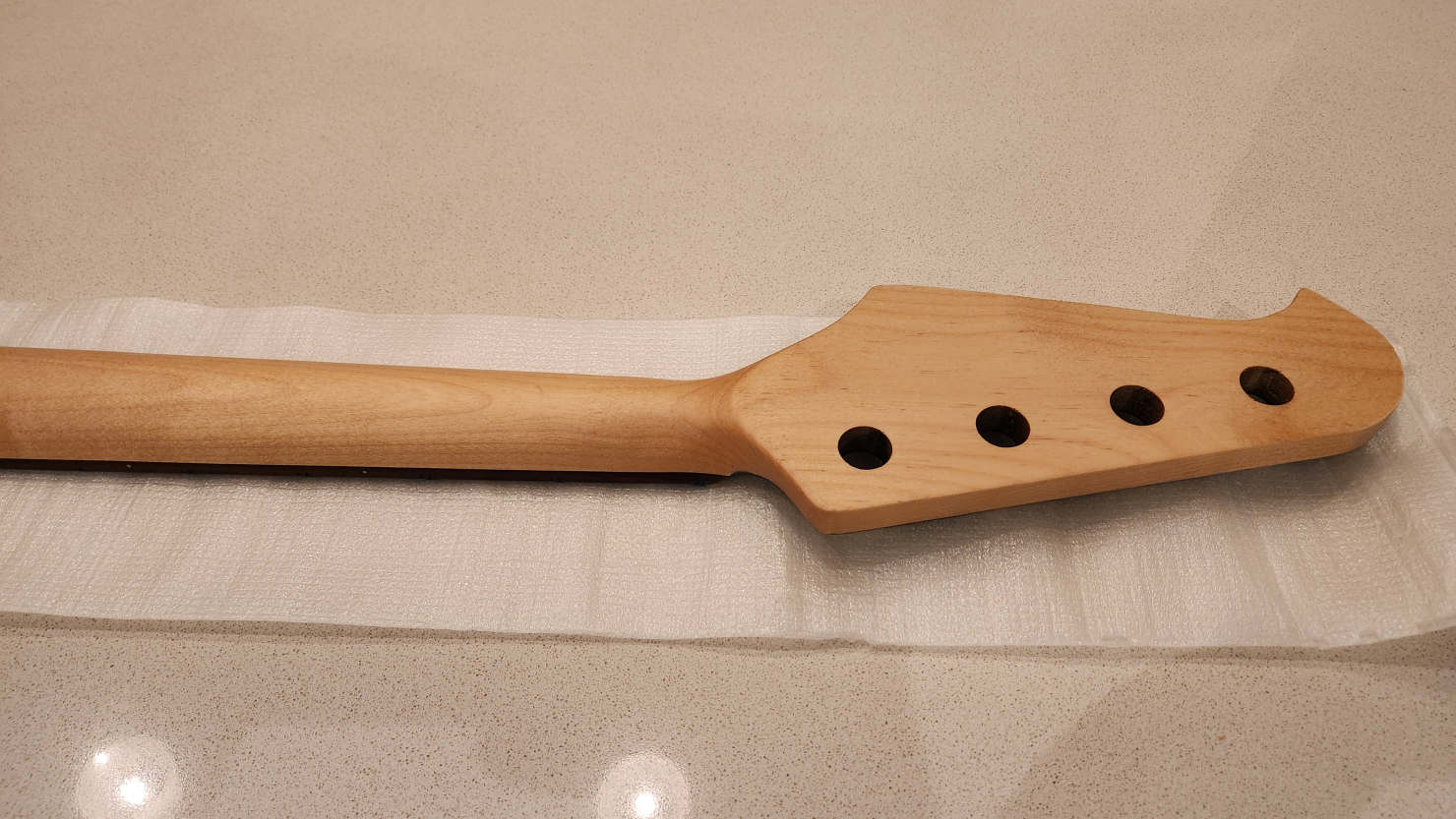

    Body and neck look really good!Click image for larger version.
ID:	43409Click image for larger version.
ID:	43410Click image for larger version.

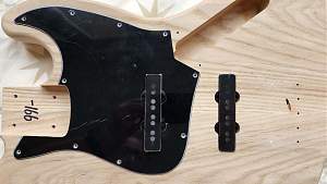

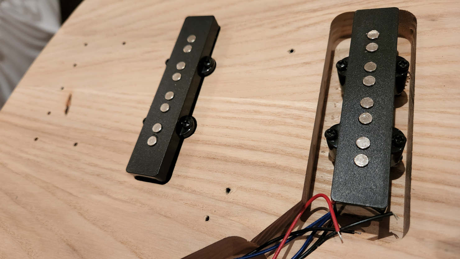

    I've written to Adam to solve the mystery of the preinstalled pickups and pre-drilled bridge screw holes.

    Made some progress today:

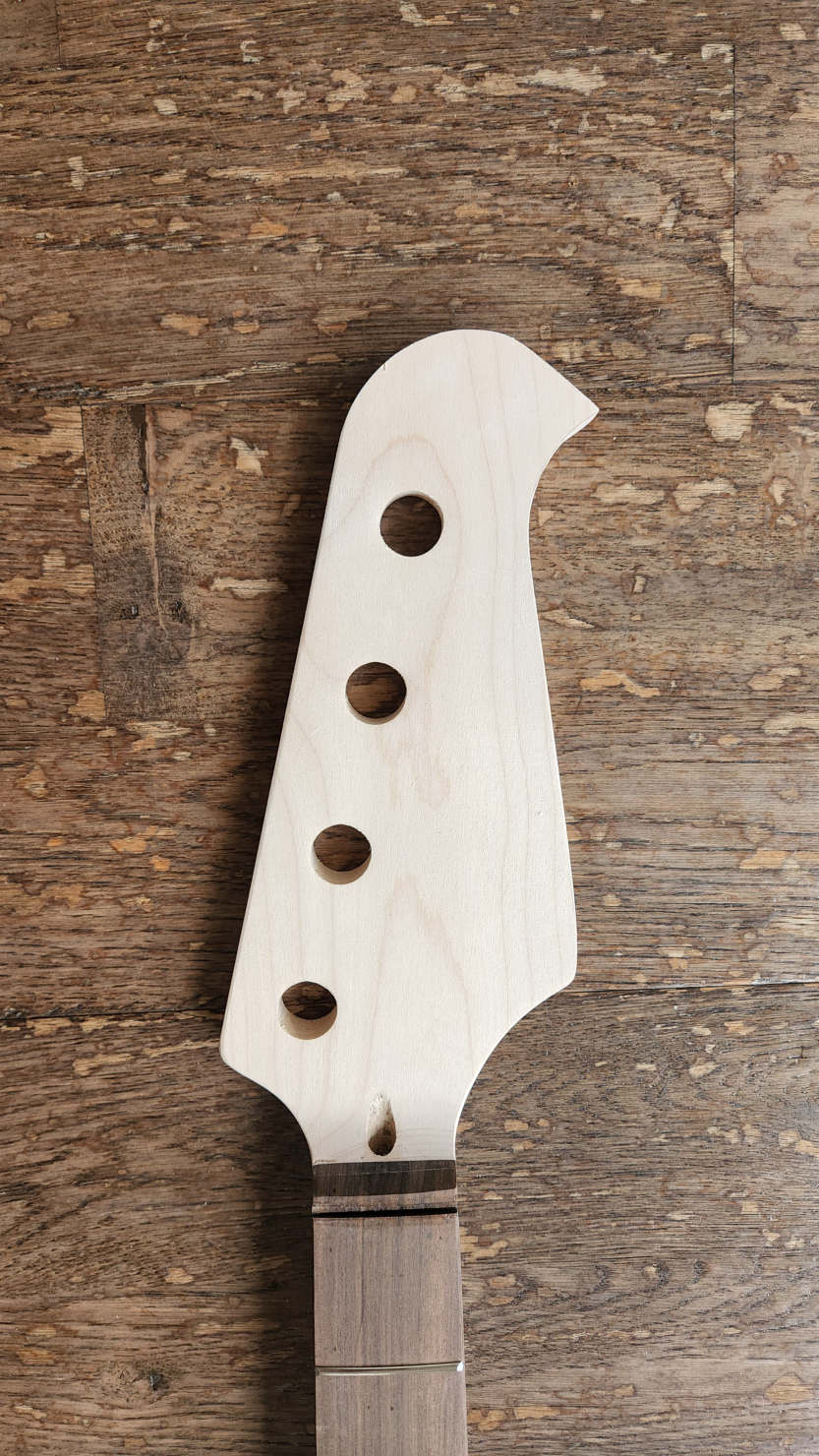

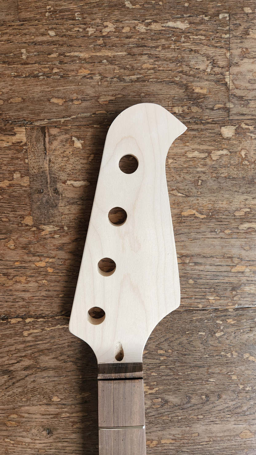

    Designed the headstock

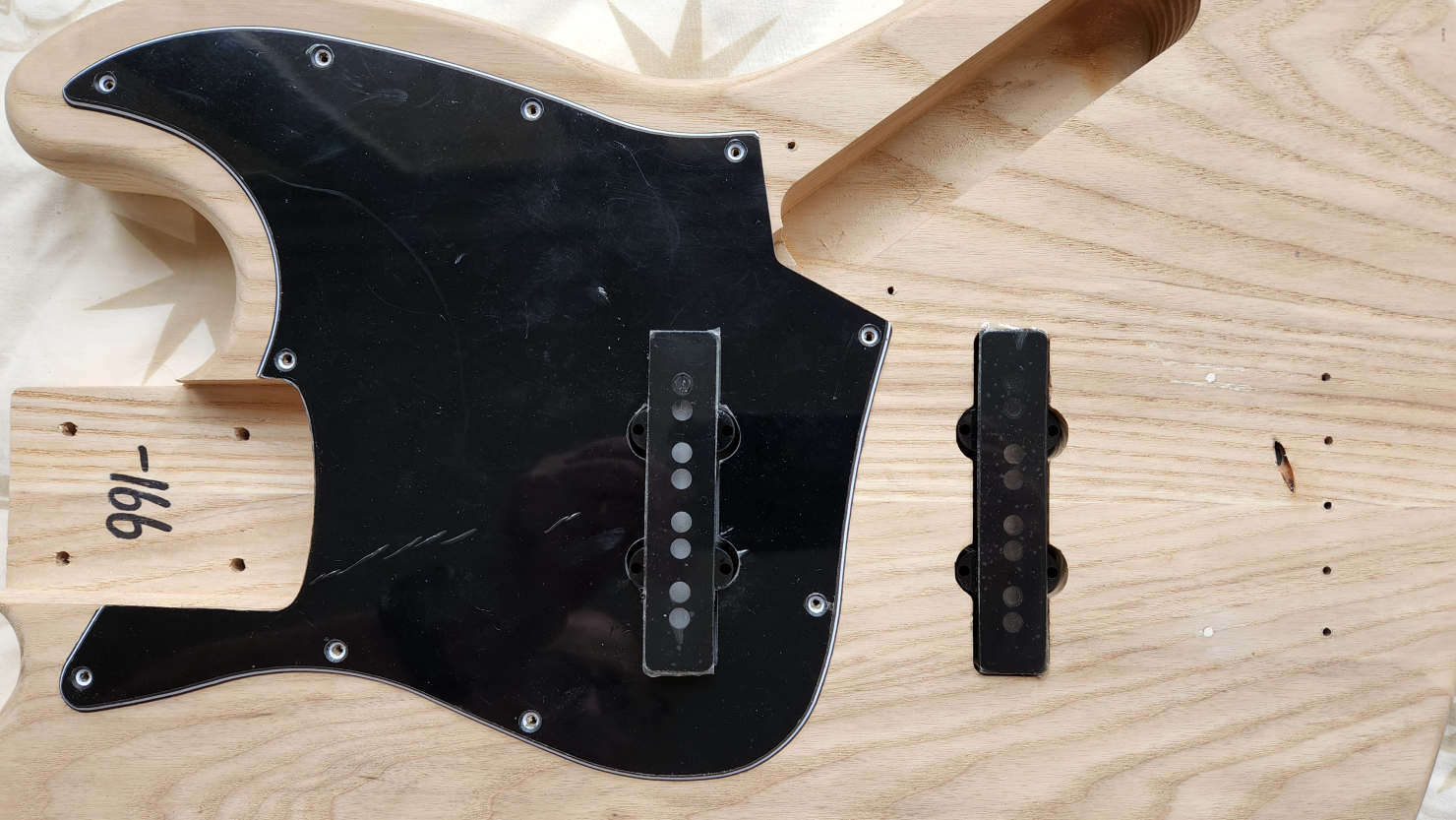

    Enlarged the pickup cavities and pickguard to fit Tonerider Pickups

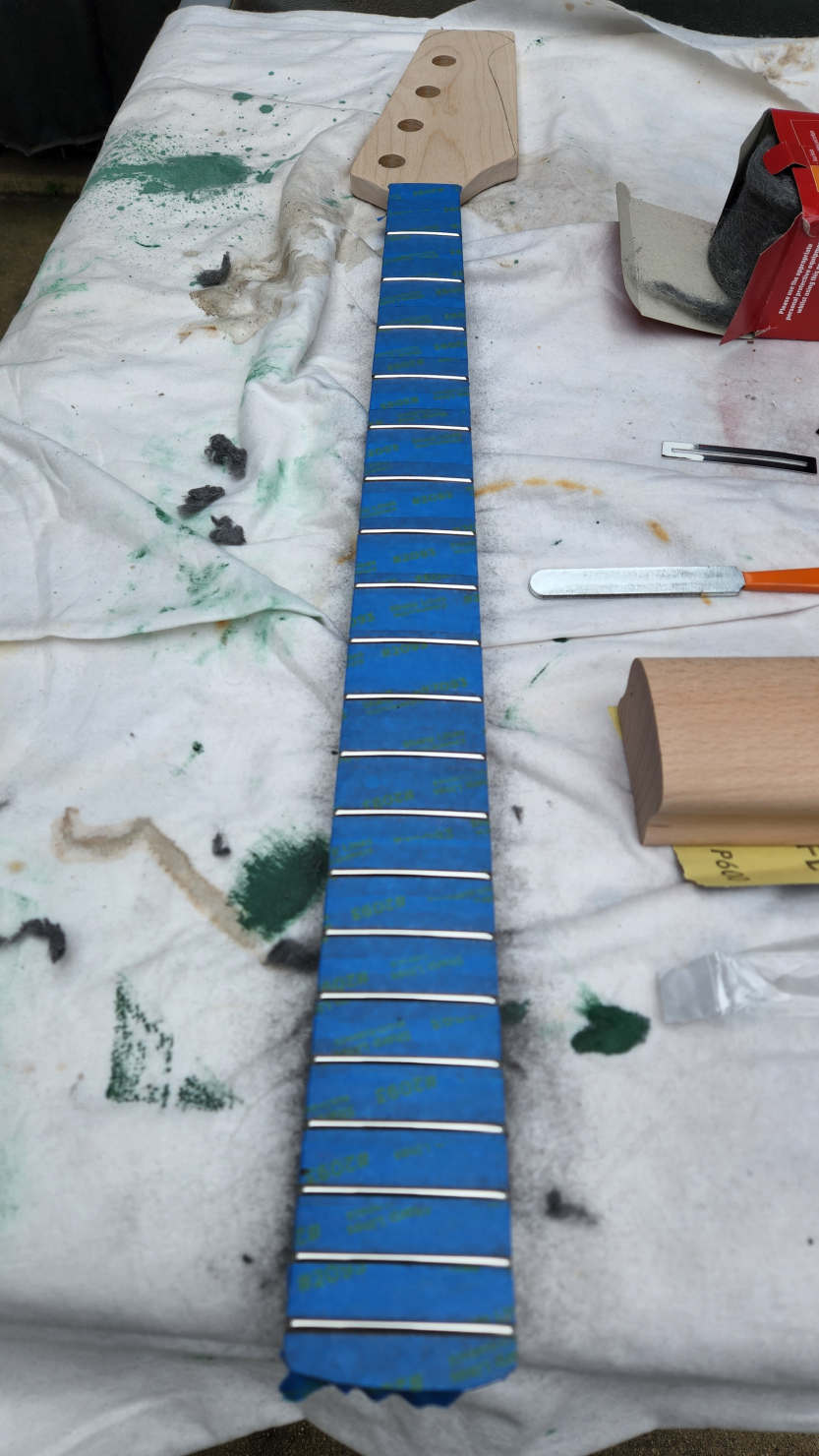

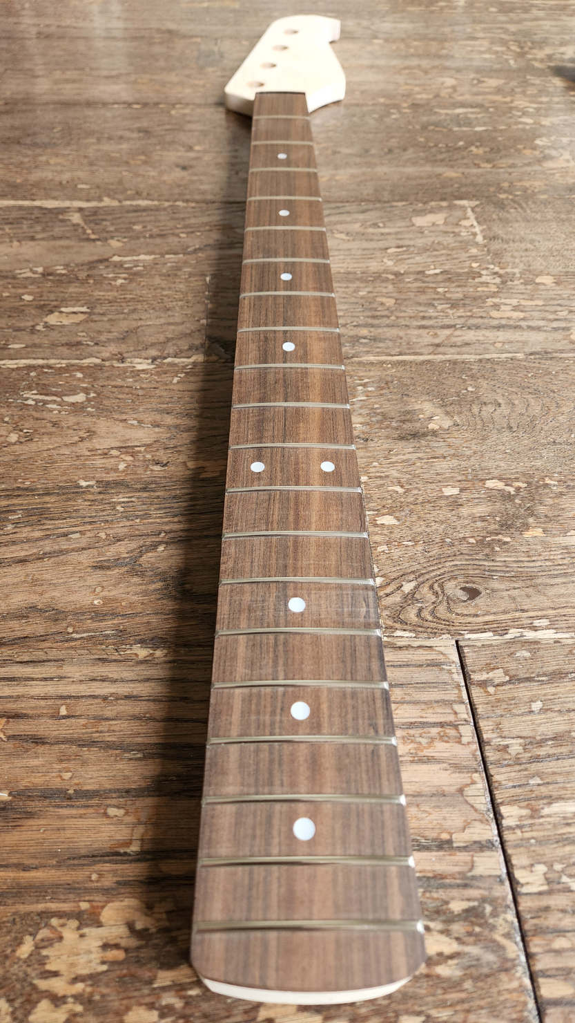

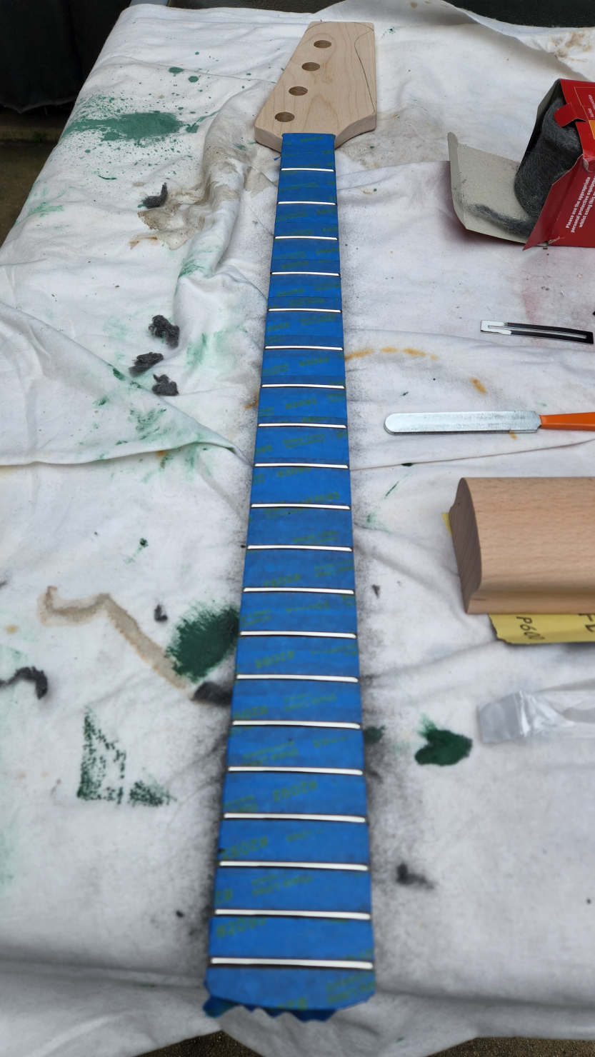

    Crowned the frets and removed the plastic nut
    Cut the headstock

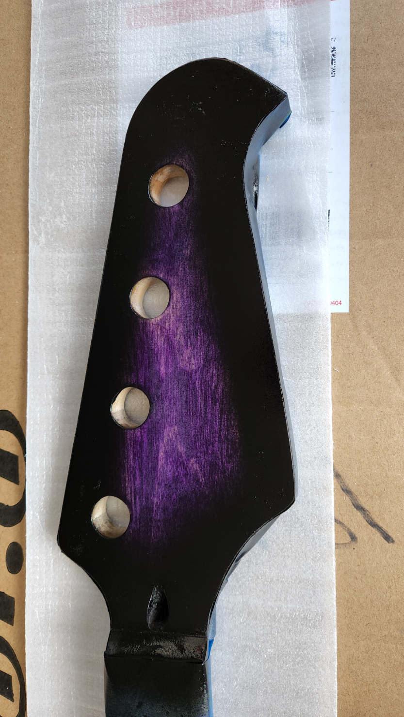

    Neck ready to finish
    Next step is to sand the neck and body, then start filling/dyeing/painting/staining/polishing.
    Nice to see a heastock design different from the usual P/J bass.

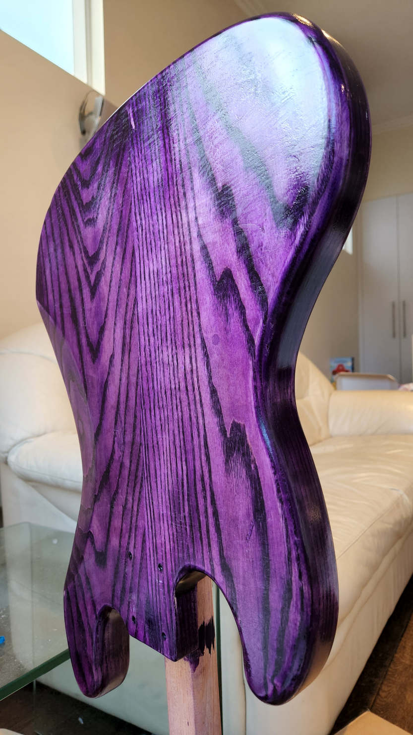

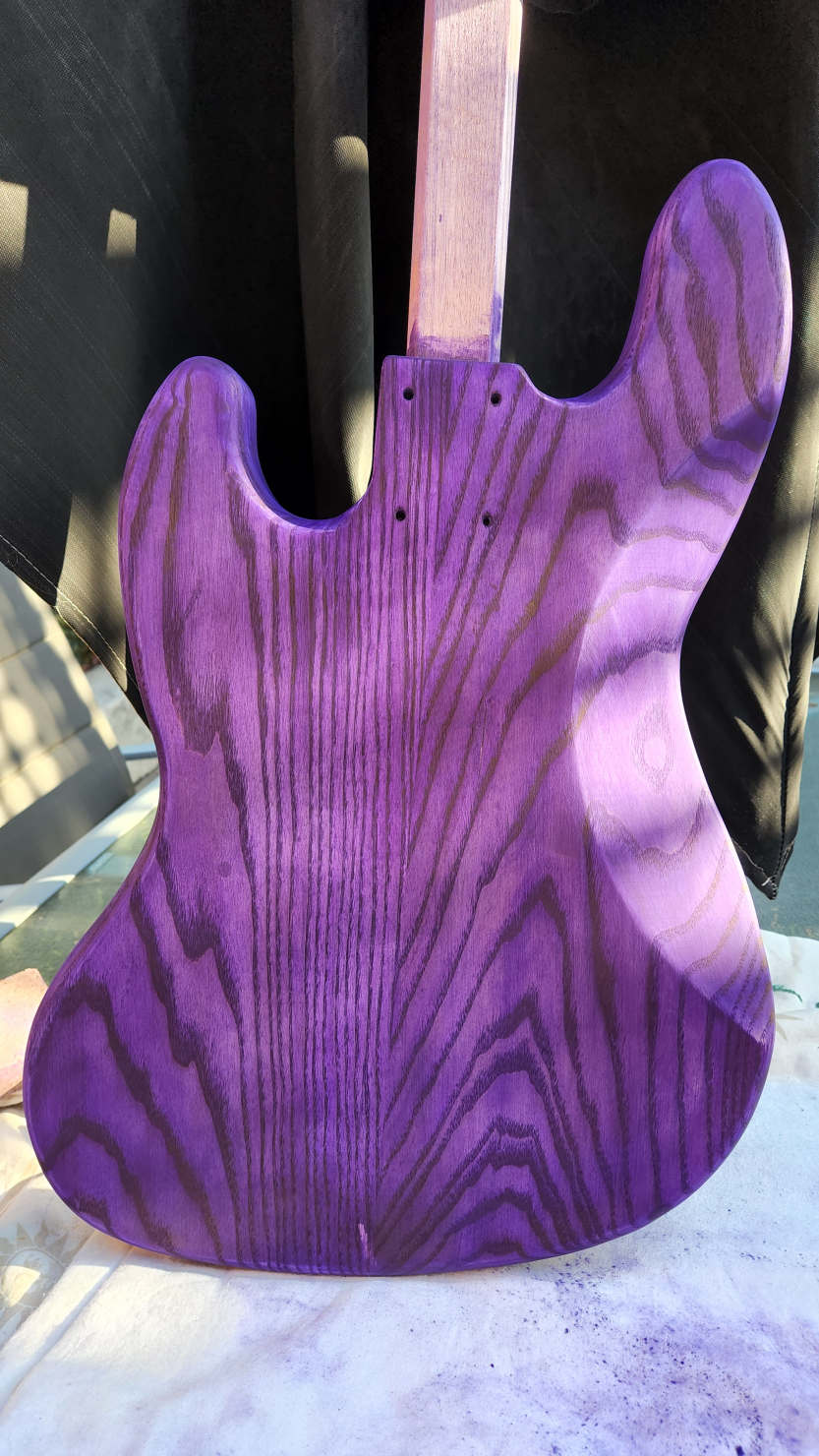

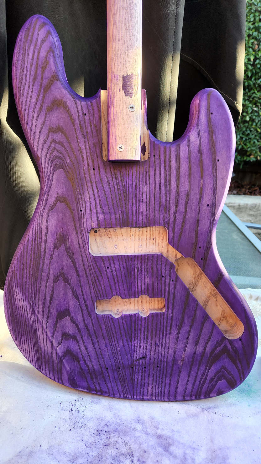

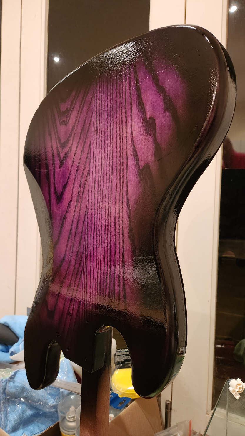

    This was my second attempt with the dye... The first attempt, I went over it with dye too many times and the dye turned a green/gold/metallic colour. So, I sanded it back, went over it again with one light coat of dye, sanded it lightly... It's better now, definitely the colour I was looking for, although a little patchy. I'm not game to sand further as it's already close to the bare timber in places. But I think it will look fine under a gloss finish and black burst edges.
