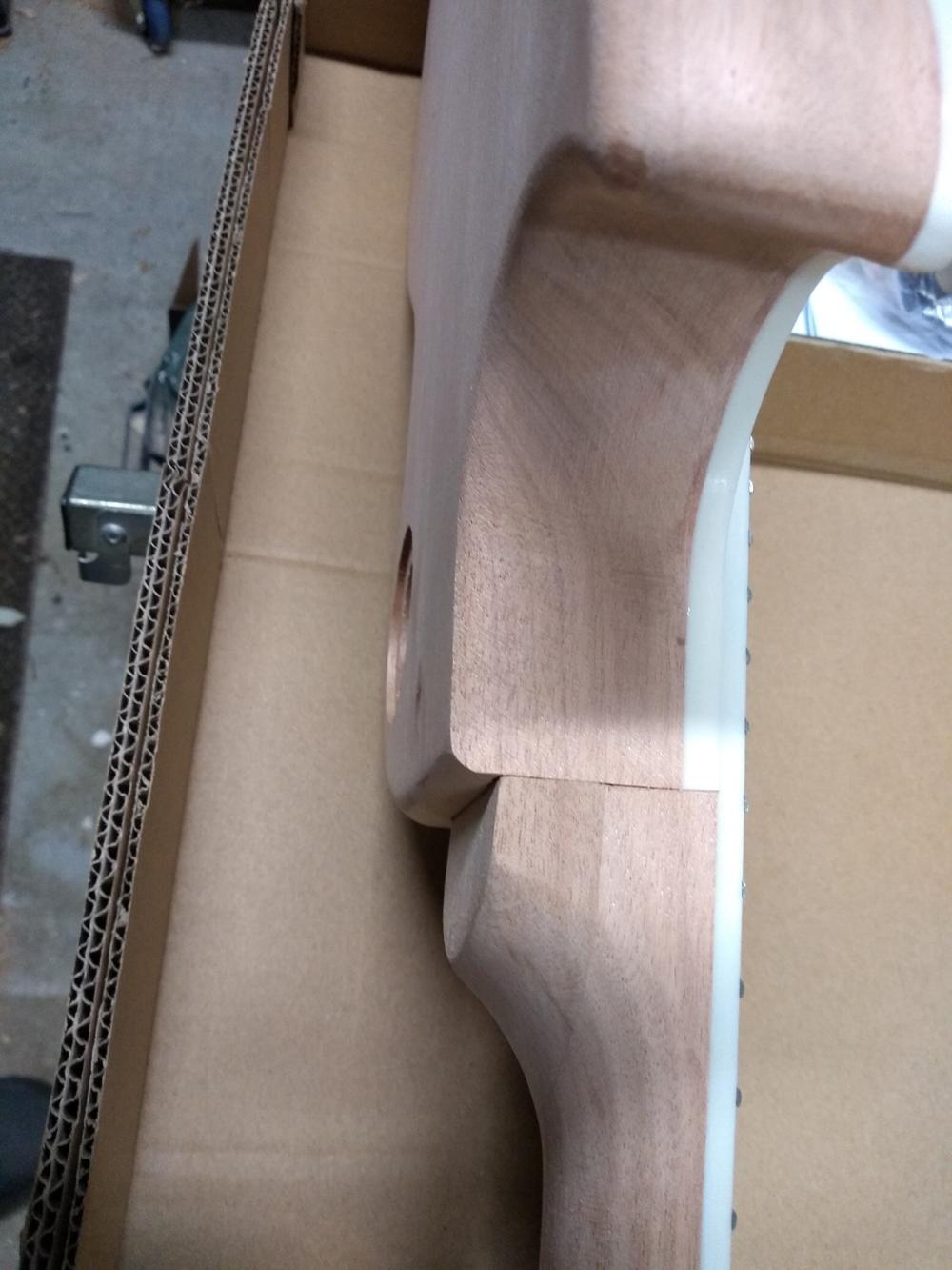

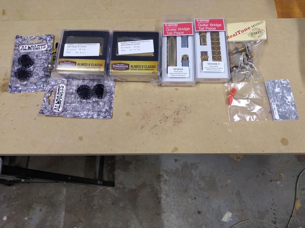

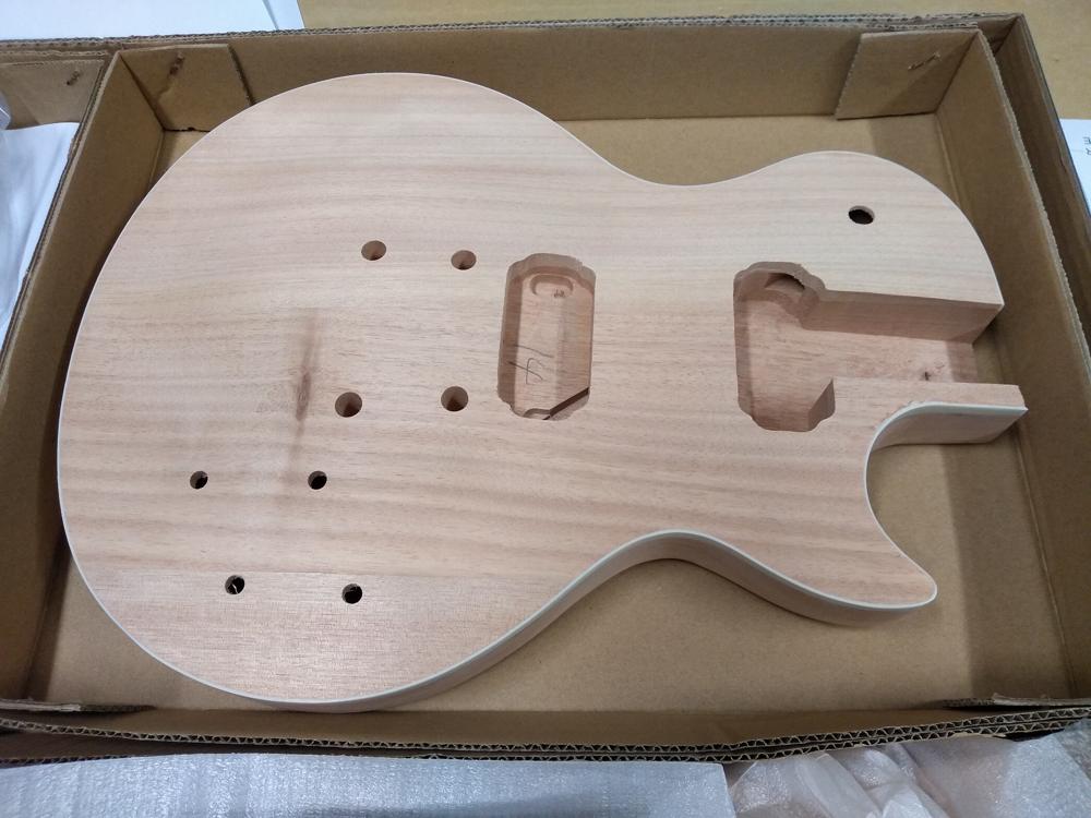

    Just got the SSCM-1E all mahogany kit with the view to make a black Les Paul Custom with gold hardware my version of the "Black Beauty". I even ordered the split diamond mother of pearl inlay from ebay. Significant upgrades seen in the photo below:
    Tonerider Gold AC2 pickups
    Gold Grover tuners
    Gotoh Gold tunomatic bridge and tail piece.
    CTS long neck pots
    Sprague caps
    US speed knobs for the CTS pots
    Will grain fill with Z poxy resin and undercoat with filler acrylic lacquer rattle cans. Colour coat with black acrylic rattle cans and clear coat with clear acrylic. All the rattle cans came from a local car paint retailer and have the wide spray nozzles that make spraying a bit easier.
    The body looks good the neck is a very good fit and the neck angle appears to very good for the future set up.

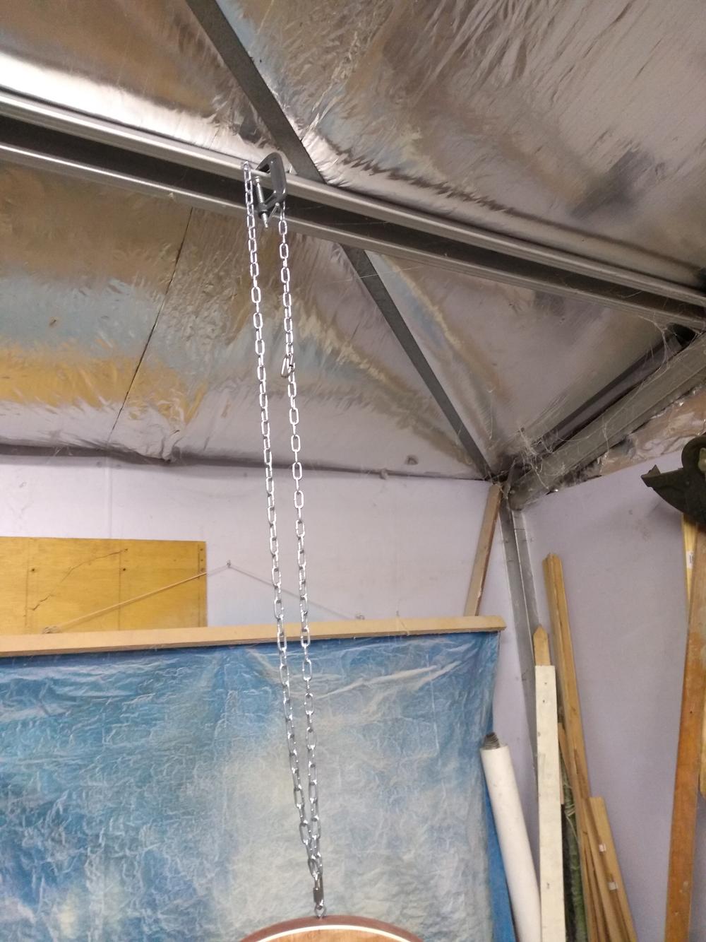

    Final sand of Z poxy and glue neck
    Sanded back the second coat of z poxy back to the wood and was impressed by how smooth and flat the guitar now is. Should help to make that shiny black finish sparkle like a piano. I was not going to glue the neck on yet but watched a video of how gibson paint and finish guitars and so I attempted to duplicate their hanging rig. Chain clamped on to the rafter of the shed connected to the guitar by a removable connector and a eye bolt. I think finishing the guitar with the neck glued on will allow for a better transition at the neck join which of course will be covered by layers of paint and clear coats. Thats the theory anyway.
