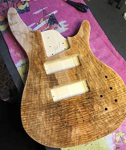

    Finally got around to start assembling my 6 string bass kit. Ordered in April, but of course delayed due to corona.
    Body and neck looks very good - the burl veneer is stunning - and fits together nicely.
Size:  51.3 KB Name:  IB-6S_2.png
    I have decided to upgrade some of the hardware right away and have fitted a Hipshot bridge, Aguilar DCB PU's and a Glockenklang preamp. (The pre amp is so small that I can fit the battery in the cavity, avoiding routing for a battery compartment)
    I have completed the mock-build and I am very satisfied with the result, - plays and sounds good.
    Only one concern: The neck is very thick, and I am seriously considering shaving 3-4mm of the backside to make it more playable. Any experiences doing something like that in the group? May require some tooling to avoid ruining the shape.

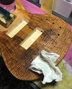

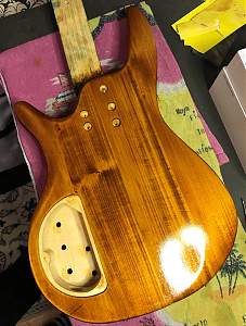

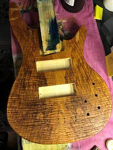

    I have been working on the finish for a while. Applied a warm oak stain to the front and a darker color on the sides and back. As it turned out there was some glue stains on the front that I thought was natural variations in the wood. I have decided that it is not worth the risk to try and sand it off.
ID:	38191Click image for larger version.
ID:	38192Click image for larger version.
    Sanded the back of the neck, but only reduced it by a few mm's.
    Now I am applying multiple coats of true oil.. Stay tuned.

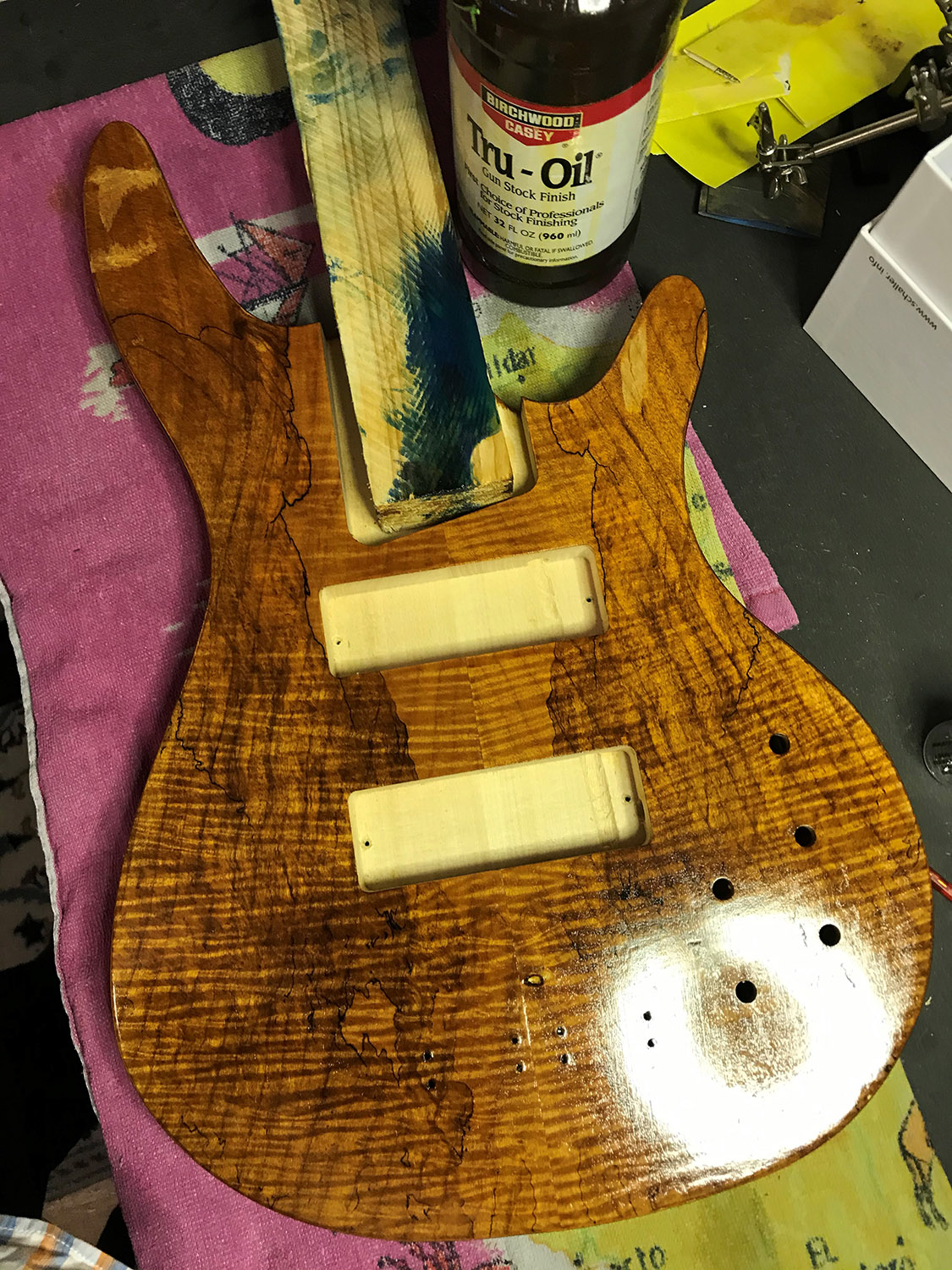

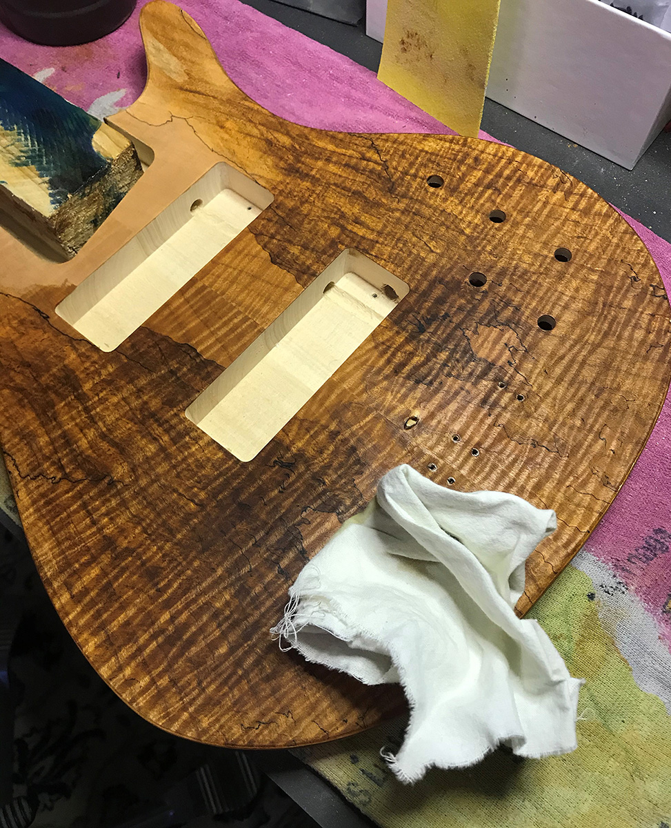

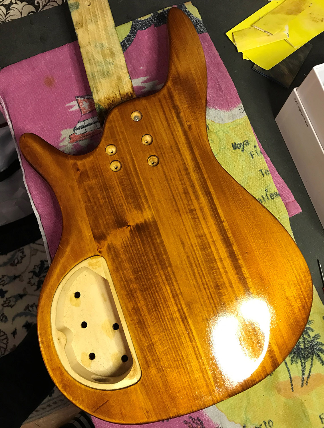

    Here is a few pics with the front and back after 6-8 layers of oil
ID:	38194Click image for larger version.
