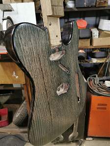

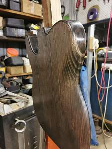

    I've painted this body so many times now I'm not even gonna talk about it any more. If you see the body look slightly different in future pictures just assume I've been at it again.

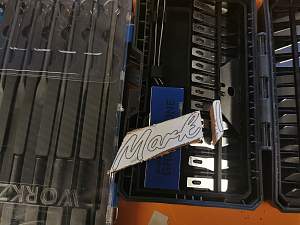

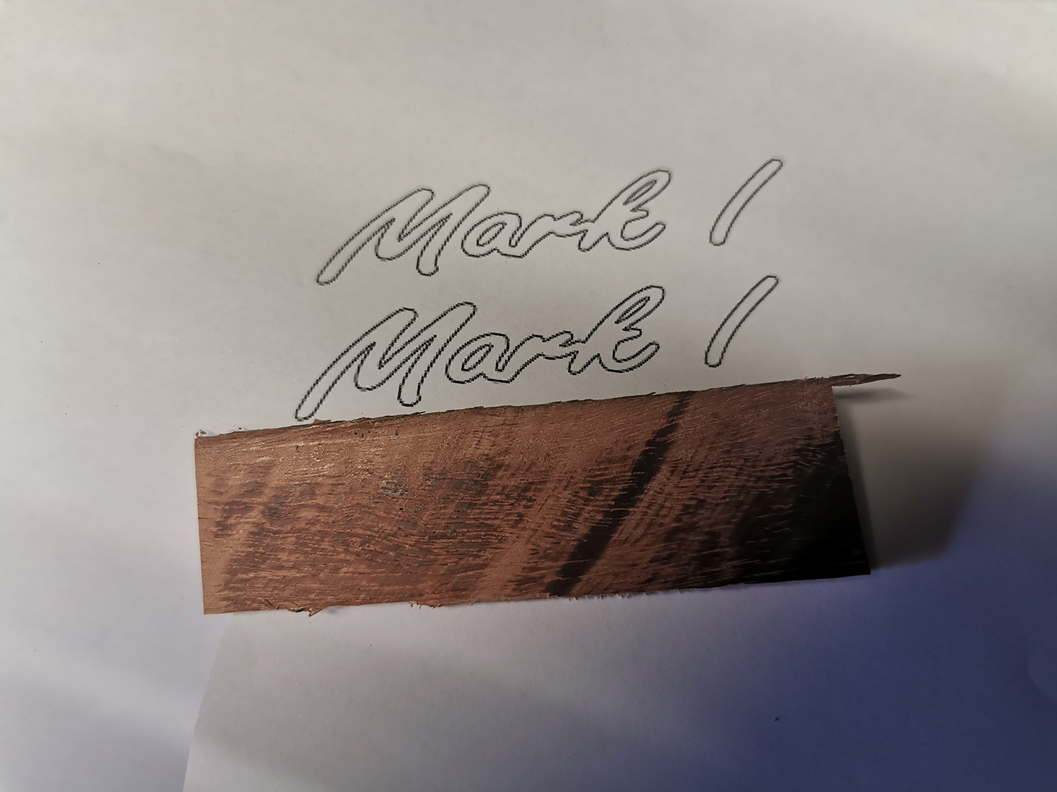

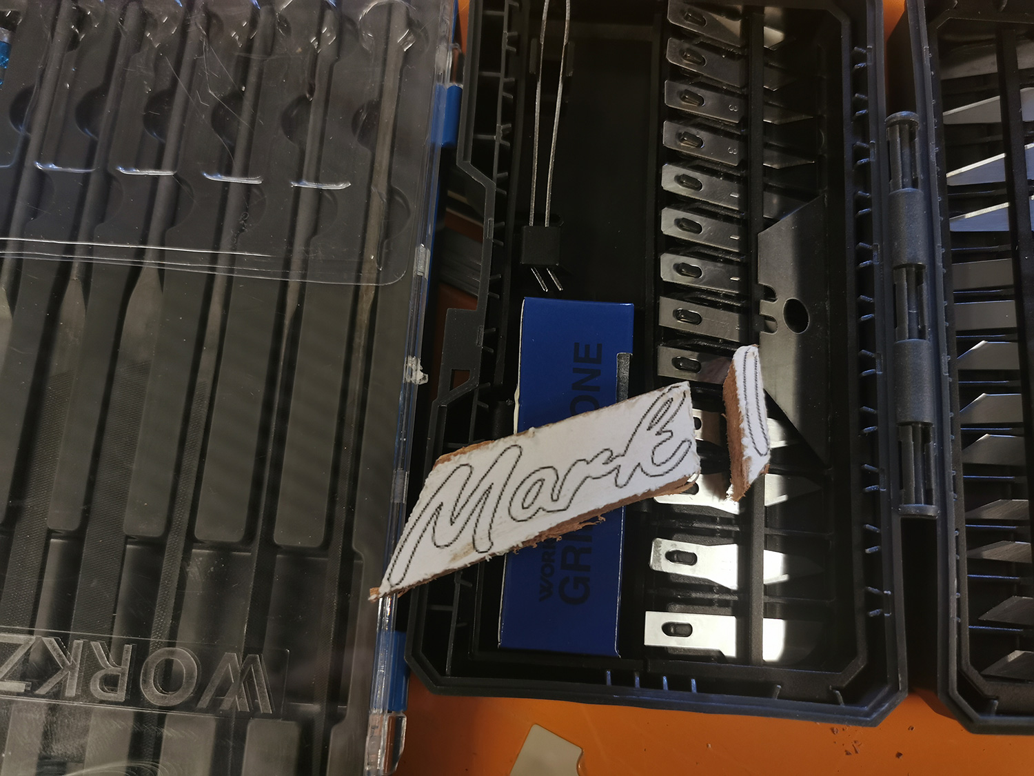

    I've decided since I'm apparently terrible at planning my work before I start, but great at biting off more than I can chew, that I should do my first ever inlay. I'm considering using jarrah as it will provide a really good contrast, and jarrah wood filler will be a good way to hide the inevitable sins.
    I'm planning to give this guitar to my best friend for his wedding or as my Best Man gift to him at his bucks. It depends on when(if) I ever finish it. His name is Mark, and this is my first build, so this will be the Mark I.
    On top of that, continuing this apparent anti-powertool bias I have, I'm going to attempt it by hand. I thought I might be able to make some inroads with scalpels and needle files, but that's lunacy. They will definitely come into play for final shaping and finessing though.
    The missus is heading down to the big smoke today and I was hoping she could stop past toolmart to grab a fret saw and some blades, but they don't have any in stock. I'll likely stop past Carbatec on my way to work Monday and grab one. Until then any inlay work is on hold. Gives me time to make an inlay work stand/frame anyway.

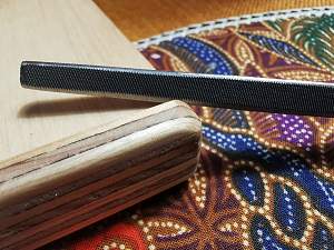

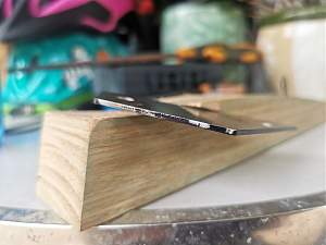

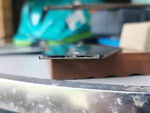

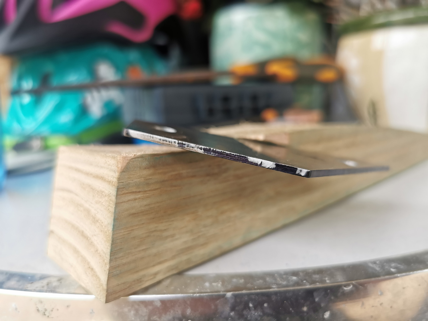

    In other news, my Homeland fret rocker turned up in the post. Unfortunately it lives up to its name and literally rocks on a flat surface. I tested out on my LP that has some string buzz and was like "Damn, I got some BAD upper frets". But it turns out the smallest straight edge on the fret rocker has a slight curve and rocks on literally everything. I'll attempt to fix it using my leveling beam, but yeah. I hate that you can't trust anything you buy these days.

    I blacked up the edge of the fret rocker with a sharpie and took it to the waterstones.
    Engineered flat me arse.
    A couple of minutes later and it's flat enough that it's no longer rocking against a straight edge. Still not perfect, but it's definitely good enough.

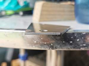

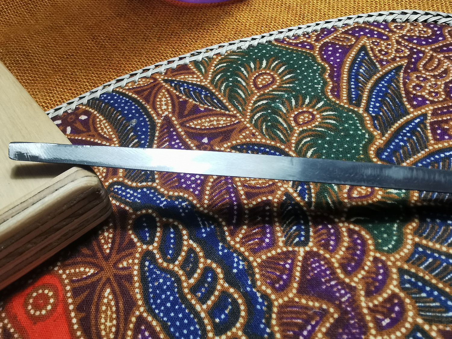

    I did the same for the other edges, even though they didn't seem to be problematic, aaaand I'm super glad I did.
    And since I was out here flattening things, I decided to grab the cheap crappy "luthier" files I bought off amazon and turn them into something resembling actual crowning files. I flattened one side completely on the bench grinders. Firstly on a regular stone, then over to a tool sharpening stone to help smooth the surface. I took it back to the sharpening stone after this photo to clean it up some more, then ran it over the waterstones.

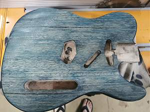

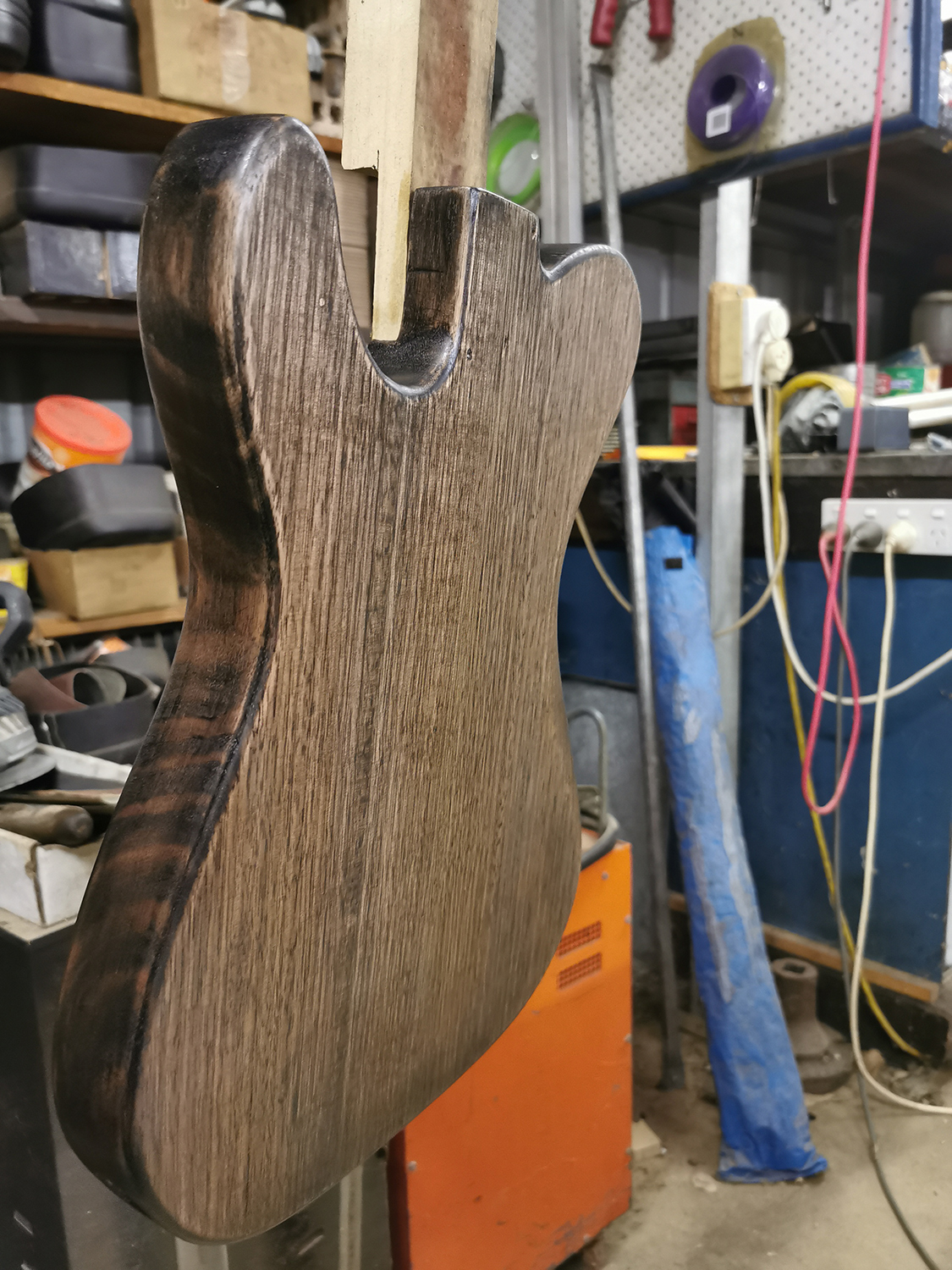

    I've discovered that if you search for perfection, all you find is problems. If you search for adequate, all you find is still problems. However, if you get sick enough of something you eventually just say "screw it" and and start applying finish.
    The direction I've gone with would probably be considered shabby chic, or weathered beach house. Or flotsam, perhaps.
    Anyway, more paint, more sanding, more mineral spirits, more sanding, more problems uncovered, more serious sanding, more paint, more mineral spirits, more sanding. And then say "I can't get it better than this without going insane" and start applying wipe on poly.
    I'm thinking 2 coats a day for a couple of days, then light sanding, then 2 coats a day for a couple more days, then leave it to cure for a few weeks before wet sanding, buffing, and polishing.
    Or I'll just do a bunch of coats and then steel wool it and say good enough.
    We'll see where the muse takes me.
    EDIT: I should mention that self-deprecation aside, I've gotten pretty much the result I had in mind when I started. I want this guitar to look weathered and worn.
