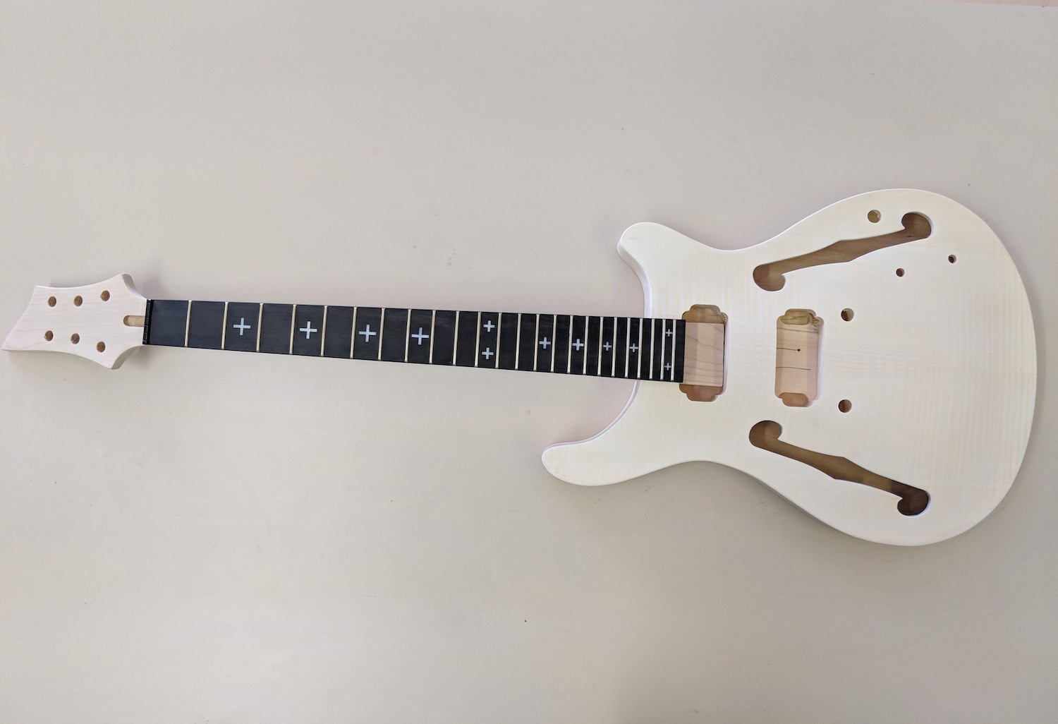

    So my plan for this is to go the Nullarbor Ochre DT as I love the colour of that finish. There are a few PRS semi hollows that have similar colour too. I will use this on the front, back, sides and front of the headstock. Leave the bindings exposed as accents and a natural finish on the neck using neck top coat. Will also paint inside the f holes black to give some depth and match the pup mounts and nut. Might also hide some wiring if I use black wires to connect everything.
    I was tempted to ebony timbermate to pop the flame veneer, but unsure how it would react with that particular colour of the DT. Would have been a nice touch to have used it as a grain filler too as it would fill a few tiny scratches and some pinholes in the veneer. I'm on the fence on the timbermate.
    Another option is to use ink, but again I don't know if it would even pop the flame under that Ochre finish.
    Any thoughts? Or anyone done anything similar with DT Nullarbor Ochre?
    Cheers!
    P.S. here's the DT sample pic...
    Sent from my Pixel 2 using Tapatalk
    The veneers are just so thin that any sanding is too much of a risk, likewise playing around with water based inks too as that can sometimes rehydrate glue holding veneer on thus introducing unwanted problems.
    On one flame maple top build I used ink and applied a first coat and immediately tried to wipe off or soak up as much as possible, left to dry overnight to a full day. This helped to fill the natural grain with colour so that when next coat was added grain popping was in the same colour tone.

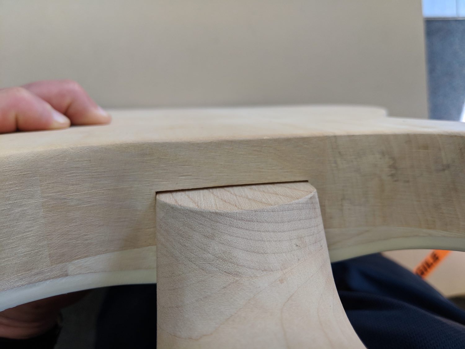

    Time for a little update..
    Sanding complete to 240 grit. Glue spots removed with Goof Off and an old toothbrush.
    Major imperfections filled with Maple plastic glue, kept to a minimum and sanded smooth. I know these areas may take the stain differently.
    I'm going to have to live with the "machine marks" on the front of the veneer as I can't sand them any further at risk of heading below sea level. I have sanded ever so slightly what I can and need to leave it at that. Hopefully the DT will fill some defecits here...
    Next stage is to confirm neck angle and scale length and mark the neck for correct fitment. Then do a final wipe down with Gum Turps before stain commences.
    Found a nice little ding in the fretboard, so I will try wet rag and soldering iron trick to hopefully bring that back out.
    There is also a pinhole in one of the frets, unsure in how to deal with this yet.
