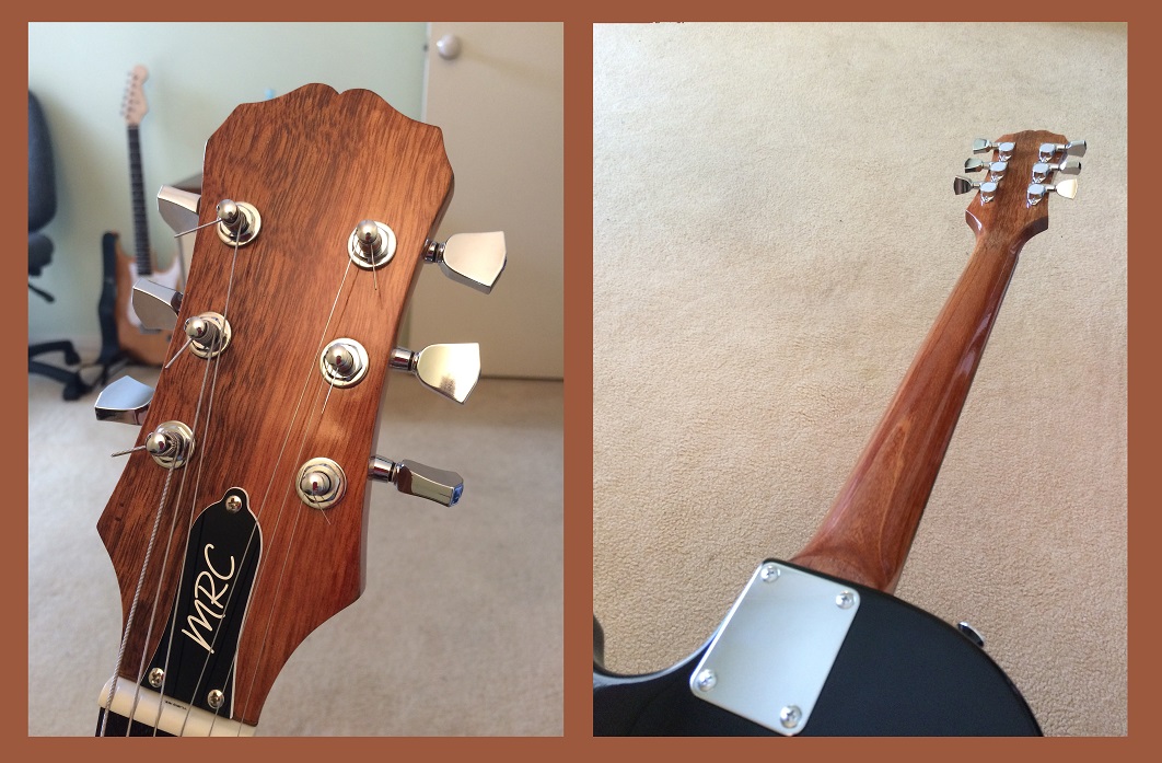

    Here's mahogany neck I did with just Tru Oil:
Name:	Mahog TOil 2.jpg
    I know the colour in mahogany can vary quite a bit, but I love the colour on this one.
    I do like the feel of Tru Oil on a neck, but I've since come to like satin poly more. If I were doing it now, I think I might do a few coats of Tru Oil then do a satin poly over it. Maybe that's an option for you also.
    edit:
    BTW, I'm suffering major envy over that blue quilt! Noice!!!
