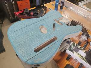

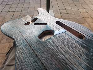

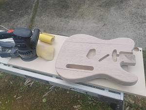

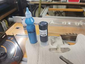

    Well, I have a new job I hate doing.
    The wax had to come off before approaching it with sandpaper. This would have been slightly easier if I knew what box I'd packed my cabinet scraper in, but in the end it worked well enough. I got as much wax removed as I could before hitting the body with the random orbital sander.
    After that was loads of hand sanding up to around 220. I tried metho scrubbing, but the tiny amounts of wax in the grain won't budge. There's so little of it there I don't think it will make a difference.
    After that it's back to the kids craft box for the IKEA paints.
    I've got the blue down, when it's dry some time tomorrow I'm going to slightly water down some black and see if I can do a burst effect by hand. It might work, it might not. If it doesn't I'll attempt a black wash intead to see how it goes.
