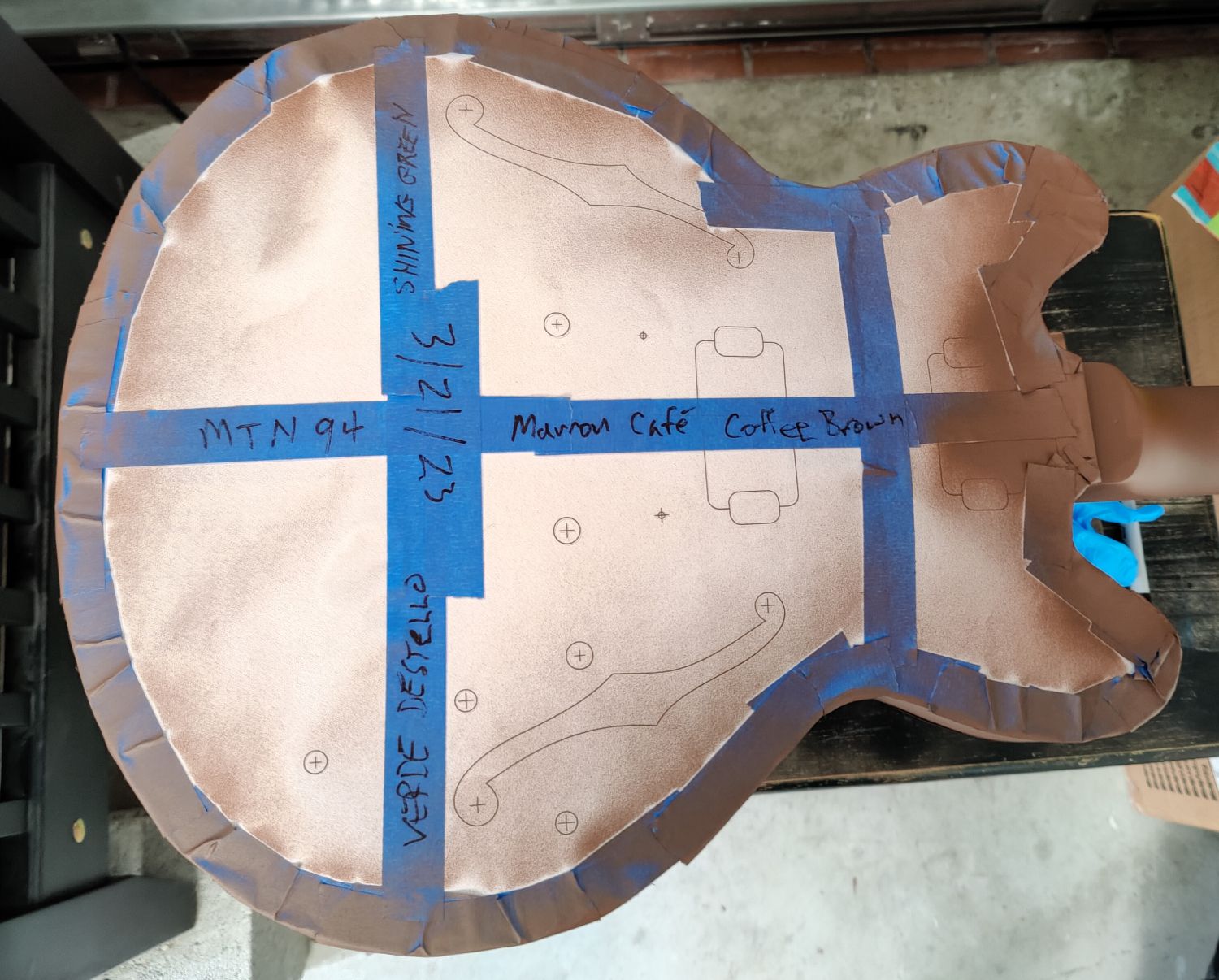

    If you use a battery box, I think they generally come with a lip so they can mount without being recessed. That's how mine was, in any case.
    I like the green and the yellow. Red is cool, but I had to do a lot of experiments before I got it to look good. I am no expert, however.
    Thank you. There are couple of varieties available. Ones that can be mounted flat in back and other ones from sides. I have ordered a couple. The kit has just gone to the customs. Hope fully should be in my hand by next week to take a call.
    I am getting a few other dyes to experiment. Will have to zero in on them soon

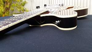

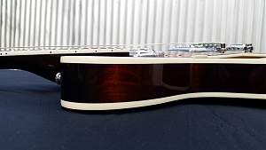

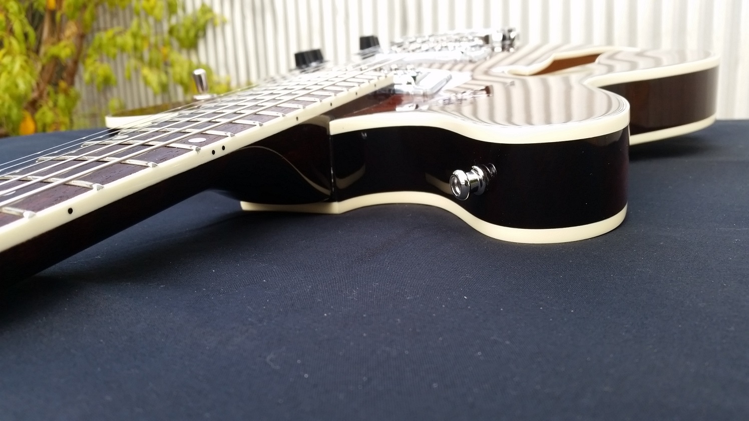

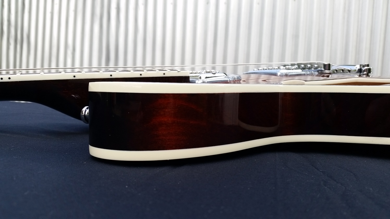

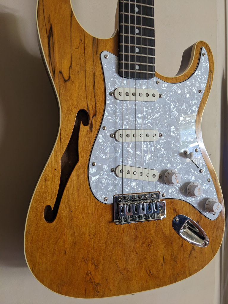

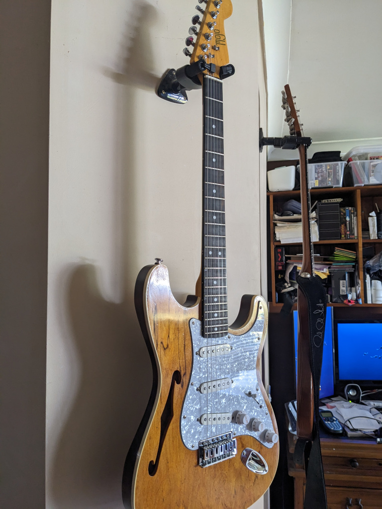

    Welcome Drashkum, the neck fit has been asked about before and have these pics of my finished FS.
Name:	FS neck set 1.jpg
ID:	44151Click image for larger version.
Name:	FS neck set 2.jpg
    Yours looks as it should. The 'bump' on the high e side of the neck heel can be flattened with a medium to smooth file if needed.
    As you are planning on staining, remember to not put stain or top coat finish on the neck heel or pocket where they are glued together.
    There is a build diary somewhere.
    https://www.buildyourownguitar.com.a...ead.php?t=7401
