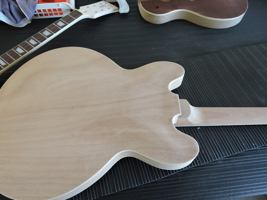

    During the last Anniversary sale scored an ES1 with mahogany body and neck and flame veneer front and no F Holes.
    As a massive fan of the Customised Framus guitars that Devin Townsend plays ( and that at 8000 euro are a little out of my price range) thought might have a crack at a "homage".
ID:	11290   Click image for larger version.
ID:	11291   Click image for larger version.
    Tony

    Strange question but how do you get the electronics in the body?
    Mentor vh2580's Avatar
    Cleveland Qld
    1,184
    Hi fuzz beard will have to cut the z's out before putting in inserts. And will have a battery box in the side below where the rear strap pin is located. Should give enough room to fit everything in.
