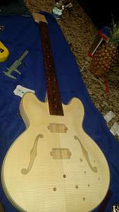

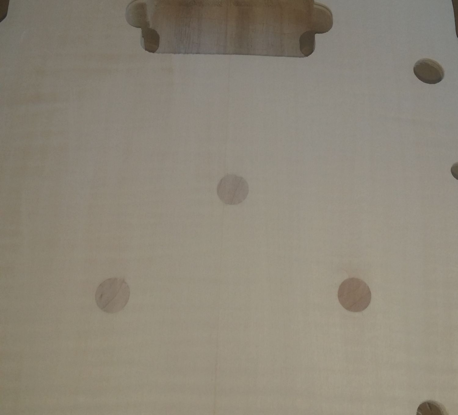

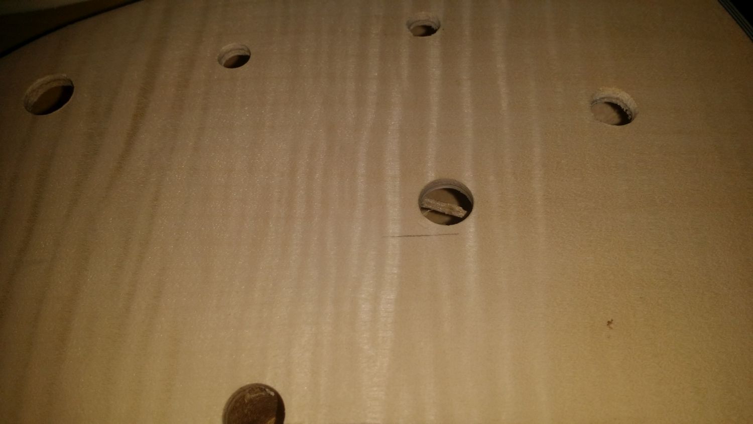

    I am having my first serious "oh sh*t" moment with the build and I am not yet really even out of the box yet....
    I was doing one last measure before gluing the neck on. Whenever I have done measurements before I was standing on the "south side" of the bass. This time I was on the "north" just by coincidence...

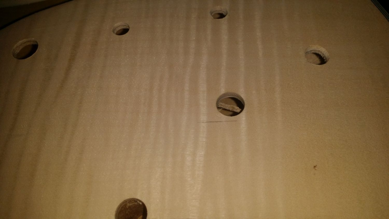

    ...from this side I noticed a problem in the south (lower) of the three mounting holes for the bridge. There was no wood on the south side! I was looking right into the body cavity.

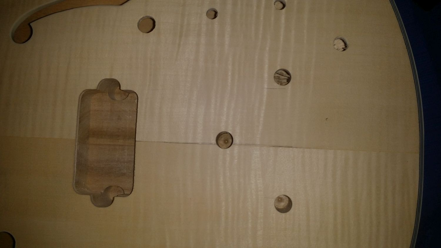

    At first I thought the factory had not put the center block in properly, but on closer examination, I realized that they put the holes for the bridge about 2.5 mm too far to the south. I put a pencil line on the center line so you can see clearly...
    That was enough off so that when they drilled the south bridge hole, it broke through the side. So, not only is the bridge about 2.5mm off center, the south ferrule doesn't have enough wood to bite into when I mount it.
    Never noticed this before. I suspect it came off the line late on a day when the guys at the factory began drinking a little early.
    So what do I do about this? The only thing I can think of is that I will need to put a 7/16 (~11mm) dowel into the holes, and re-drill with a drill press. I have a drill press. I think I have used it twice...so this will tax my ability to use tools and be precise.
    Assuming I do it right, most of the "scar" will be covered by the bridge--which is good since I don't think I am likely to find book matched maple flame top dowels. Before I do something this invasive, though, I thought I'd put it to you guys to see if there are any simpler alternatives I have not thought of?
    Any thoughts will be much appreciated...
