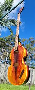

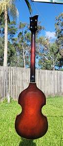

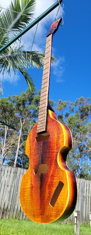

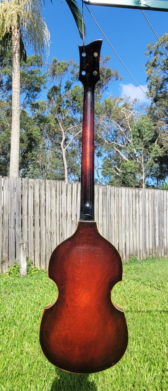

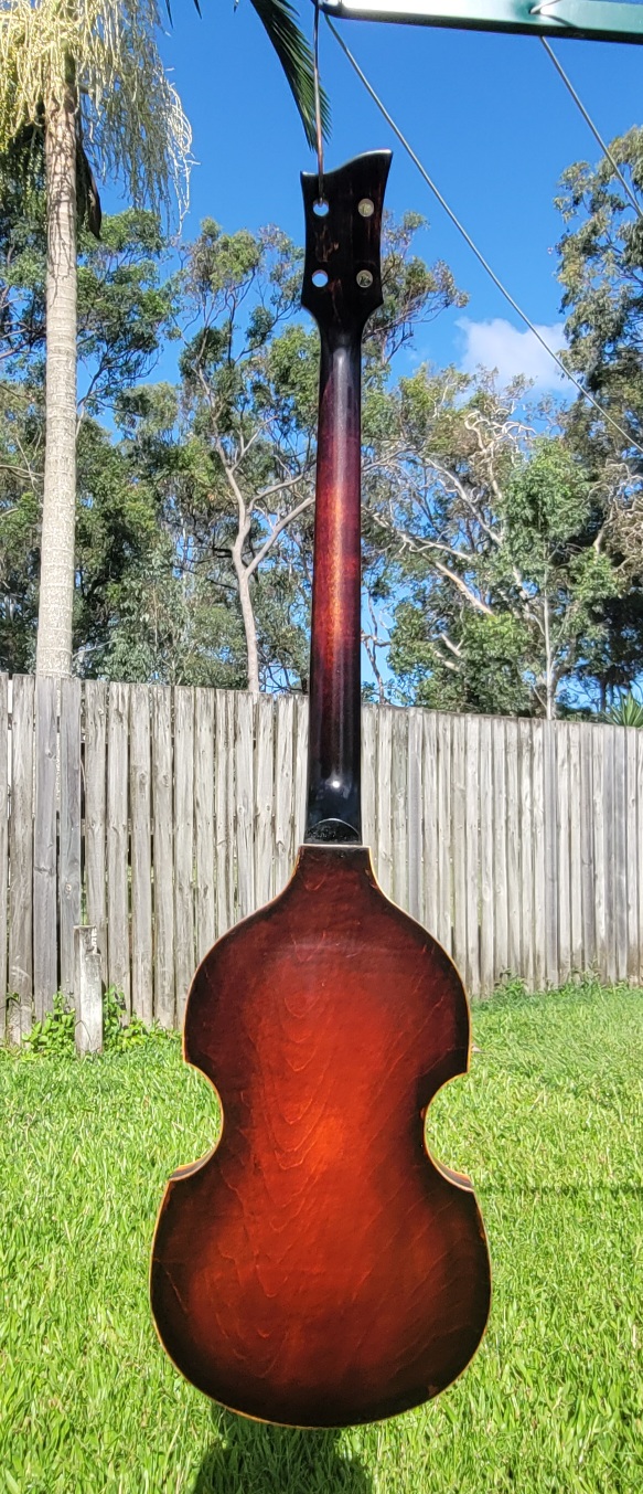

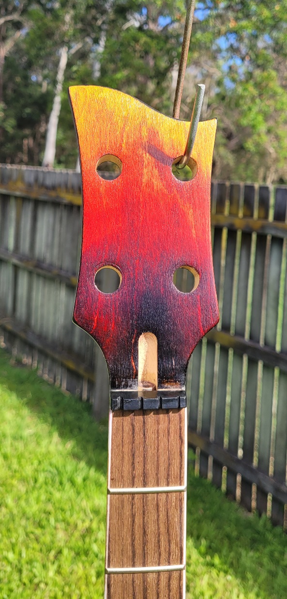

    Thanks for all the suggestions guys it's great.
    Brief update.
    Neck stained and set in.
    Couple coats of tru oil applied.Click image for larger version.
ID:	42890Click image for larger version.
ID:	42891Click image for larger version.
