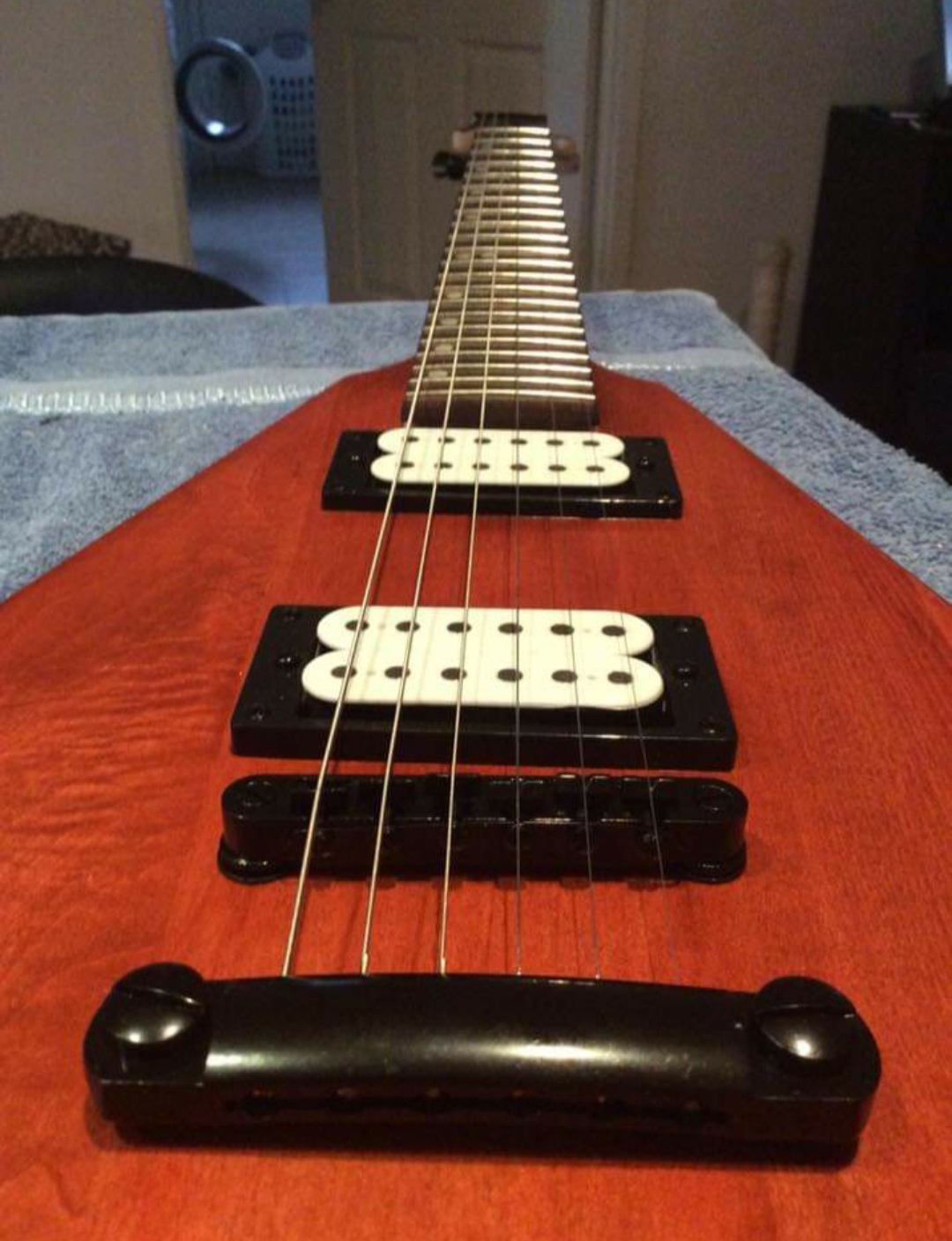

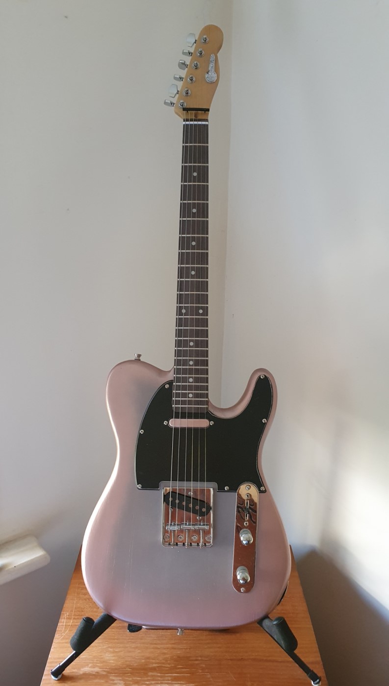

    I built my first Pit Bull kit about 5 years ago.
    I have racked up double figures now so thought I would show some of the guitars that I have put together over that time.
    Armed with only an orbital sander and YouTube the first kit was a Jackson style V.
    The action was terrible, intonation was dire, finish was blotchy at best. The thing was almost completely unplayable.
    My brother still has it I think??

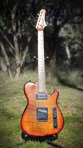

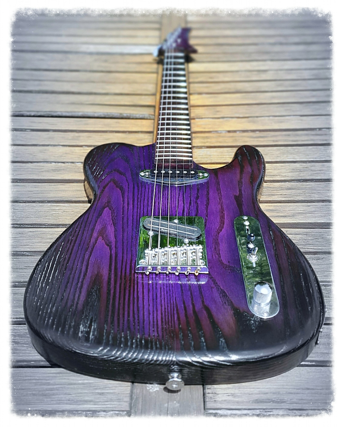

    Build 2....

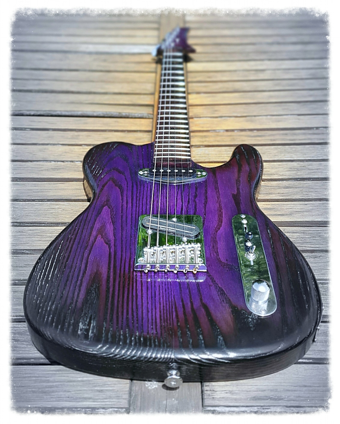

    To usher in my 50th year on the planet I decided to do it properly and build a really nice tele.
    This is my DTL-1
    2 piece American Ash body and Maple neck with Maple Fretboard (Dyed).
    Grover Chrome 406C Tuners
    Seymour Duncan rail in the bridge fender strat neck pickup.
    Wiring is a single volume, 3 way and a mini toggle for the SD North/HB/South.
    Finish is Crimson stain, some fire and lots of TRU-OIL

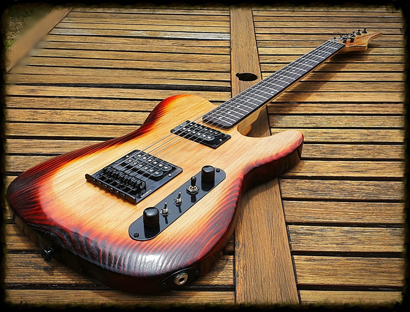

    Build 3.....

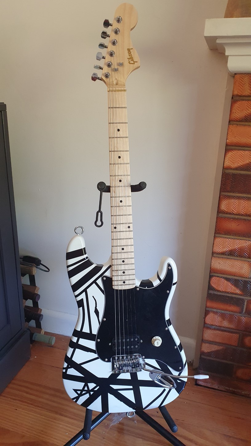

    Not so much a kit but a collection of Pit Bull bits and pieces.
    This is a Tele body and a maple neck matched up to an SG upgrade kit.
    Finish is Black and yellow dye and Nitro.
    I had a lot of fun with this and it plays great.

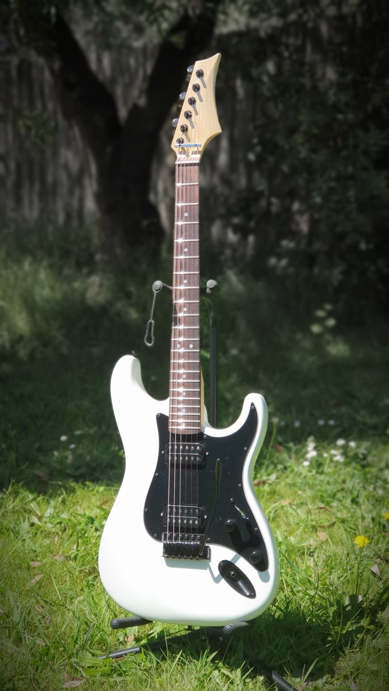

    Super Strat. This was my first solid color and first trem build.
    Alder body with rosewood/maple neck.
    Grover Black 406C tuners
    BABICZ FCH Z SERIES 6 HOLE TREMOLO
    TONERIDER OCTANE pickups
    Finish is Duplicolr Arctic White
    Each pickup has a mini toggle for Coil split and Phase

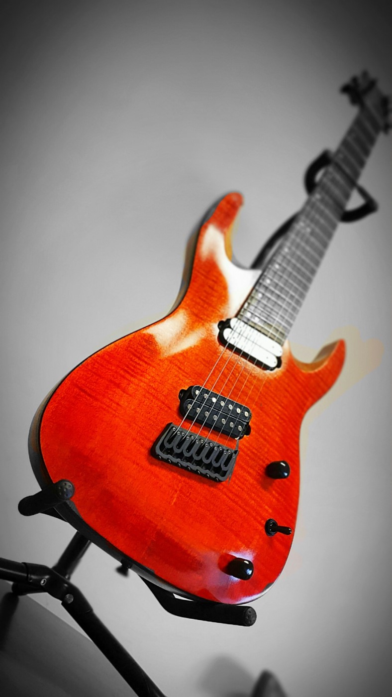

    Build 5.......

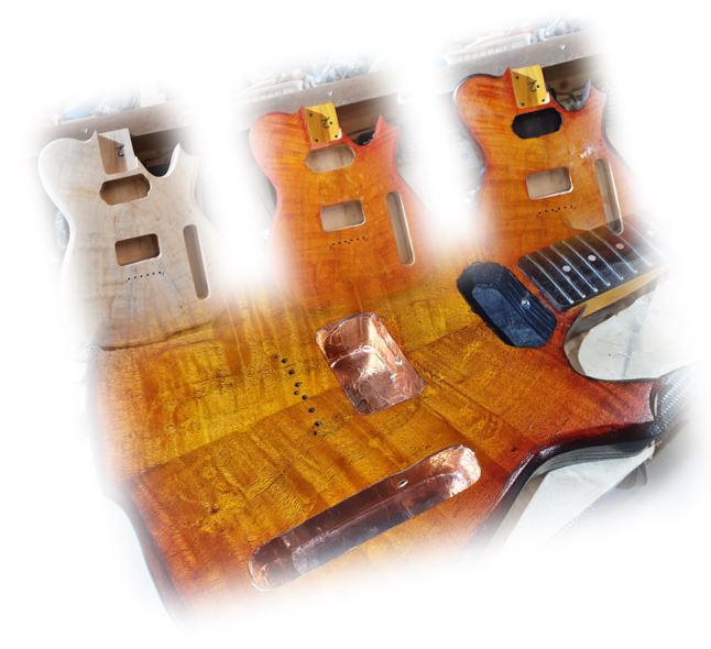

    Multiscale 7 string. (I got one one before they disappeared).
    A year after the Purple Tele my wife bought me this for my birthday. More confidant and better stocked with tools i set about making my first 7. Everything is out of the box on this except the truss rod and control cavity covers which i made myself to match the veneer.
    Crimson stunning stain and Tru-oil polish to a high gloss.

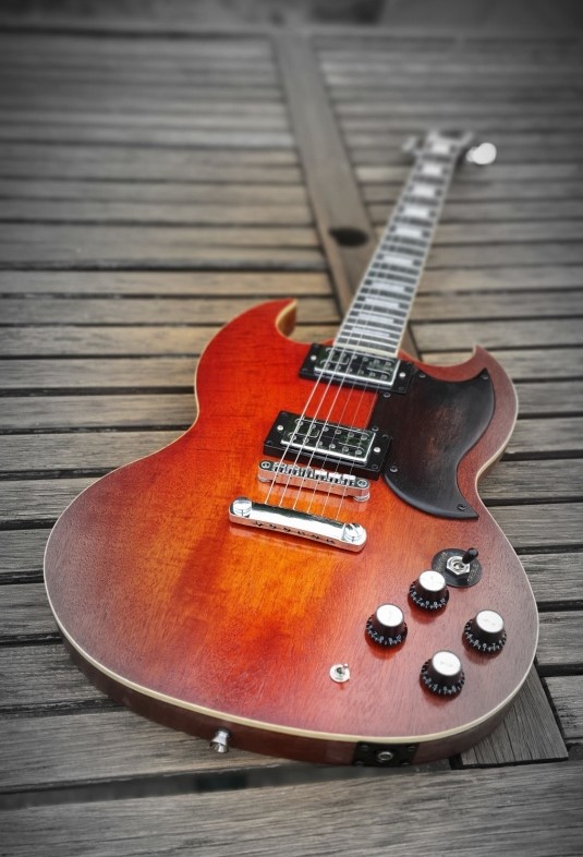

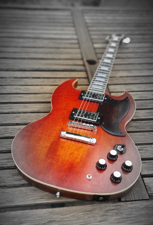

    Build 5 & 6......
    Ooooops. this is when i discovered the seconds and return page.
    I ordered a interesting looking SG with binding and a Mockingbird. Neither would i ever pick up in a store but hey they were both unique.
    The SG had a great flame area on the mahogany body. Light weight and finished with a light burst. Pickups are a pair of Epiphone Humbuckers and I have upgraded the bridge.
    The pick guard is a custom made piece of mahogany.

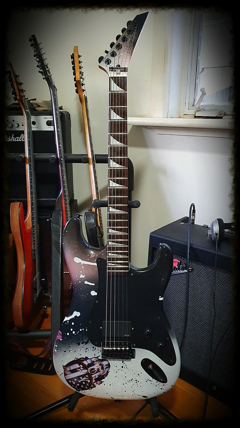

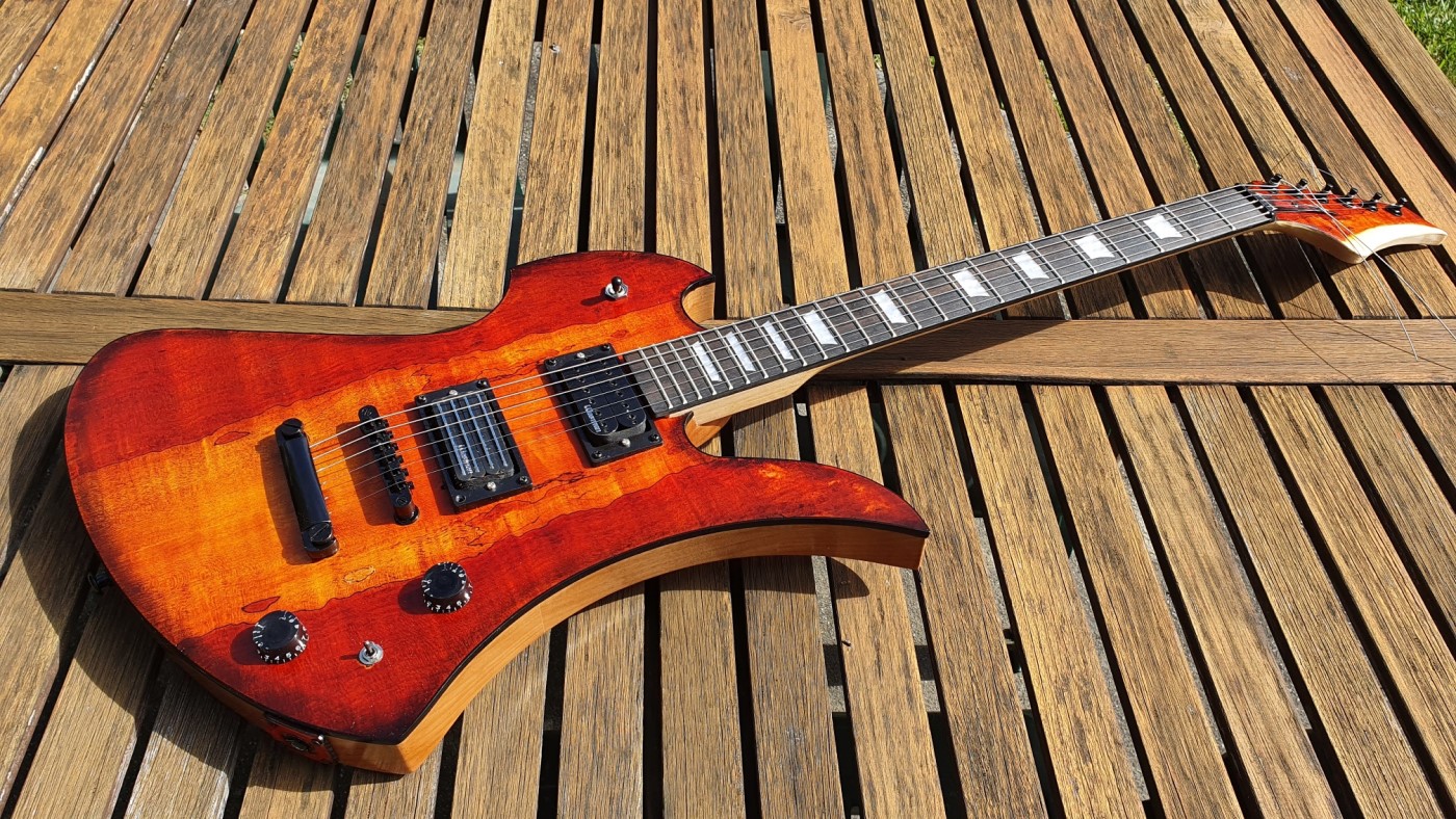

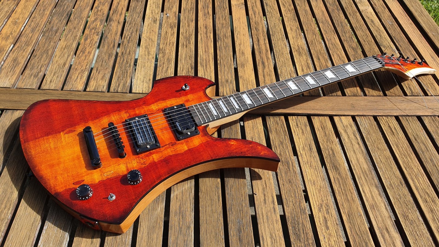

    My second purchase was this crazy Mockingbird with a 24 fret neck, inline tuner setup instead on the traditional 3+3. This is fitted with a set of seymour duncan SH1/SH4. I have fitted an .056 top string and moved the standard E and A down a position.
    Drop B tuning and rowdy as they come.
    I picked up a Guitar of the Month with this build.

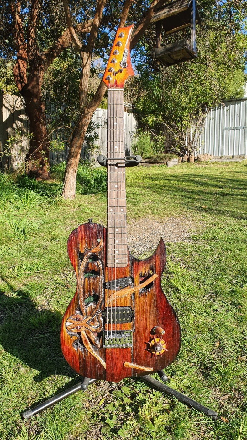

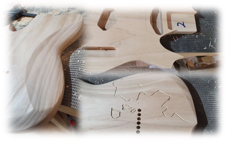

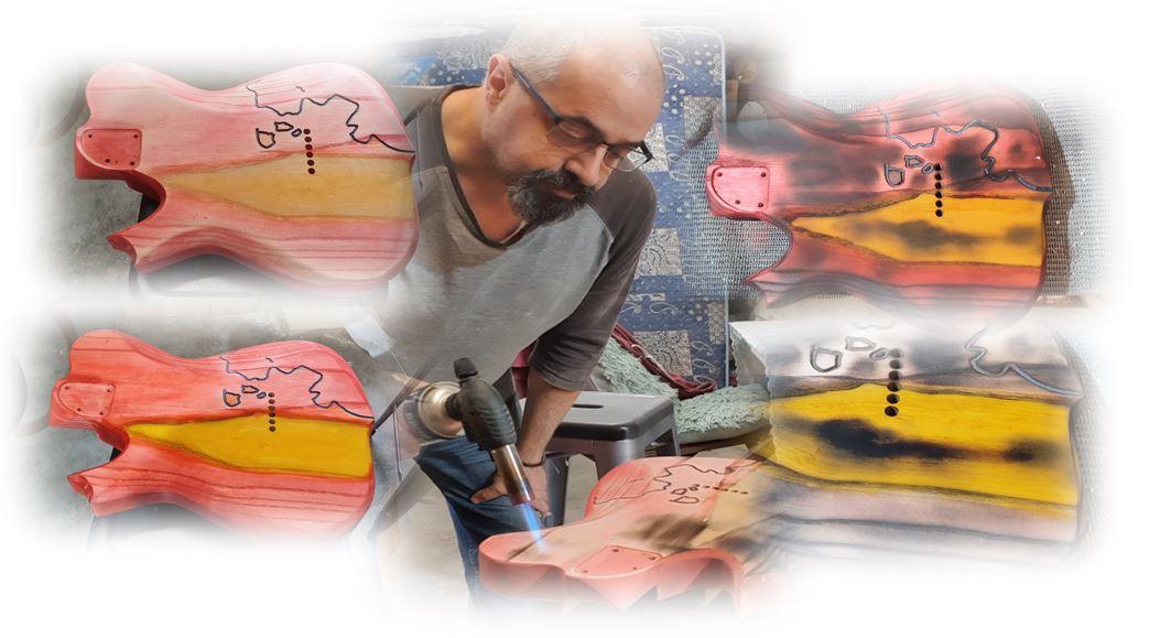

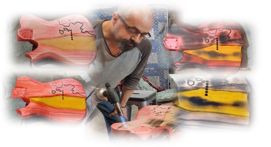

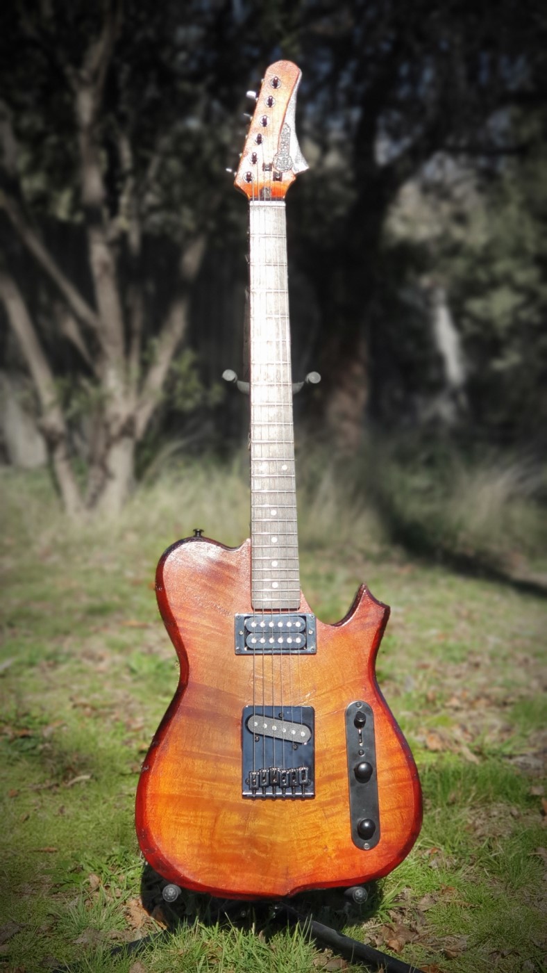

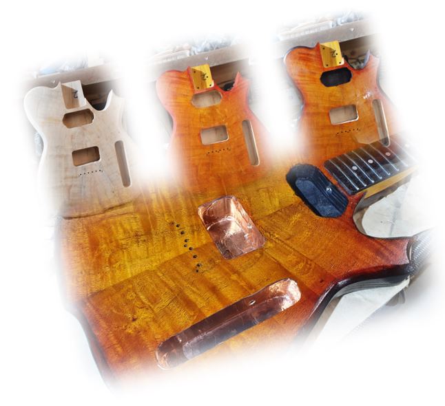

    Build 7.....Red earth
    This is a build i did for mate. I am particularly proud of this one as I wanted to make something as a gift to celebrate his ancestry and to also showcase my artistic skills.
    This is an Ash tele kit that has been heavily re-shaped, carved, burnt, stained and veneered.
    The veneer is a piece of Camphor Laurel, Stains are crimson, tru-oil finish.
    All black hardware and modded to fit a humbucker in the neck.

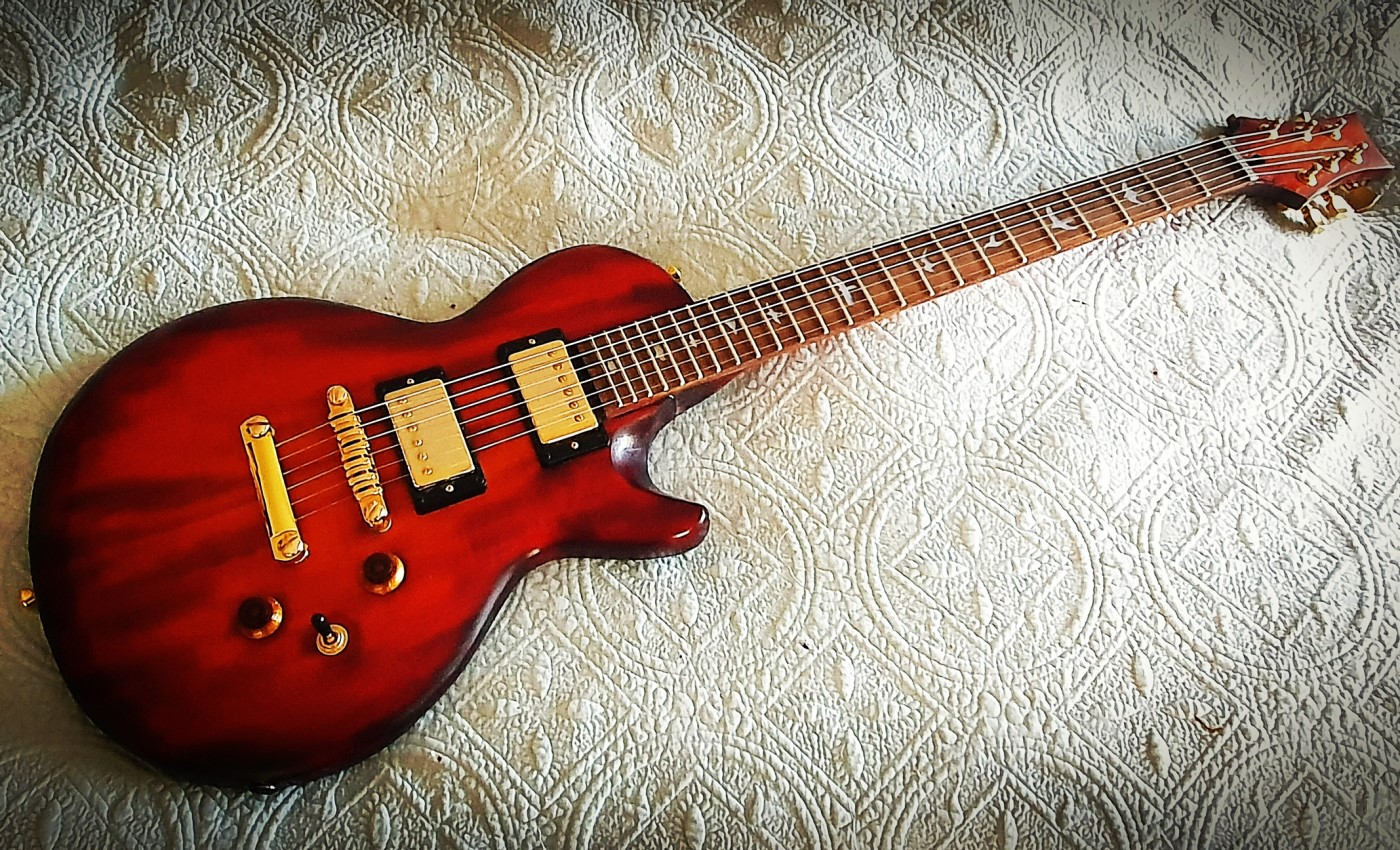

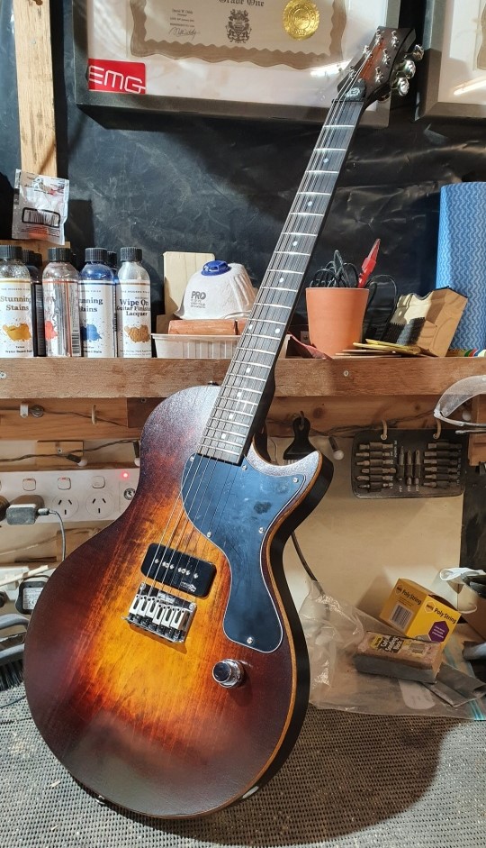

    Build 8.....
    LP Junior
    This was the last of the line and I picked it up. Veneered with some maple. I filled in the peg holes and fitted a string through Wilkinson bridge and a wilkinson P90. Vintage locking tuners and a slim PRS style headstock.

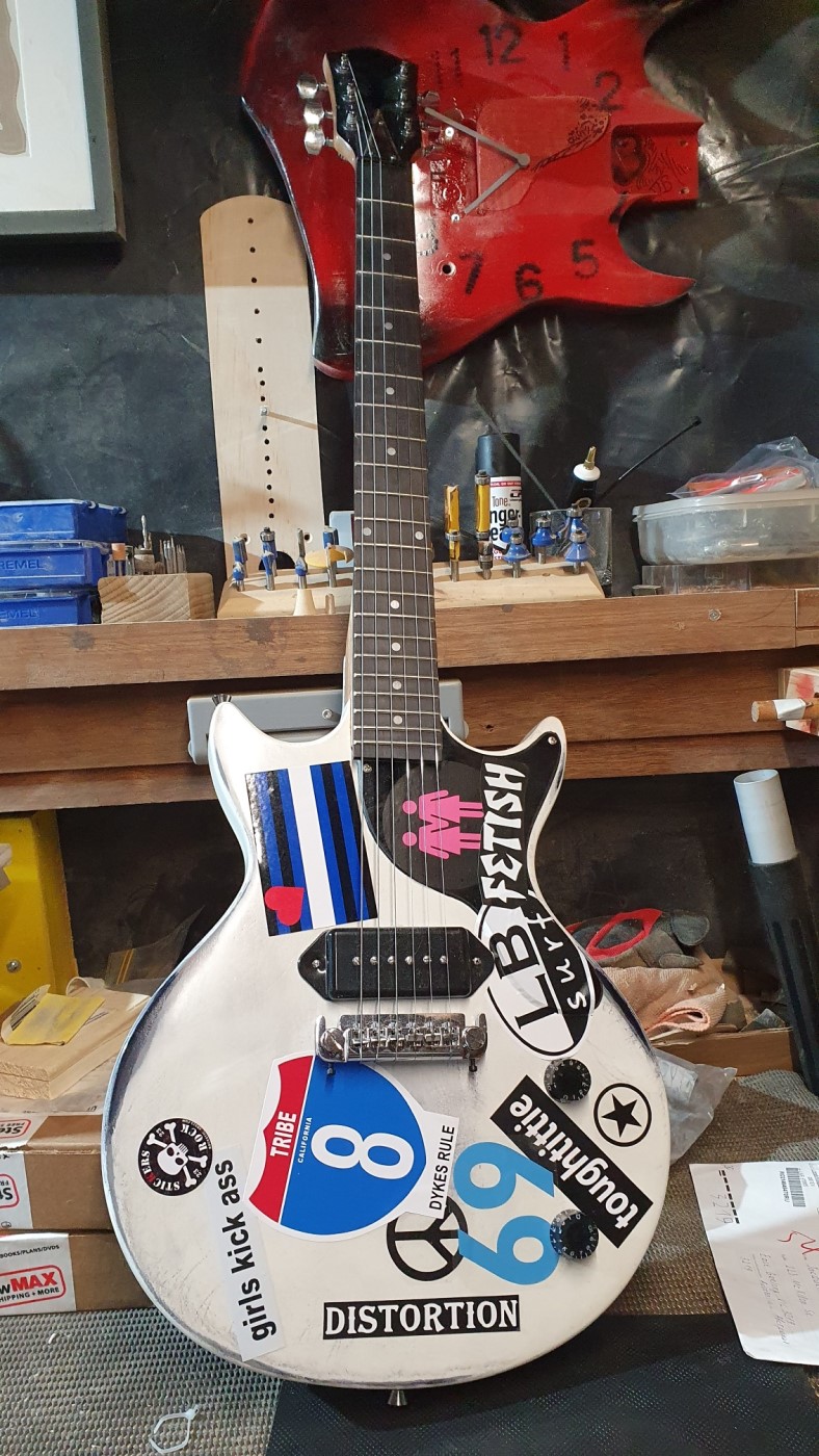

    Build 9......
    This was a replica build for a friend. I got her involved with the prep and painting and a bit of the set up so she felt a part of it.
    Joan Jett lives with this junior kit

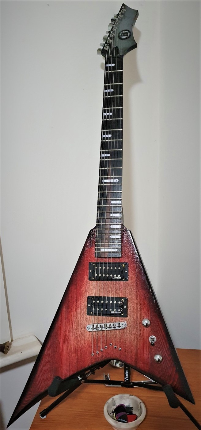

    Build 10.....
    This is an Ash 7 string 27" scale V. It has some beautiful figuring. I would build all my guitars from ash if it wasn't so heavy.
    This came as a blank canvas so i put my own stamp on it. Angled TOM and string through body. Warman pickups and crimson stains. No grainfill so not polished after lacquer.
    I fitted a strat style output jack and added the fret markers
    *Another birthday present from my wife!
