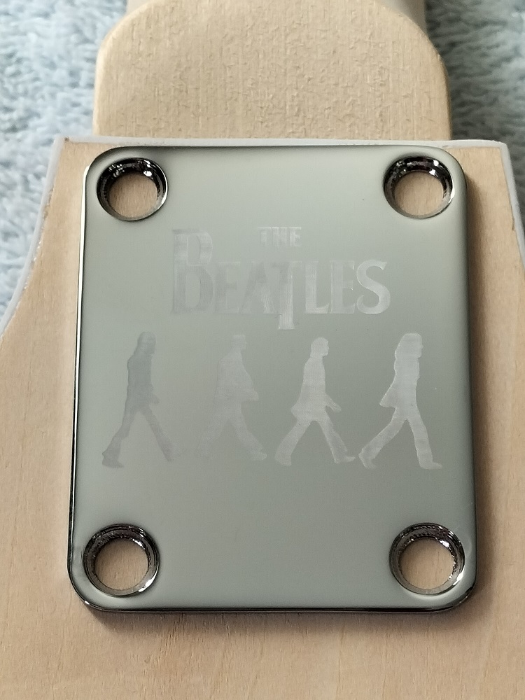

    Considering the idea of a bolt-on neck, using threaded inserts. Given the wedge shape of the neck seat, bolting on through a neck plate will require the neck holes for the threaded inserts to be drilled at a slight angle. I'm not sold on the idea yet, but we'll see.
    Looking for likely neck plate candidates, I found this Beatles neck plate on offer via Etsy. Seemed appropriate as an homage to the original Beatle bass. Won't arrive down under until end of May, and even then might not get used. But if I go down this route ... this is the way.
    Peter

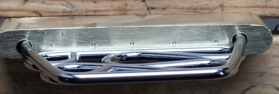

    I also hinted in my intro page about exploring a possible "narrow-5" conversion for this HB-4. I guess, if successful, I might technically then have an HB-5. (see https://www.buildyourownguitar.com.a...ad.php?t=12070).

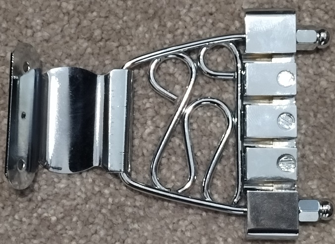

    So, just wondering if any of you local Wollongong/Illawarra peeps might perchance have some headstock scraps just laying around from recent projects where the headstock required shaping? To accommodate 5 strings, I'd need to plug at least one machine head hole, maybe two, so I could have three on one side of the headstock. Rather than do the usual dowel filler, I was hoping I could use a plug(s) of the same wood & grain orientation. The most likely source would, of course, be headstock scraps resulting from shaping of a headstock blank, none of which I have in my possession as this is my first build.
    Besides headstock mods, I'll also be turning the 4-string tailpiece into a 5-string one.
    Peter

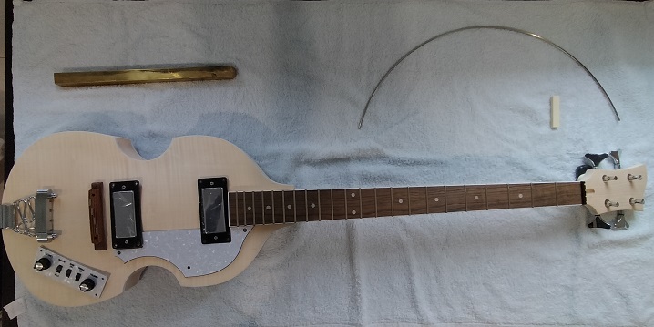

    I guess it's about time to share a dry fit pic. I ordered a brass block from which to fabricate a "narrow-5" string mount to replace the standard 4-string one in the tailpiece - it finally arrived today. I also ordered a replacement nut blank to do likewise at the other end. I won't be altering anything, though, until I've first had a go at shaping the brass string block. If that works out, then I'll organise to have it chrome-plated and consider tackling the more invasive mods (nut swap, & extra machine head which I'll have to order at some point, too). The length of fret wire is for saddle adjustments, & if/when I replace the nut I'll consider adding a zero fret.
    Peter
    I'd be a bit wary of adding a zero fret as you've got currently no fingerboard to add it on to. You'd need to fabricate maybe 5-6mm of extra fingerboard with a matching wood to fit the zero fret on. That moves the nut back by a similar amount, which exacerbates any string splay and also makes it awkward to fit the nut as the headstock in that location is both splaying out as it widens and sloping down, so the base needs to be angled. It can be done, but it's quite hard work to do well and is pretty much an aesthetic issue. I'd certainly make any zero-fret from stainless fret wire so it doesn't wear out so quickly.
    I'd keep it simple and just replace the nut as-is.

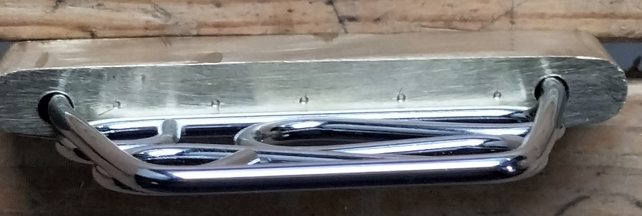

    I also roughed out the brass block, still have to grind the ends to round over before attempting to drill into it.
    Peter

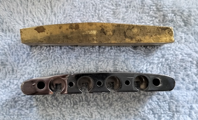

    Apr 2022
    Wollongong, NSW
    58
    Holey block, Batman, I got the drill press to work! 2nd hole punch there just needs a slight shift left. Otherwise, this one's shaping up nicely.
    Peter

    Quote Originally Posted by bassdude View Post
    Peter
    Tracking info says the neck plate landed in Oz yesterday, so looking good for arrival next week sometime
