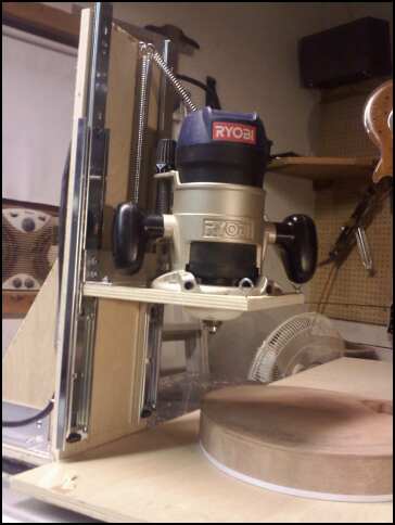

    And maybe you've seen these before, but since I'm gearing up to build an acoustic (and always dreaming about a scratch build) I've been thinking about how to do bindings, so here are some things for ideas/inspiration:

    This is a binding jig. Basically it holds the router perpendicular to the table, and lets it slide freely in the vertical direction for when the guitar is not a constant thickness, so the binding channel is always the same depth. There's a 'donut' mounted to the base that rides on the surface of the guitar. A fixture may be needed to hold the guitar level if it has a carve or bevel.

    Thank you for the inspiration, I'm enjoying this thread so far.
