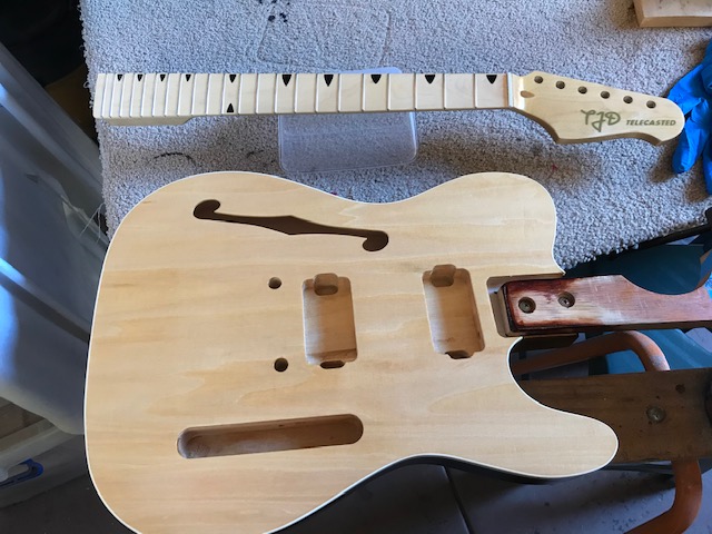

    Doing the final Tru-oil coats on the body and neck.
    fretboard has 4 coats (we will see if this is enough!!)
    Neck has 15 coats
    Headstock has 25
    Body has 25.

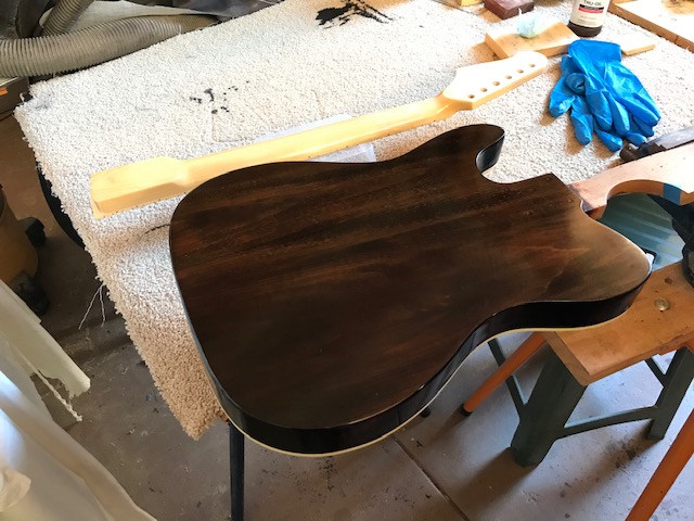

    The body and neck have been rested for about 2 weeks to let the tru-oil coats cure.
    I have now given the body and headstock a cut and polish with:
    1. Maguire’s Ultimate cutting compound - rubbed on with Random Orbital Polisher. Wiped off with microfibre cloth, then
    2. Maguire’s Scratch X - rubbed on with Random Orbital Polisher. Wiped off with microfibre cloth.
    Finished with a final Polish.
    I am happy with the final result - but I still have room for lots of improvement.
    The pictures show before (sanded up to 2000g), after Polish with Ultimate, after polish with Scratch X.
