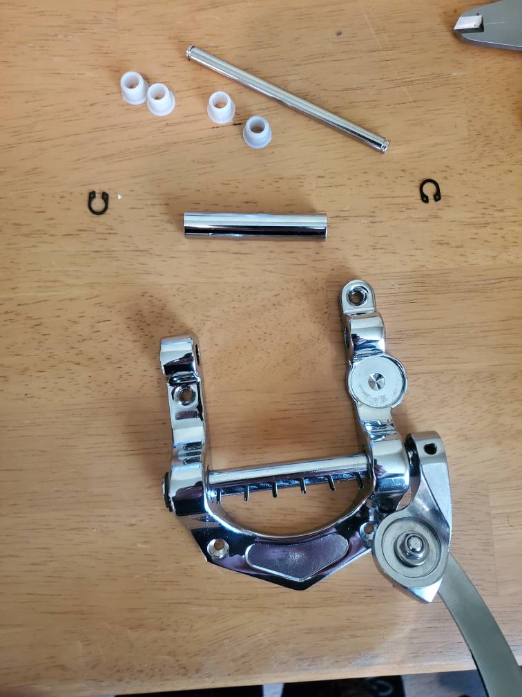

    I ordered a TL-1TB kit that came with this vibrato system. Looking at it, I'm already thinking of improvements.
    I did some research, and there is a company that makes improved parts for the original bigsby, but they don't work on these copies. So, lets pick up on some of the improvements they made, and apply them to this one. Make it a little better over the next couple weeks.

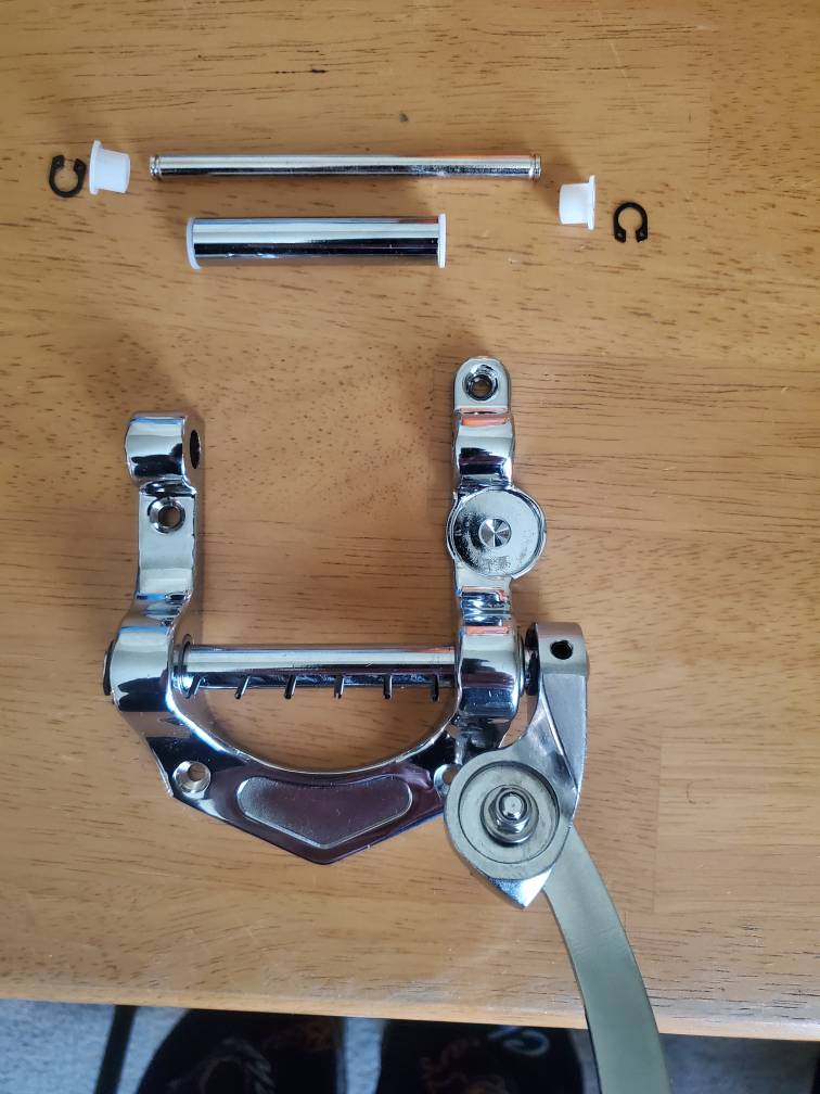

    First, the side-to-side play on the string mount bar needs to be addressed. It needs a 1mm washer right next to the vibrato arm, outside of the bearings (YES, THERES ACTUAL BEARINGS IN THERE!!! ). Remember to lube them.
    Second: The bar that the strings pass under, to go to the bridge, wobbles in its plastic bushings. I'll fix that plastic! NO WOBBLY! Also, add string slots to the bar to maintain string spacing.
    Third: The burrs man.......... This thing needs some TLC with a fine file and a scotch-brite wheel.
    All other hardware and parts on said tremolo will be scrutinized, and dealt with accordingly. I'll do some fit and finish on this one, and document it here. It's going on my TL-1TB.
    Also, I'm doing a GR-1SF that also has a bigsy style. I'll be applying these modifications to that one as well. Cheers!

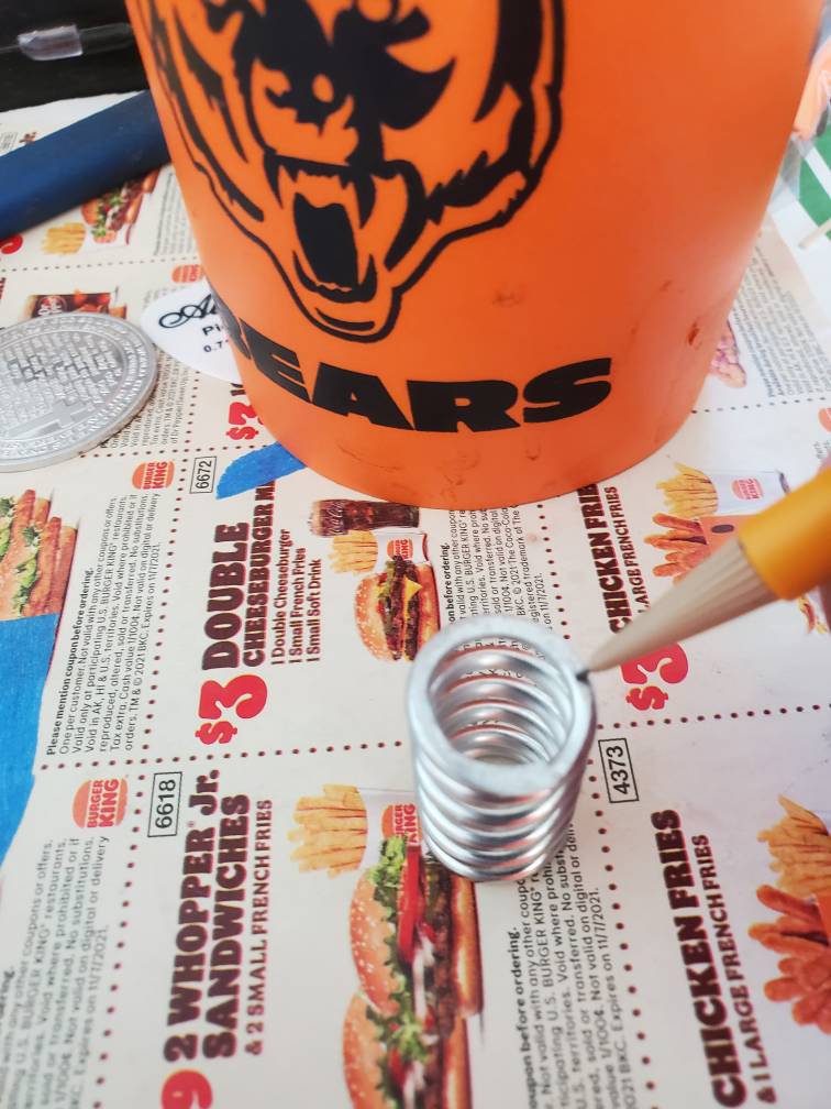

    I am a bit worried about the size of the spring as I think it is too large and will make the vibrato arm too high. (I recall that someone else had this problem a while back but I cannot find it on the forum.) I will wait and see how it sits with the strings in place. I may need to trim the spring a bit.

    I also read about the spring. I agree that it sits high, but I have yet to see it under string tension. There's a few videos on it, but I suppose I need to try it for myself. I'm also going to go look for an alternative spring tomorrow at the hardware store. They're cheap here, and I want to see if I can mess with the different sizes, if they're available. Cheers!

    People have cut down the kit spring to make it more useable and get the bar at a more player-friendly angle, but finding a shorter replacement will be better.

    I probably won't groove the roller bar, but will certainly change the plastic bushings to brass or aluminum. The bar doesn't have any side- to- side play like the vibrato bar , but about .05" of up-down. I can freely move the bar, and if you hold the unit in your hand and shake it, the plastic bushings rattle around in their pockets in the tremolo base. I can't leave that alone (my personal OCD there). I want the bar to be stable, not free floating and moving around.
    It may even not be an issue, but I think vibration transfer through better fitting bushings would better than the plastic loose ones. It is getting a wilkinson roller bridge.
