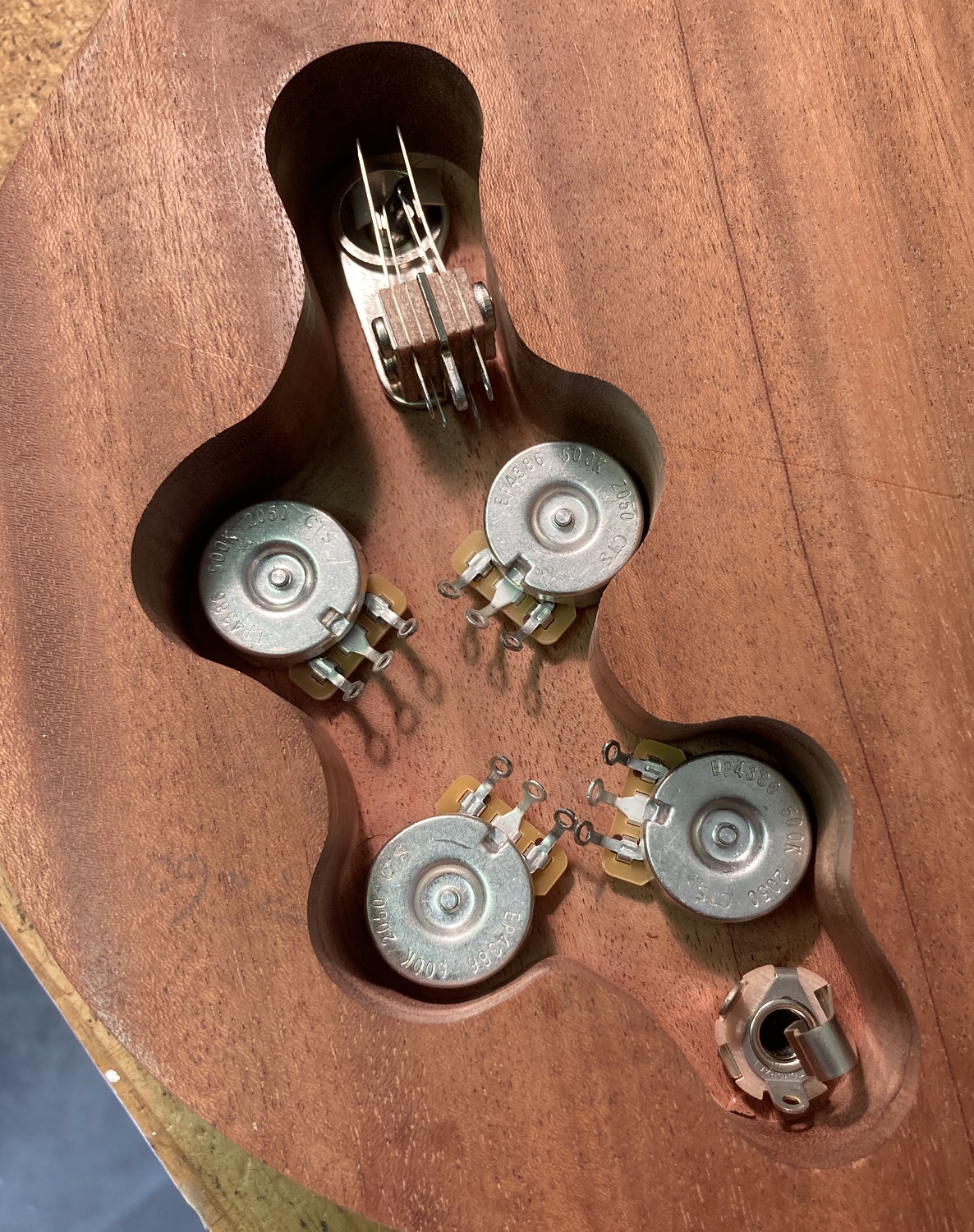

    Step 6 - Cut the Cavities

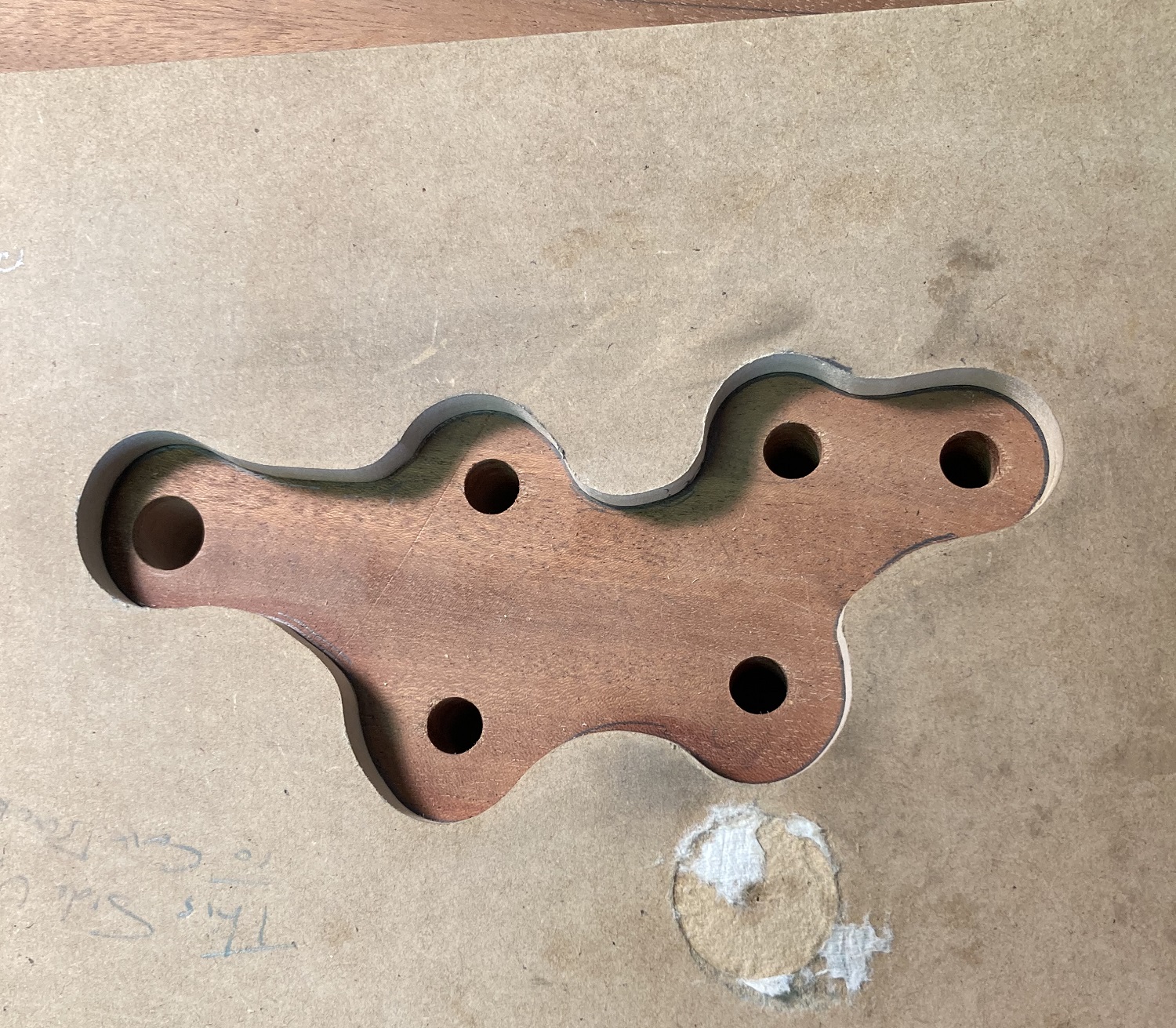

    Decided to do the electrics cavity first
    I went to the forum to find out whether leaving 5-6mm on the guitar top was enough
    Link to discussion : https://www.buildyourownguitar.com.a...eferrerid=4588

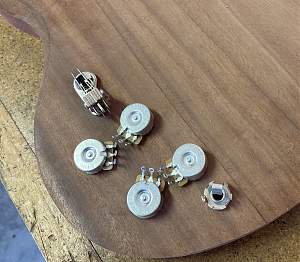

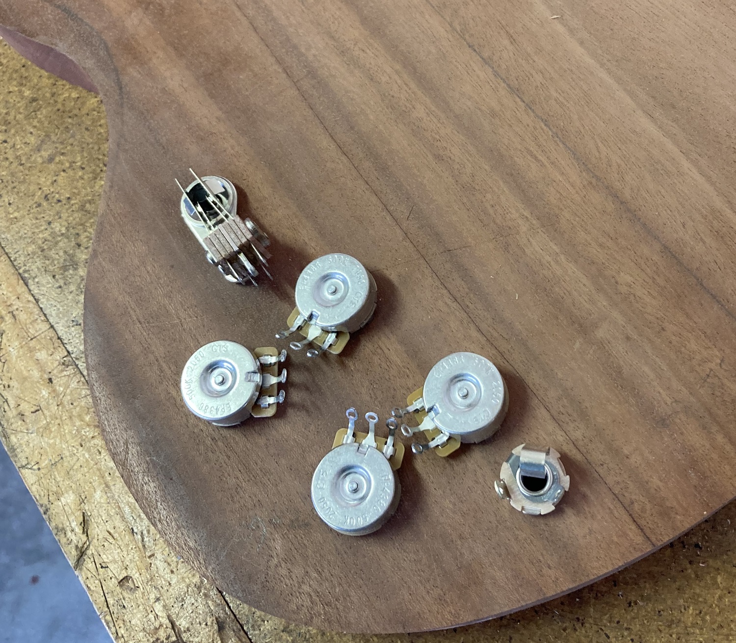

    I first drilled the holes for the components from top down then checked that the plan cavity was OK. I think the design had planned to use mini pots although it didn’t say. I had to expand the cavity a little to fit the full-sized pots included in the AllParts SG electrics kit I had purchased
ID:	40276 Click image for larger version.

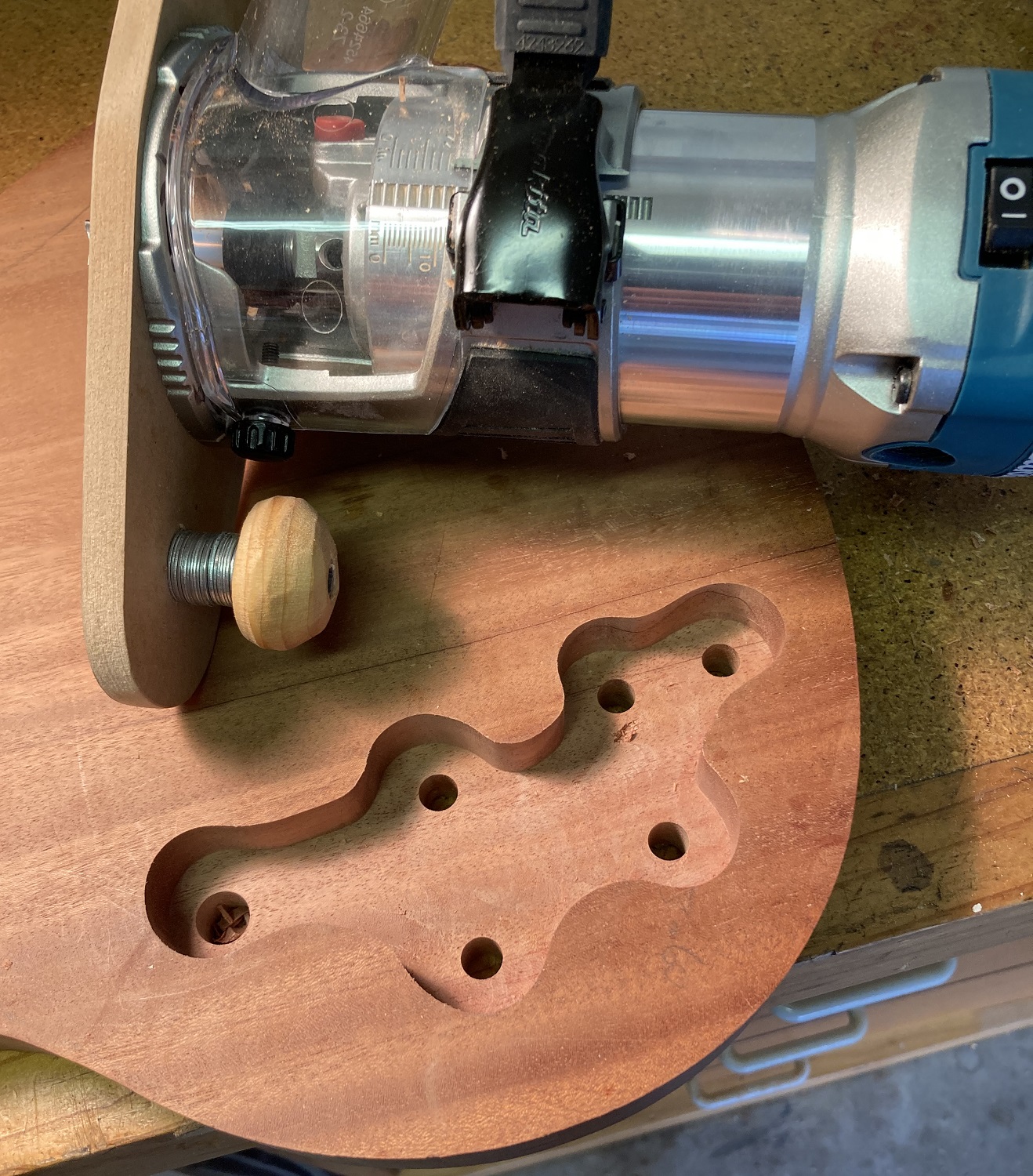

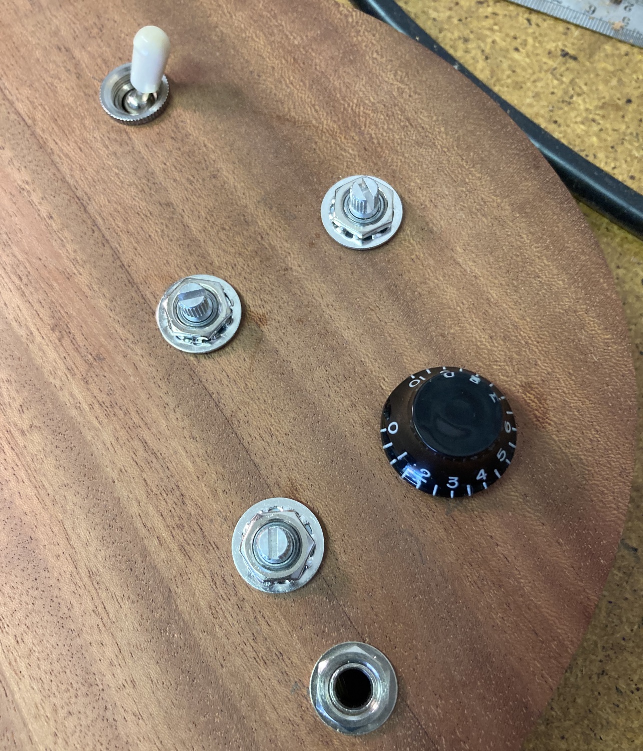

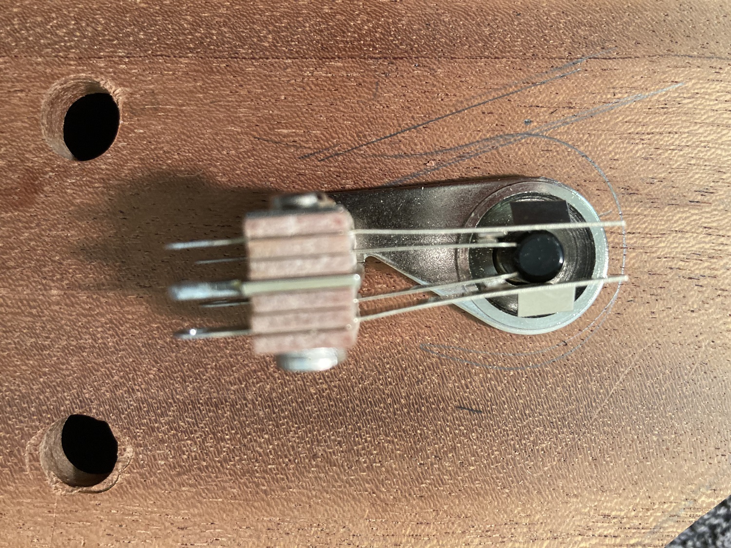

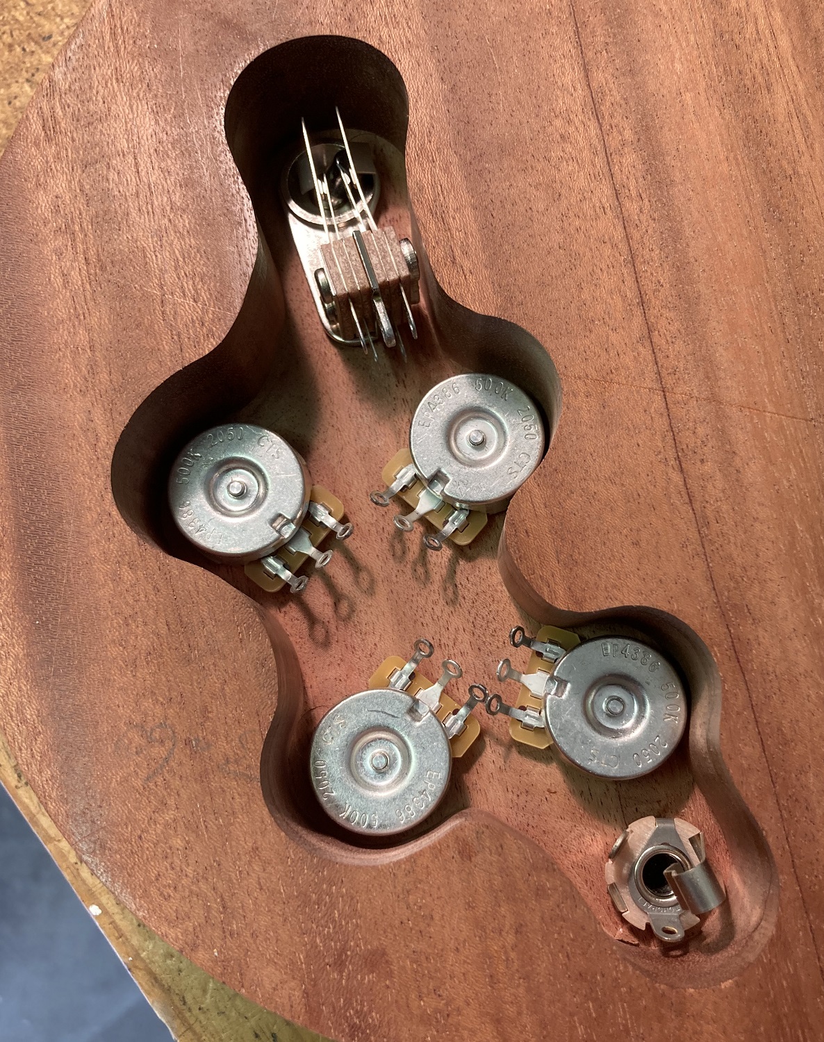

    ...cont from last post ...
    I cut down about halfway with forstner bits and then crept down 3 mm at time with the router.
    I got to 7.4 mm then decided to try the components to work out the depth of the final cut. I was able to fit them all.
    Very happy to have 7.4 mm of wood on the top.

    Very tidy work.
    What type of cover are you fitting over the cavity? Recessed or surface mounting? The toggle switch looks to be close to the surface, so if you then add a 3mm rebate for a cover, just wondering
    if they might clash.
    Also, whilst you'll easily fit small ceramic disk capacitors in that space, chunky orange drops could be harder to fit in. The higher voltage rating the capacitor is, the bigger the cap body is. Any capacitor voltage rating is fine for guitar use, so if you have a choice, select he smallest voltage rating you can.
    And have you given thought to where the pickup lead hole will go to avoid hitting a pot or switch? The lead on 4-wire pickups is relatively thick and you need to get two of them into the cavity. Even braided single-wire leads are quite thick. The minimal cut-out approach looks nice, but you need to account for where everything goes, and I fear you may have overlooked the location of these leads.
    Also, have you considered how you'll drill the cable channel? The thin body gives less scope for drilling at an angle from the bridge pickup rout before you come out the other side, and the minimalist control cavity doesn't allow you to get a shallow angle on a long drill bit for drilling from the cavity to the bridge pickup location. A batwing pickguard would allow you to rout a surface channel to very close to the selector switch location, and drilling through from there would be a lot easier. But you may have planned to not have a guard at all.

    Hi Simon
    Thanks for keeping an eye on my build. I have enough trouble re-planning and re-measuring each step many times at the expense of thinking too far ahead. Amateur ignorance is bliss until it's too late. hihi.
    You are right. I had not considered the measurements for the electric cover other than planning to use a piece of light African mahogany similar to my LP and had assumed is would be recessed 3mm. Well luckily there is 4.8 mm clearance to 1.8 to spare. Whew!
    I had not though much about drilling the access channel for the pickups other than buying a 300x6mm bit. I had also planned not to have a pickguard so I am not keen to route the cap. I like wood not plastic as you know.
    I did some measurements today and decided I need a longer drill bit so have ordered a 450x6mm one to reach from the neck cutout to the cavity. The electric drill chuck was going to make me lift to too steep an angle as it would be over the neck cutout.
    I any member reading this have any hints on cutting the tunnel I would appreciate them.
    I have taken the photo to show my approximate target area. I think I have enough room to find an opening.
    The problem is to link the two pups and the bridge earth. I will have to work it out after I cut the neck and pickup cavities.
    If the worst comes to the worst, I will have to use the pickguard as you suggested.
    I can also expand the electrics cavity with the mighty little Makita if necessary.

    Good to know you've got enough height in the control cavity. It did just look that bit close in the photo.
    I've yet to make a flat plate for the Makita alone. I have got the plunge router base for it, which is wide enough to bridge most gaps on the guitar body, but visibility is much reduced, so you're reliant on the follower bit doing its thing. Had I had just the palm router with a small baseplate so I could see the bit, I wouldn't have done so much damage to the pickup rout floor on the GST-1.
    Though I've never drilled such a long channel, I'd suggest trying to make a wedge to rest the bit on to keep it at the correct angle so it comes out at the right place. Maybe even use a bit of 6mm I/D metal pipe to use as the guide, with a couple of wooden blocks to support it and give the angle. Those long bits are pretty flexible, so some support for the bit will help to keep it pointing in the right direction.
    I'd definitely pull the pickup leads through into the cavity before fitting the switch in its hole. If necessary, you may have to undercut the side in that area (if you want to keep the cavity shape at the top intact). You don't really want the pickup leads forcing the toggle switch block to move down to get past, and getting the wrong angle on the switch movement. Don't forget you've also got a full-sized pot that is partially blocking the cable exit route, as well as all the wires soldered and heat-shrinked (so quite stiff) to the end of the toggle switch. I'd drill the channel and then have a dry run with the cables before making a cover for the
    Cavity and routing a rebate for it, in case you do have to make the cavity a bit larger in that area.
    On my Pit Bull SG, I had to cut away some wood in the bridge pickup rout where the channel ran to the control cavity. The hole was 2/3 up the side of the rout, so that the pickup leads prevented the pickup from fitting in the rout. I lowered the bottom of the hole to about 1/3 from the bottom with a mixture of a round file and a Dremel.
