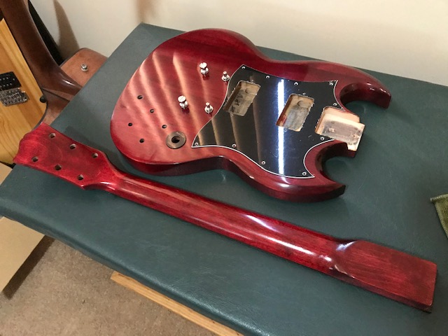

    Have given the body a wet micromesh treatment, then a polish with Maguires Ultimate compound and Scratch X.
    I'm afraid I still have a lot to learn about applying finish. I think I need to be more brutal (but I don't want any burn through).

    Looks great from where I'm standing.
  9. #19
    Mentor robin's Avatar
    Brisbane
    1,513
    Looks very nice to me Trevor, I'd be very happy with that.
    rob
  10. #20
    Looks to have a good gloss there. Look forward to final assembly!
    You're not alone! I'm generally happy enough with the results I get, but none of them are flawless. I do seem to improve with each one, but it would take way more builds than I'm prepared to do to get to 100% every time!
    I have not used Meguiar's on Tru Oil before but have decided I don't like using it on acrylic lacquer. It polishes ok, but I don't like the way the finish feels after. Looking at the MSDS there are very small amounts of petroleum products in it (including naptha). Certainly enough that I can smell it. Not sure those ingredients are a good match with oil based or solvent based materials, but an expert or a chemist, I am not. I know lots of people use it and like like it so I'm sure I am a very small minority.
    It may also be my imagination (of which I can have a very active one) but it also seems after the shine has "worn off" the finish appears more dull than before polishing. If that makes sense.
    I've since decided my 3M Micro-Gloss polish works best for me.
