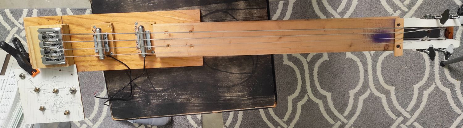

    I made a template of the control positions that I put on a piece of very thin masonite or plywood. I made it on paper first, then made a PDF so that I could archive it. I glue the paper to the masonite.
    I am a bit paranoid about getting the wiring right before putting it in the guitar. It's such a huge PITA to get the harness through the f-hole and in place that I wanted to make sure it worked before making the attempt. So, I built a "testbed" to make sure everything worked. You can see my original here.
    https://www.buildyourownguitar.com.a...?t=5339&page=9
    It seemed like overkill at the time, but the cap values I had in the plan did not work at all well for me, and this allowed me to change them before putting the harness inside the bass. In one of the pics you can see my solution to shielding the wiring in a semi-hollow bass ;-)
    I have since improved the test bed. I have been making changes to the bass in the diary above, and pulled the wiring harness out. While it was out I re-soldered a cap that had come lose, and did a mod on the pickups. It's almost ready for testing.
    It really is overkill now...but I actually added the bass tuners and four strings to test different bridge configurations in paulownia wood for a different project. So in for a penny...this time the pups are in the same location they'll be in the finished bass. Will test the tone caps again with all four strings this time ;-)
