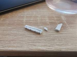

    I'm also regretting not installing a bone nut when I first got the neck. I'm definitely compiling a list of tips and tricks from this build.
    The plastic nut did not come out gently.

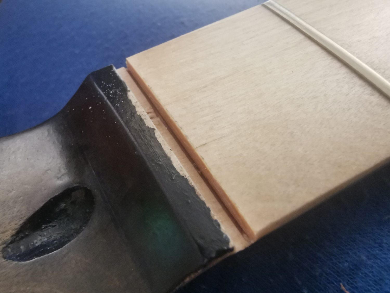

    Despite scoring along the finish on all sides, it still took some paint from the headstock side. Fortunately that's a completely black area so touched it up later with a sharpie, and will mask off and wipe on some poly in the future.

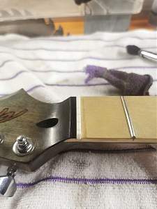

    The bone nut fit perfectly. Just a tiny amount of sanding to get the width exact. I used a really small amount of wood glue to adhere it, just to keep it from moving during low bends etc, as the friction fit is really tight.

    There are fine gaps around the nut that I'd like to try and fill, I think I have some maple dust in a container that I might be able to make a filler from.
