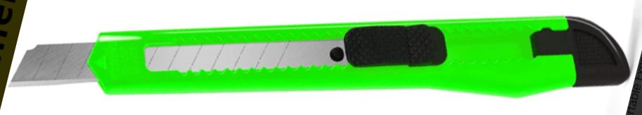

  9. #149
    3,048
    I have been using one of these cheap box cutting knives.
    I am not very expert at binding scraping...and mostly I have used this to touch up where the tape did not adequately do the job.
