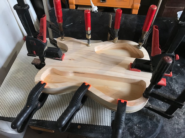

    1,967
    I never realised that when building guitars the number of clamps you need is N+1, where N is the number you have. Another trip the the BGS is on the cards.
    Clamps, guitars, hand planes, chisels, files, rasps, amplifiers, Road Bicycles, motorbikes, V8 performance cars.......N+1 is a universally applicable money reducing equation.
