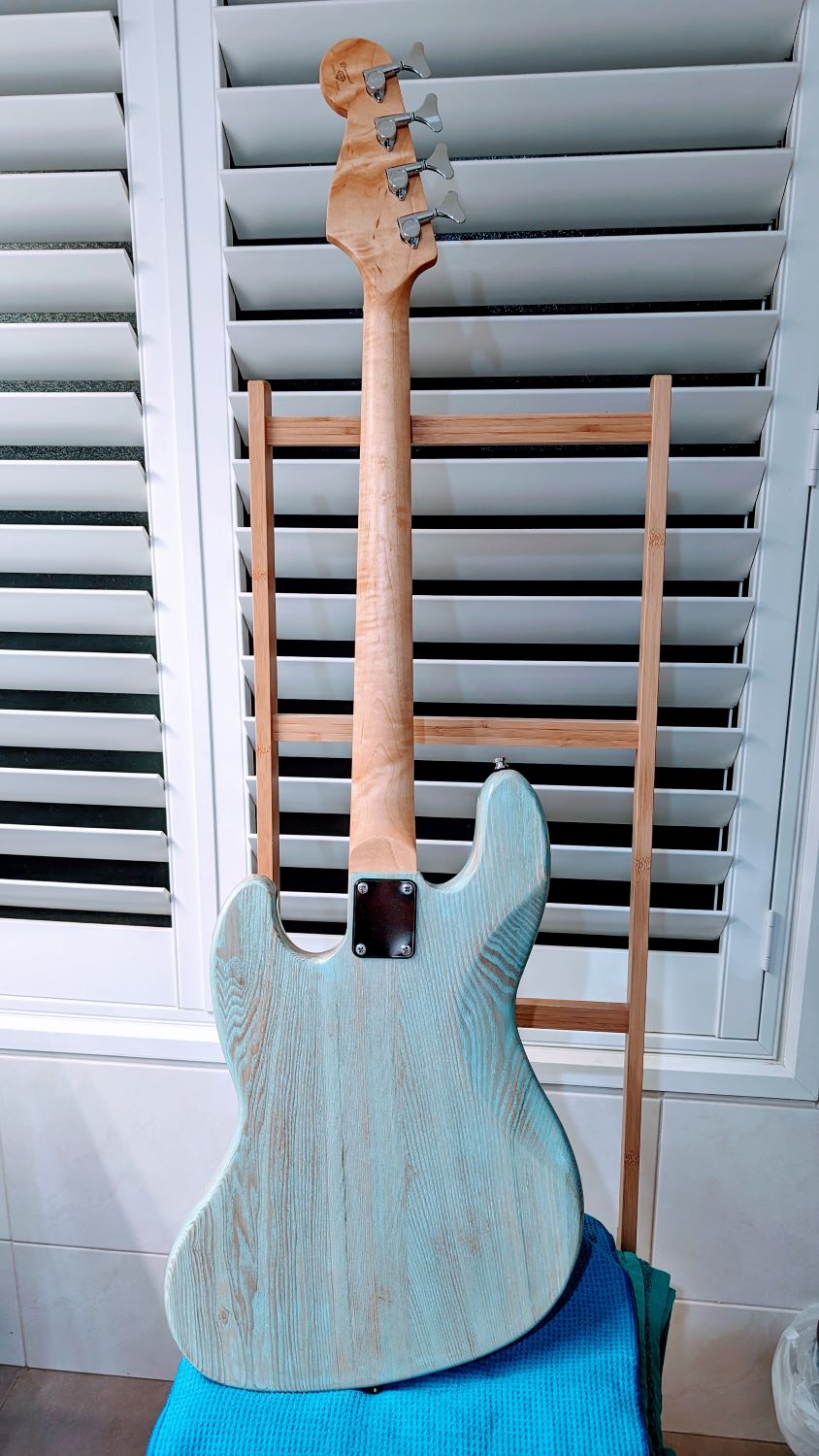

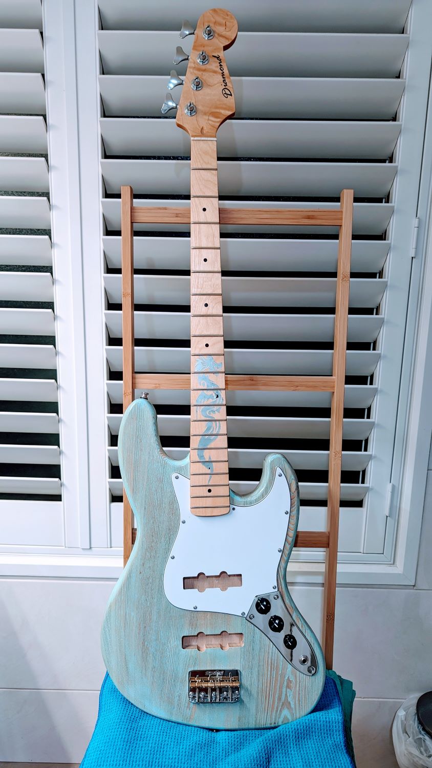

    Thanks everyone. I think I can solve the neck pickup issue with a new pickguard that has a standard cut-out. There's plenty of space in the cavity under the pickguard.
    For the Bridge, I used a sanding barrell on my dremel to widen the "ears" a couple of mm's. The actual pickup width is just right. It looks a touch strange to have lopsided ears but it really won't be noticed with everthing in place and the strings on. If it gets visually annoying I have found a US retailer that sells a pickup ring for a J-Bass bridge pickup. It wouldn't look too bad, I don't think.
    Have attached a couple of photos of the build so far. I'm really happy with it. It's a gift for my niece who has been learning to play Bass for a couple of years now.
