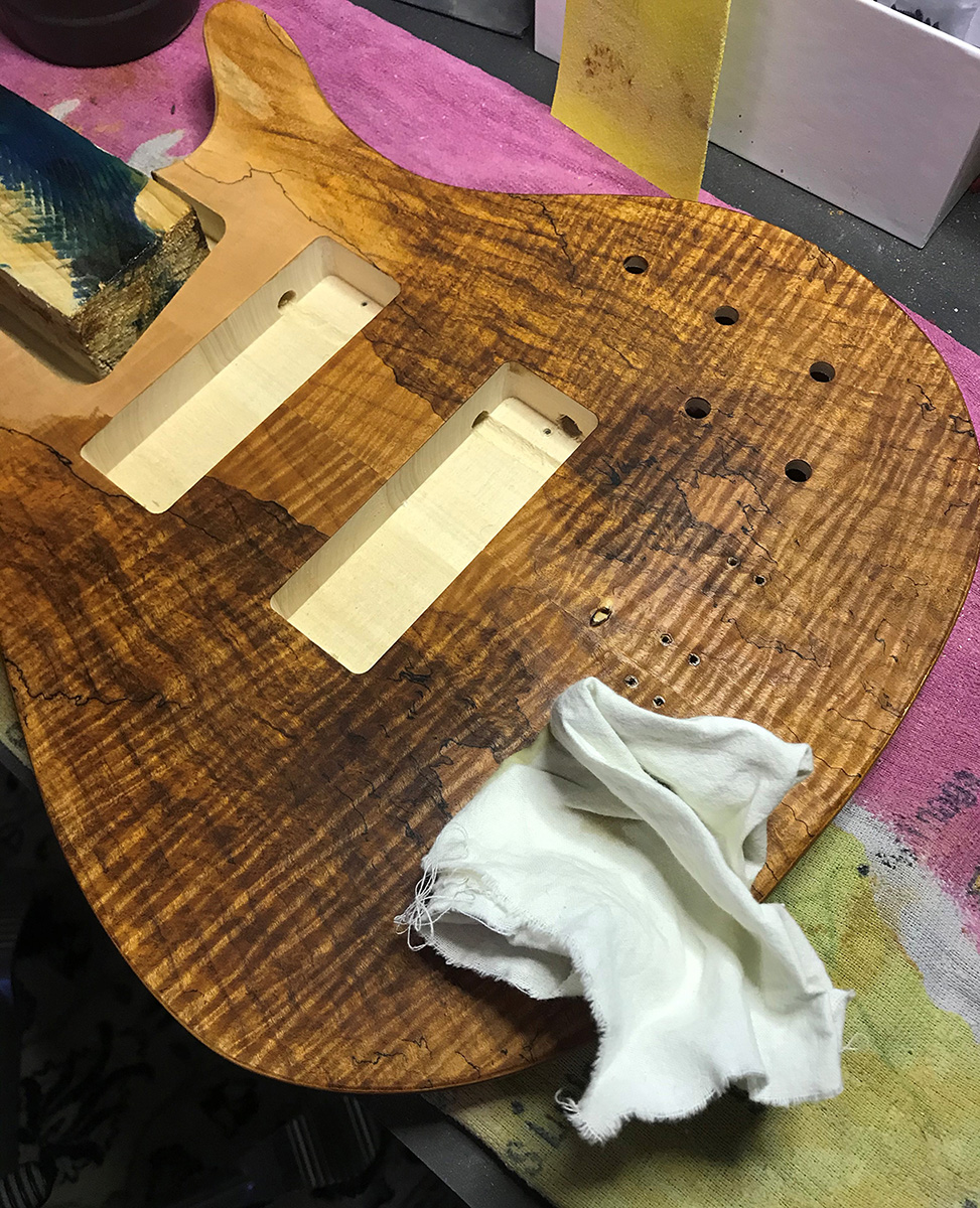

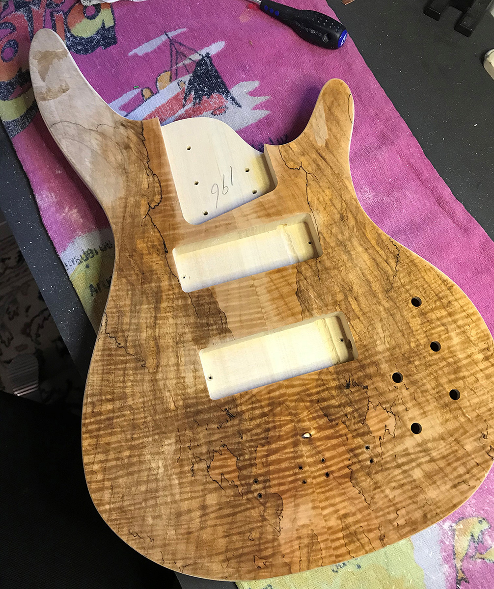

    I have been working on the finish for a while. Applied a warm oak stain to the front and a darker color on the sides and back. As it turned out there was some glue stains on the front that I thought was natural variations in the wood. I have decided that it is not worth the risk to try and sand it off.

    Sanded the back of the neck, but only reduced it by a few mm's.
    Now I am applying multiple coats of true oil.. Stay tuned.

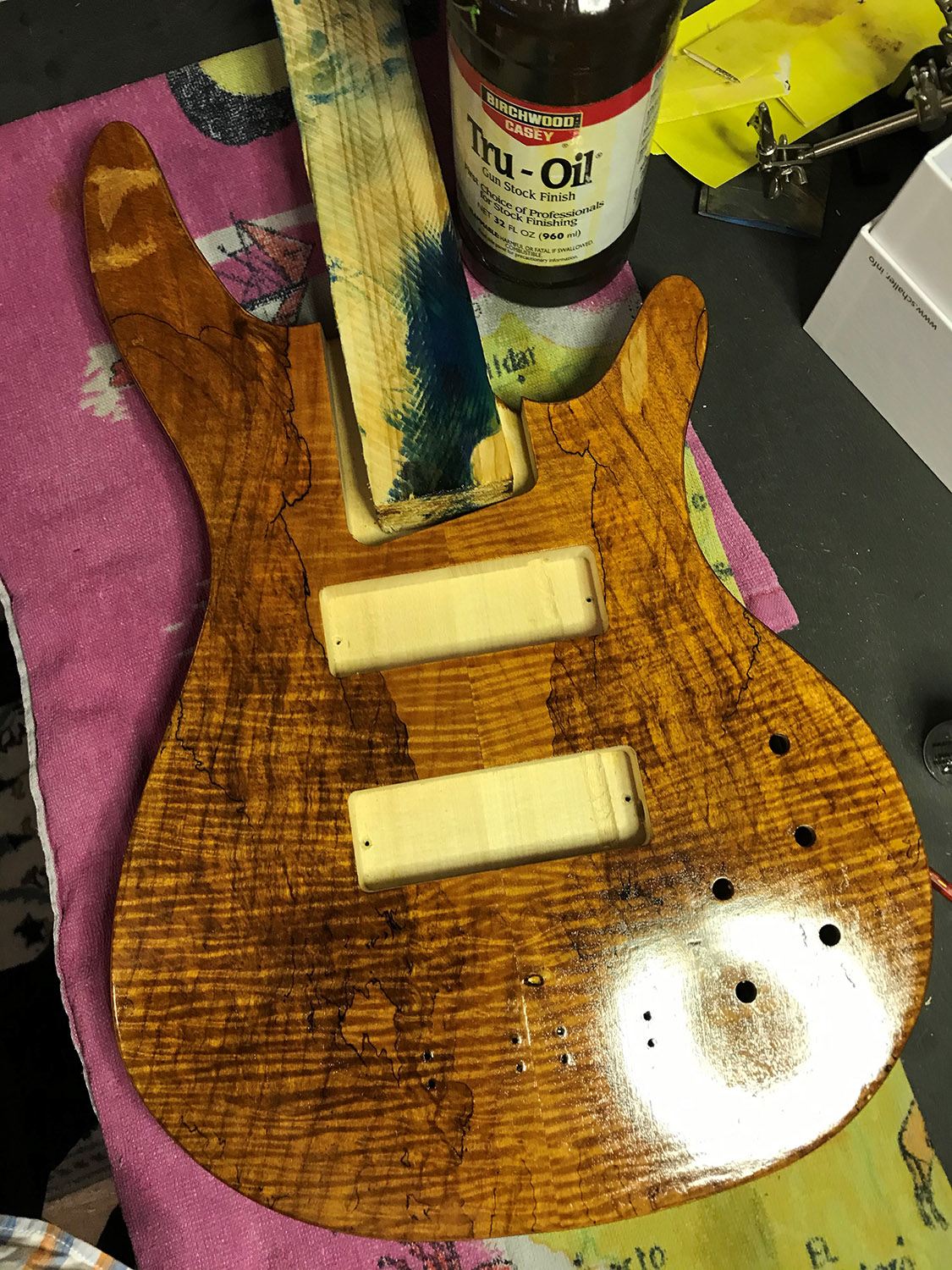

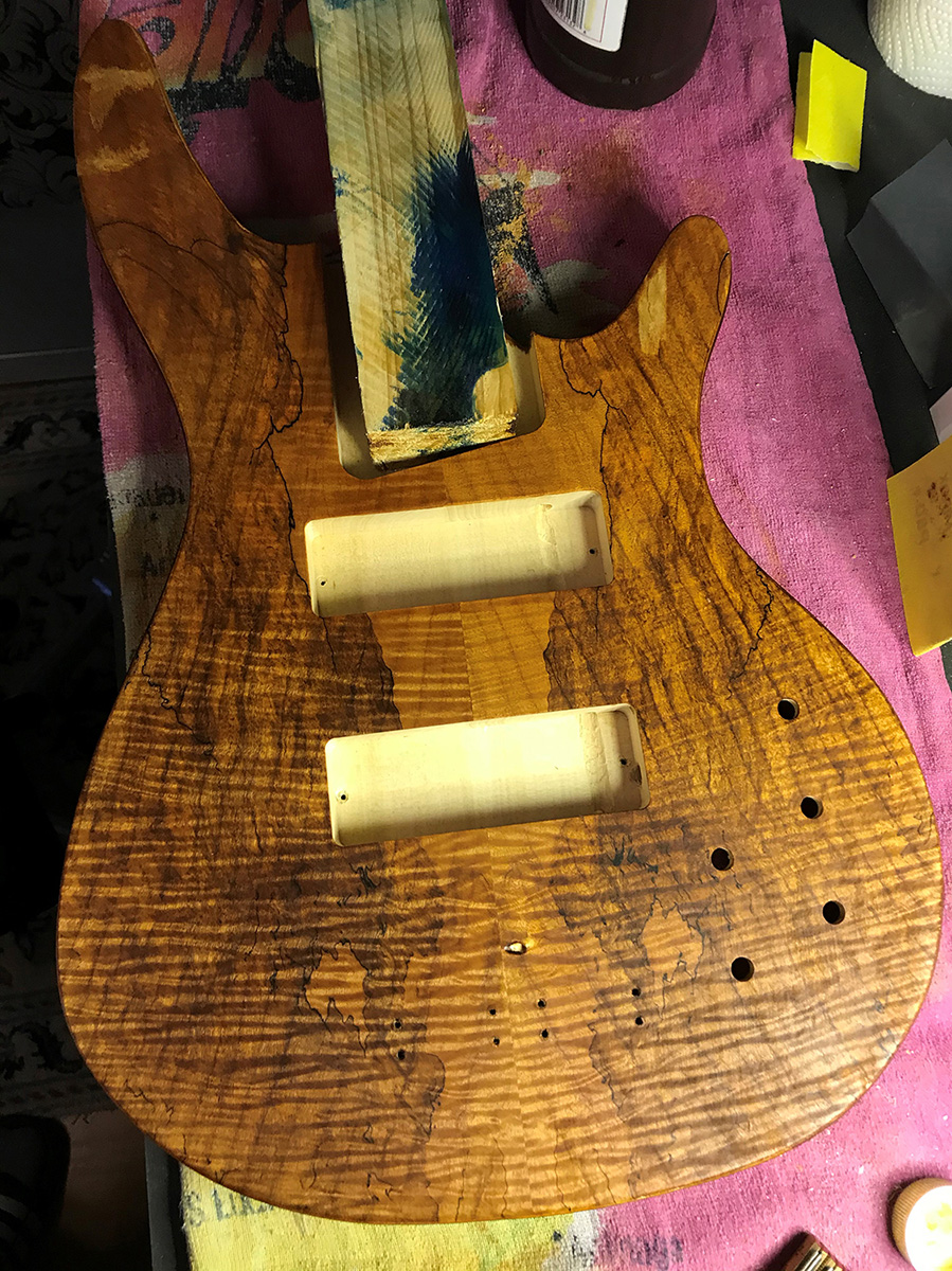

    Here is a few pics with the front and back after 6-8 layers of oil

    I don't think I can see glue stains if that's any encoragement. There's a mark that looked like a glue stain at first, but its so perfectly book matches I don't think it can be. Its an interesting look that, rather striking, although perhaps not what I'd want for one of my own.
