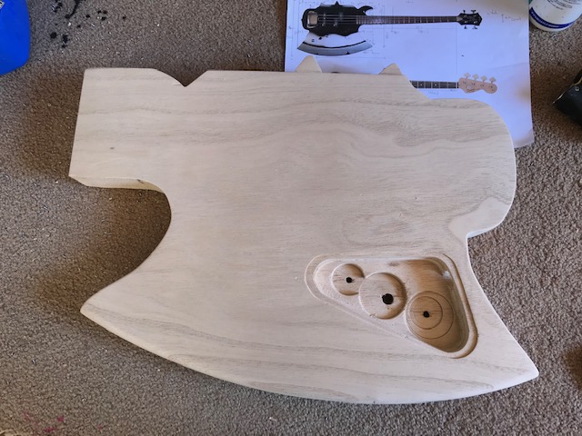

    So, being a big Kiss fan, I have always wanted an Axe Bass.
    So after getting a slab of paulownia of Dozymuppet I decided that the time has come.
    I have ordered a PB neck (SSR-4 type) which is a bolt-on, 2x2 paddle and a PB-4 chrome hardware kit. Arrival date is in October.
    I will try to use a JB style for the bridge pup and a PB style for the neck pup. 1 volume, 1 tone and a 3 way switch.

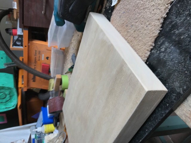

    I have sanded the body slab down using a belt sander - started with 40 g, 80 g and 120 g.
    Sketched a rough outline of the axe from a web picture.
    Cut out the body using a jigsaw.
    Sanded the body down.
    Routed out the electronics cavity using a handheld router - (but I need to get a pattern following router bit rather than using a collar guide). My bit was not deep enough so I also have to drill out some wood to get to 5 mm thickness top.
    Also made a cover plate for the electronics cavity out of 3 ply pickguard material.

    WOOOOOOO! Rock and Roll! That's looking awesome Trev!

    Nice work trev.. You beat me to the punch. I have a custom YB-4 on it's way (eventually) with the intention of modifying it into an axe with aspects of the Cort and Kramer axes.

    Great to see that slab going to good use, Trevor \m/
    Gunna be a heck of a lot lighter than the originals. The Corts are Mahogany, the Kramers I believe were Maple. Not sure what the Jacksons in between or the two before the Kramers. With Simmons' frame, he could handle the weight.
