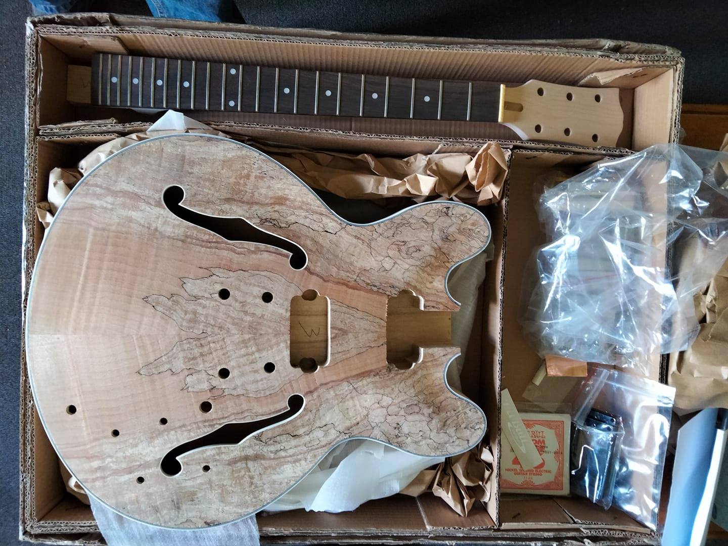

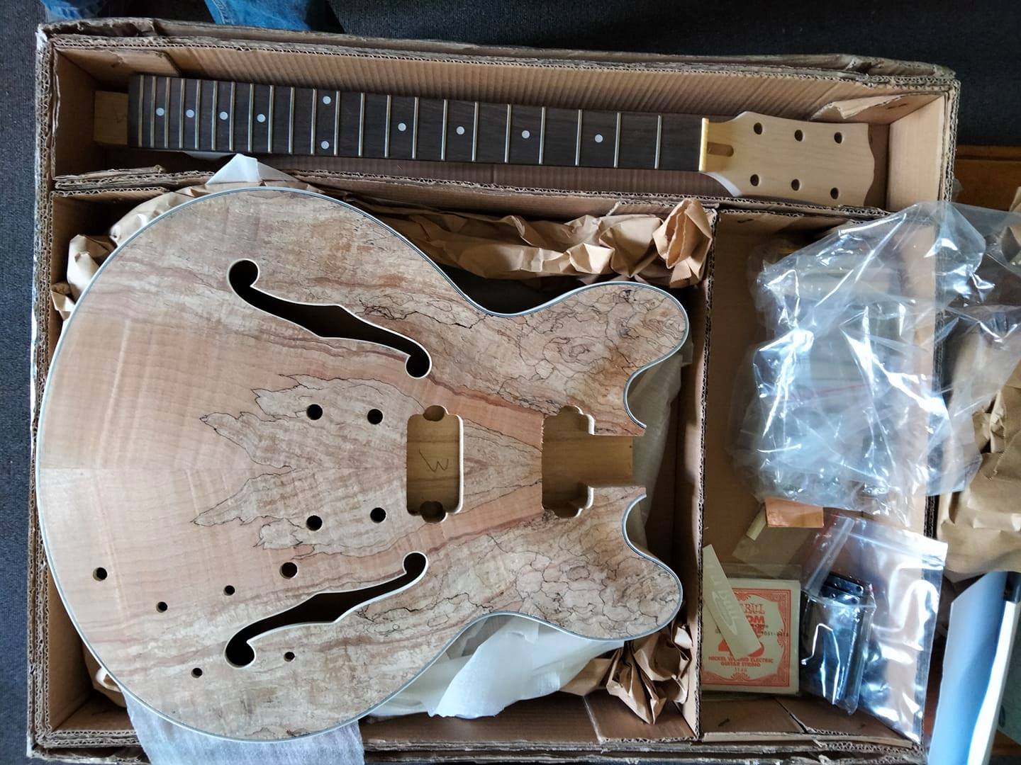

    Am building a Pit Bull Guitars ES-1S Electric Guitar Kit (Spalted Maple).
    This is my first kit guitar.
    I have previously build a body for a bass, using an existing electric bass for parts. I've also customised electric guitar body shapes, changed pickups & wiring configurations, and done custom paint jobs on acoustic guitars.
    The kit arrived monday. Might have it finished today (Wednesday)

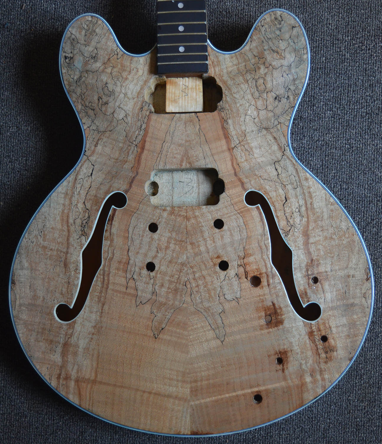

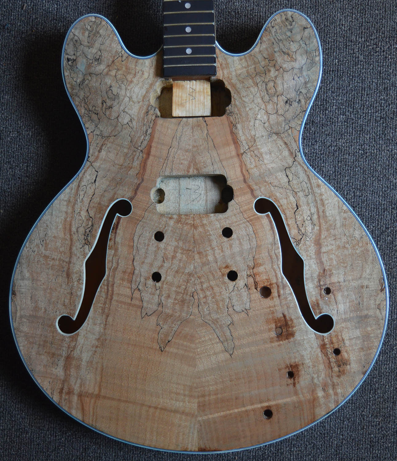

    Absolutely the spalted maple top is a stunning piece of timber veneer. I was planning a blue-burst fade, until I saw how awesome it looked.
    I've used "Cabothane Clear" gloss on the top, and tung oil inside the cavities + the back of the neck & fretboard.
