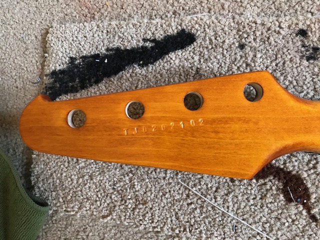

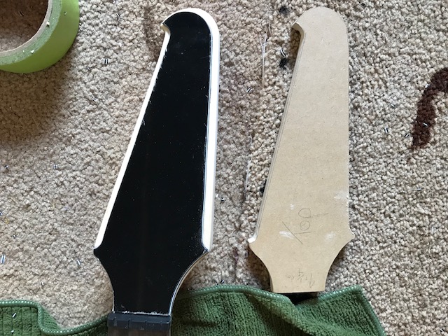

    Reshaped the headstock and created a 3-ply laminate for the headstock. I still need to round over the edge of the laminate with wet and dry.

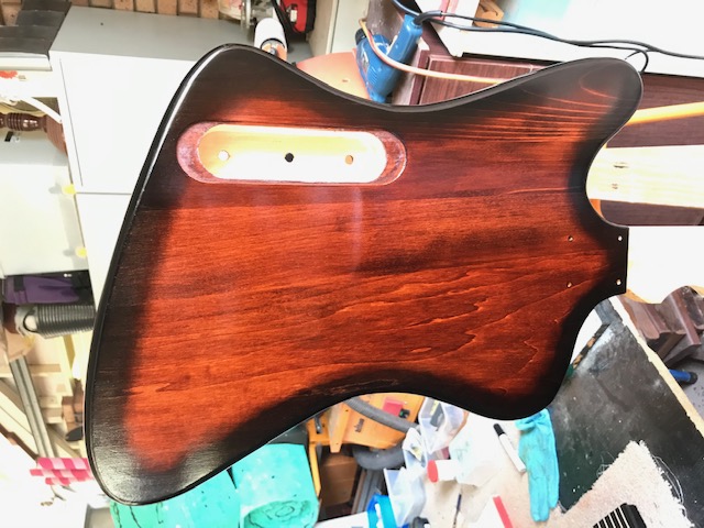

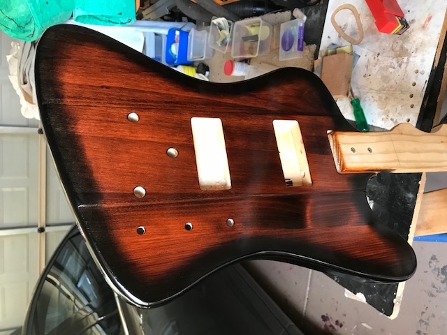

    Stained the neck and body using FW stains. Body is jarrah with black, and the neck is golden teak. So far have 25 coats of tru-oil , sanded back with 1200 grit and given two more coats. I will start working my way up through the micro mesh pads.

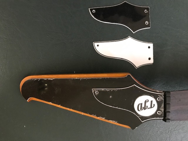

    Today I created a template for a TB truss rod cover - trying to keep it similar to the original design (which is normally difficult to see). The truss rod cover is to go on top of the black head stock cover. I could not decide on the colour so I made 3 different ones! The white may look good with the white pick guard. I think I will decide when putting it together.
