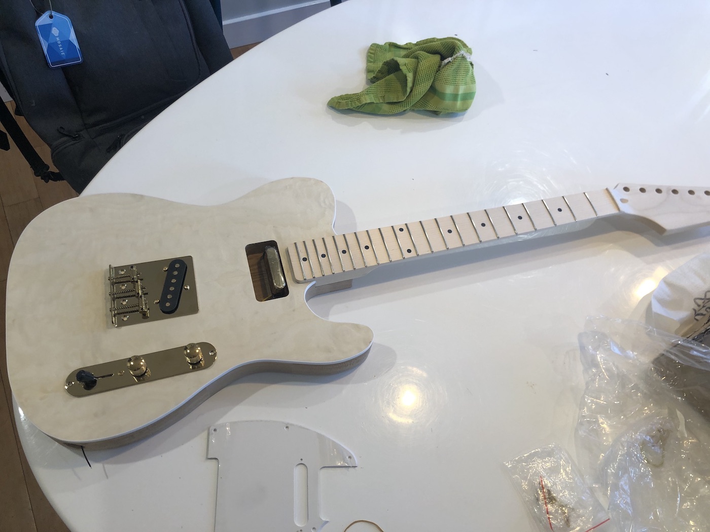

    I just received my beautiful TLA-1Q kit in the mail. My goal is to build a tuff-dog Tele. The top looks beautiful so I am excited. Wish me luck!

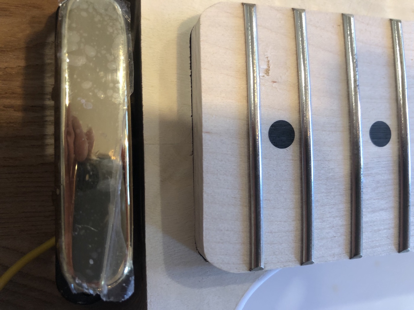

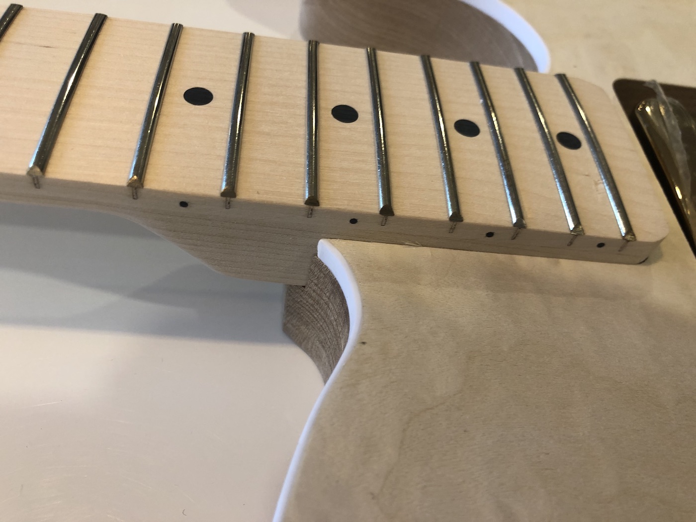

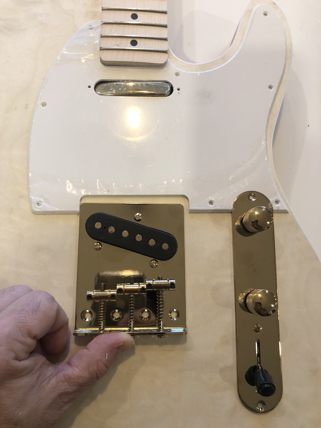

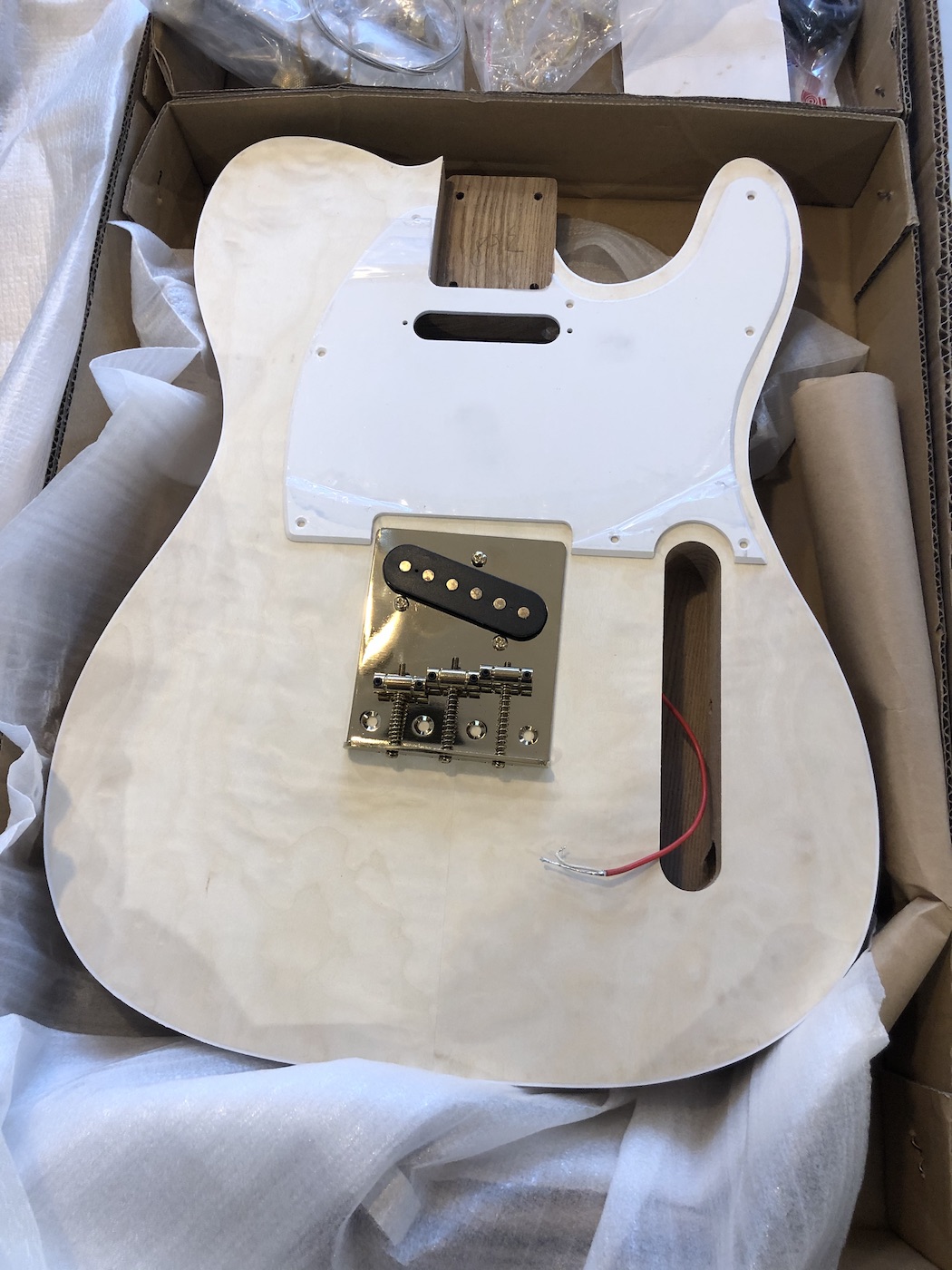

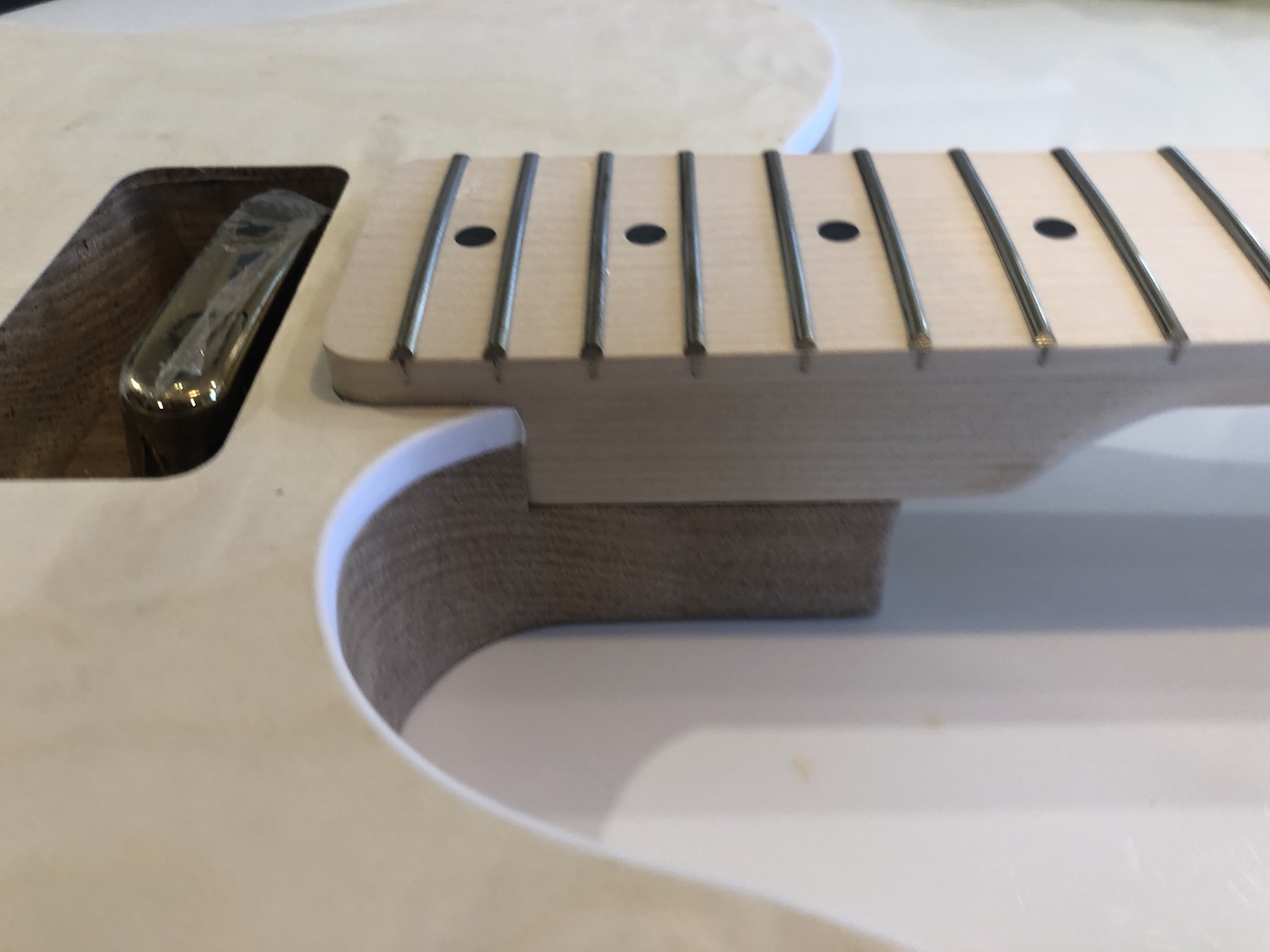

    So, I have started my mock build and it is looking great with the possible exception of the bridge position. It appears to be about 1/4 inch too far back. Will I need to route it closer? I will be using a tough dog pic guard so it won't be obvious if I don't reroute, but I don't think the string length will be right. I measured from the nut to the 12th fret and it was exactly 12". I measured from the 12th to the bridge and it was 12" to the front of the gold plate of the bridge. Is that correct?
    Questions:
    1. Do I need to reroute?
    2. Does the neck look good? It is very tight in the pocket.

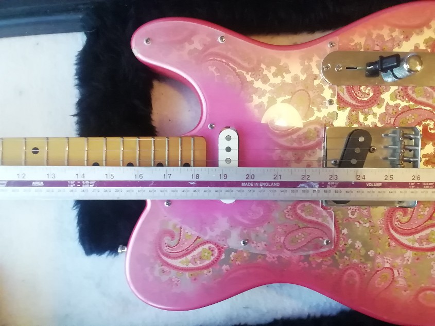

    A gap between scratch plate and bridge plate is usual, so that's not a worry.
    I've attached a couple of photos of my JV Japanese Telecaster with the rule up against the nut. Hopefully that's a reasonable guide. Its a home built scratchplate BTW, so not a perfect guide to how the scratchplate should look.

    As Jim says, there is normally a small gap between the bridge plate and the pickguard. Just search the web for images of Fender Teles and you'll find that it's part of the general design. The control plate butts right up to the 'guard, but the bridge sits off a bit.
    Quote Originally Posted by brandanop View Post
    That's very incorrect, as the scale length is 25.5", so the 12th fret should be very close to 12.75" from the nut. Make sure you haven't measured to the 11th fret (on my Tele the 11th is just slightly under 12" from the nut). It's best to use a solid rule (as in Jim's pics) rather than a tape measure.
    You are then better off measuring from the nut to the top E saddle for the overall scale length. Your pictures show the B/E saddle in the correct position for measuring the scale length. Measure from right by the top E slot to the middle of the top E string saddle. The intonated string length will be slightly longer than the scale length by 1mm or so.
    Sometimes the Tele kits do benefit from some slight enlargement of the bridge pickup rout, but it's normally only by a maximum 2mm or so, and can normally be done using a sanding drum on a Dremel.

    I re-measured and it seems right on! Thanks for this help again Simon! You are awesome.

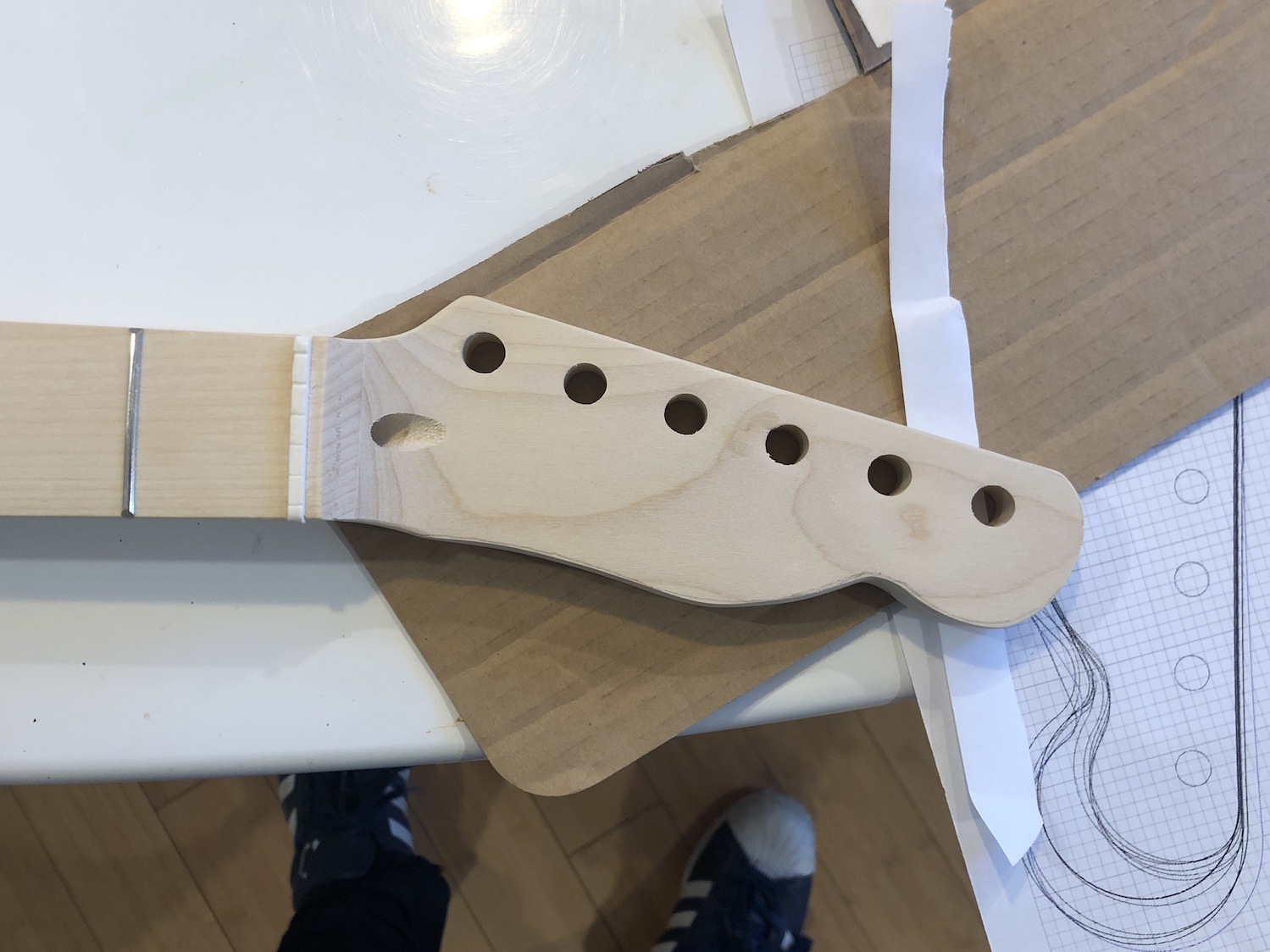

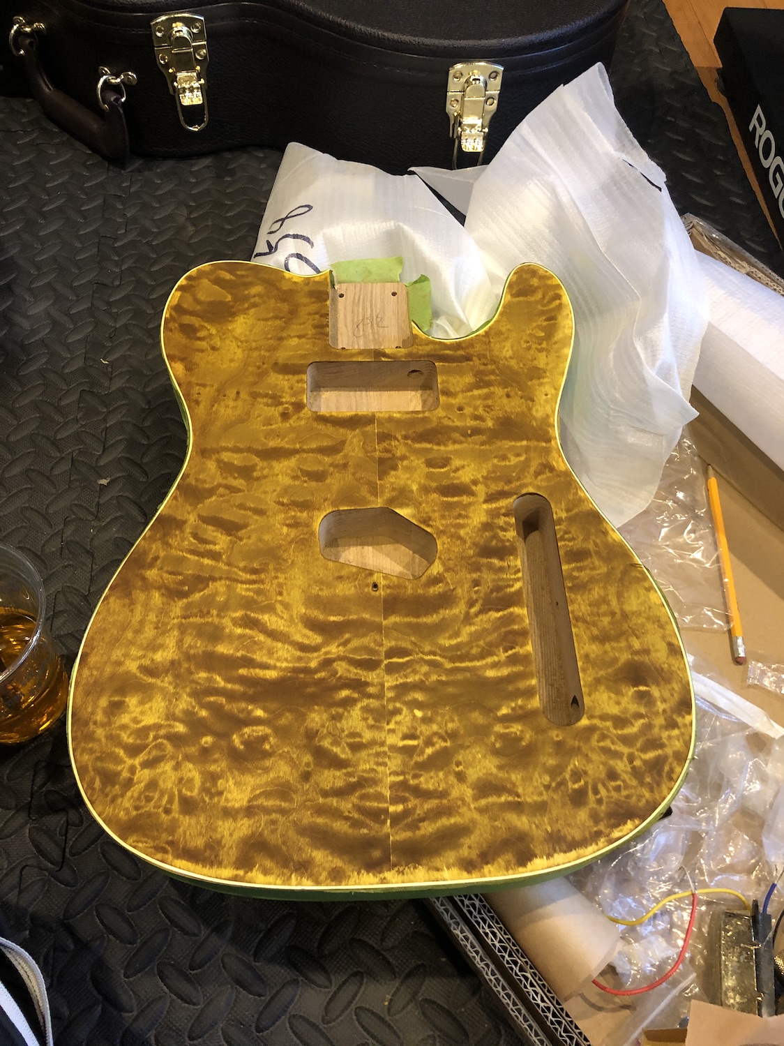

    So, I made some progress today. I did a mock build and validated the length and neck fit. I dyed the face gold after dyeing it brown and sanding back. I also cut the headstock by hand and then sanded it.

    Love the gold top. I am building something similar (see my build log).
    I have stained the finish on mine but am interested as to what stains and technique you used.
    Also interested as to what the back looks like.
    I had a lot of fun staining mine but have ended up with a brown guitar which was not my intention haha.
    However, the more I look at it the more I like it.
    However, my second one will be more like I intend it to be
    Cheers, Fatboy.
    Jan 2020
    Natick, MA
    38
    Hey Fatboy,
    Thanks! I hope it still looks good when I do the nitro. My process so far is that I used 1/4 tsp of brown Keda dye in 5oz of isopropyl rubbing alcohol and 1oz of hot water. I used a cut up t-shirt to apply the brown dye to the veneer. It dries quick and about 15 mins later I very lightly sanded the super thin veneer until it lighted up a bit. I didn’t sand much at all. A few hours later, I used 1/4 tsp of yellow Keda dye in 7oz of rubbing alcohol and 1oz of hot water (a little more dilute than the brown). I used a new clean t-shirt to apply the yellow. I did not wipe or sand it off. That is it! Next, I plan to use black lacquer to paint the burst and the sides and back. After that I will spray with Mohawk Clear Stringed Instrument lacquer.
