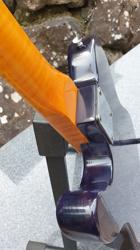

    All done now.
    She is all done.....and sounds nice too.

    Great. Love the high gloss finish. I wish I could do that too =)
    Mentor ozzbike's Avatar
    Sunshine Coast, Queensland
    1,109
    Quote Originally Posted by ThatCluelessGerman View Post
    Sand to 180 grit…pore fill…I used timbermate…sand 240, 320, 400. Stain.
    Aerosol oil based polyurethane. This is the one I used…
    https://cabots.com.au/product/cabots...oil-spraypack/
    3 coats ten minutes apart. Hang for two days. Wet sand 600 grit. Wet sand as flat as possible. As few shiny bits as you can get.
    Spray and then 3 coats after wet sand at 800, 1200, 1500, then hang for 7 to 10 days to harden. Then wet sand to 2000. Then I used 4 coats of a car paint cutting paste…then four coats of a liquid compound, 4 coats of a scratch remover, then carnauba wax.
    Laborious task by hand, but I find it relaxing.
