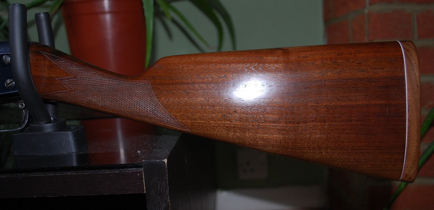

    Wow! 50 coats! I need to seriously reassess my finishing commitment!
    I have found that applying oil (I prefer Danish) with 0000 grade wire wool will bring a deep finish fairly rapidly, in about 10-15 coats depending on the wood of course. After my recent abysmal painting efforts I am returning to oil.
    Quote Originally Posted by impala59 View Post
    Yes, I've not had the fortitude to reach 50 myself, but I've have read many accounts of people who must be far more virtuous than I!
    My goal is typically 24 coats but sometimes I've had to reset my count due to "flatulence of the brain", and have probably finished up at 28-30 .
    I haven't used Danish Oil so can't make any comparison, but there are similarities between it and Tru Oil. Both contain boiled linseed oil, thinners (turps) and some variant of "varnish". I can't say if the Danish has higher build properties than Tru.
    BTW you won't find any 0000 steel wool in my shop. I wouldn't get it near any piece of timber I'm working on or finishing. The tiny steel fibres are the work of the devil.
    I'll second that. It has its place, but not on any finish. Those steel fibres really dig in and are impossible to see unless you are in really strong light (e.g. outside on a bright day), when they become blindingly obvious. Then you can't unsee them.

    Point taken Gentlemen, I was taught this technique by an old gunsmith friend for working on hard walnut stocks and have had no scratch or loose wire issues, maybe not so good on guitar bodies
    Both below about 10 coats each
