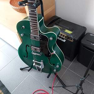

    Back for a second 'go' at the Gretsch. Didn't like the understated Dingotone supposedly 'butterscotch' so decided I needed a green guitar in my collection. Gave her a six-coat paint finish then three coats of Tru Oil and finally some Dingotone wax. Looking good BUT when refitting the electronics, guess what - NO Sound. Did the usual checking all solders but suspect it may be a ground touching a live. If you've seen the wiring of the Gretsch, you'll understand it's a veritable minefield therein! Bit of a struggle each time to un-fit the wiring and re-fit (tubing and other tricks to help), but to no avail. Any ideas fellas?Click image for larger version.

    I have no input re: the wiring, especially without seeing anything, but curious what paint you used under the Tru Oil.
    Tru Oil is very similar to polyurethane (actually contains x% of polyurethane) and can be problematic if applied over some paints.
    Like the colour though!

    Paint was acrylic enamel and it appears it has held up under the Tru Oil (fortunately) and wax. Stripped the electronics again today, insulated tape used on much of the braided wires just in case they were touching each other - well I know they are, you should try wiring this kit!! Plugged in and - nothing. Thought I'd try the switch in different positions just in case, and lo and behold I actually got what I believe to be both pickups sounding thru the amp in the neck position, so looks like a dud switch. Wondering whether anyone has tried a more expensive (therefore better??) switch from PitBull?
