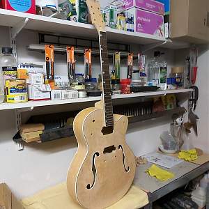

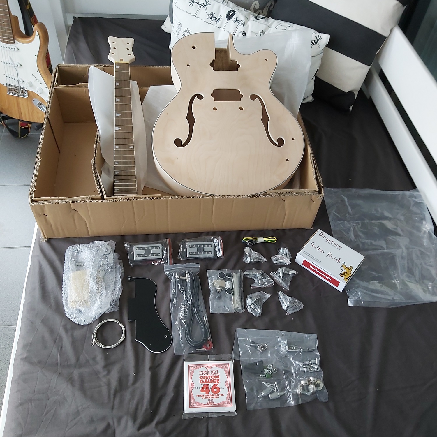

    Here we go with my 5th Pit Bull kit build. Have built hollow body guitars before (ES335 and LP hollow) so should have less problems than before but who knows? Just watched a video of someone doing a build where they (OK 'he') left the neck attachment until almost complete. Anyone have any experience whether this is a MUST or just more practicable? Cheers.Click image for larger version.

    It's really a personal working preference and your method of finishing the guitar. if you have the space to work on the guitar with the neck attached, then my preference would normally be to glue the neck on quite early, so that you can then fill any neck join cracks and finish the guitar as a whole. But if you are short of space, (and moving a complete guitar around with a wet finish can be awkward), then do neck and body separately, then glue the neck on and then deal with any neck join gap finish issues.
    I'd leave the guitar to settle for a few days before deciding if there are any neck fit issues that need dealing with.
    As the kit is fully hollow, you should have less overall problems fitting the wiring harness as it can go in via a pickup hole, which is a lot easier than trying to fit it via an F-hole. But the controls are a lot more spread-out than on a 335, so the harness will be a lot larger. Definitely easier to use latex tubing over pots and switches to pull them through the holes than using string or cotton.
    As the wiring runs are quite long, and you can't shield the inside of the body, I'd also be thinking of using braided screen single-core cable rather than single-core PVC insulated wire or vintage push-back wire to minimise noise pick-up.
  3. Liked by: OliSam

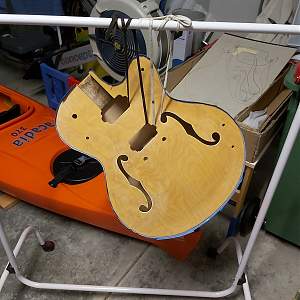

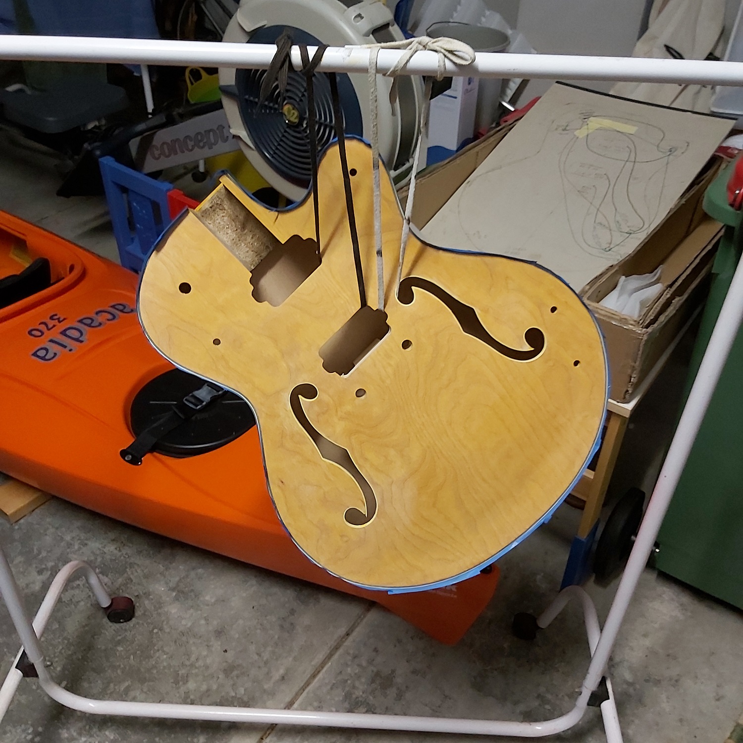

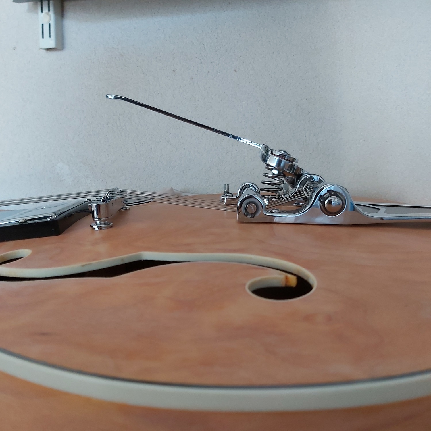

    Progressing the coatings of Dingotone. Still unsure whether it'll be better to keep body and neck separated until wiring installed. Bit concerned about the lengthy runs between pots. Anyone built a GR-1SF and if so any tips on whether wiring can be easily installed with neck in place?Click image for larger version.
    I've done an ES3, which is very similar. Yes, its quite easy. You just use the pickup holes to get the wiring in (you just have to pass one pickup down and back up through its hole).

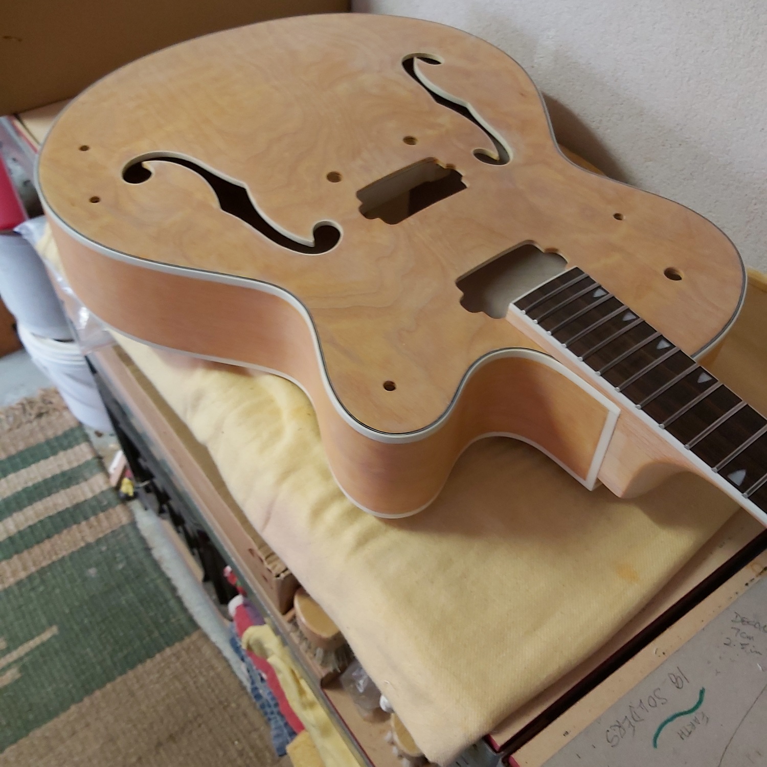

    Change of plan - decided to set the neck prior to wiring as I've done with all previous kits (habits eh?). Advised by Mr Dingotone to use brown paper to 'polish' the guitar and ordered his wax, which will be the final coating (a first for me). Also taken Simon's advice and ordered a bunch of braided wires from Pitbull for the electronics. How much more rain can there be!!Click image for larger version.
