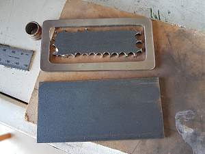

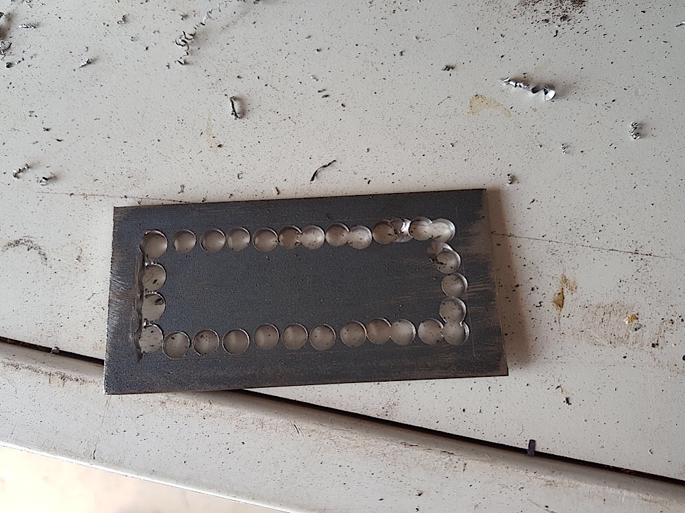

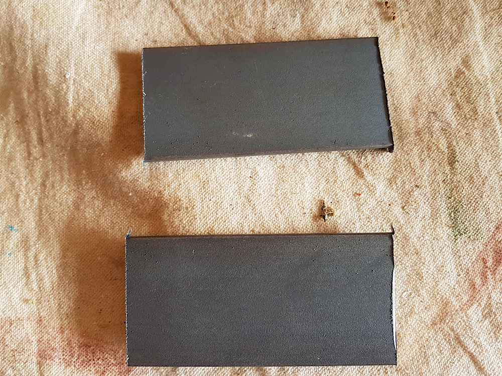

    Some pics of my pick up ring for a p-90, bloody hard work.
ID:	39348 Click image for larger version.
ID:	39350 Click image for larger version.
    Putting it into be chromed tomorrow, so far it’s cost me about $4 for the steel. A lot more though for the chrome.

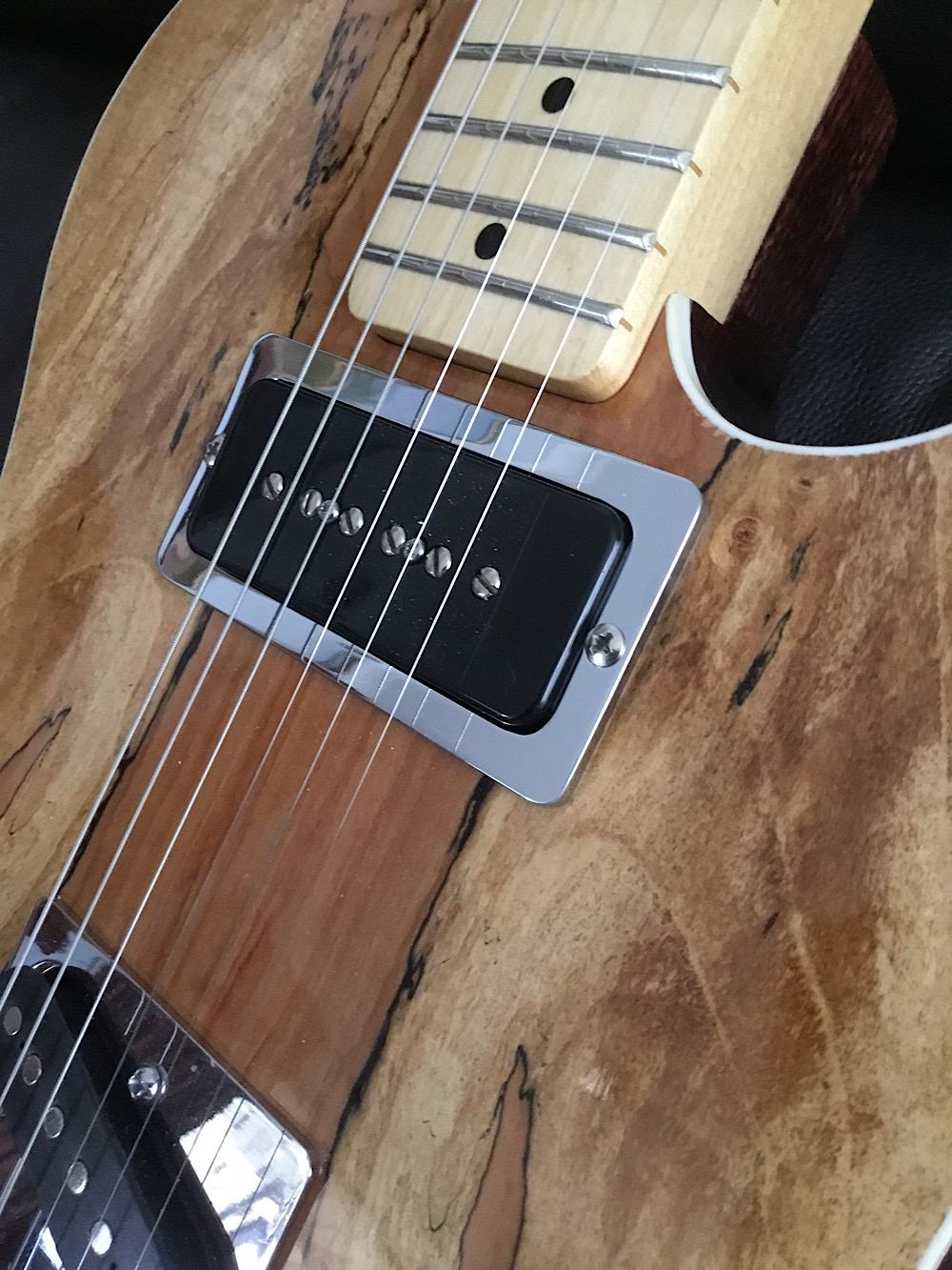

    Hi all, finally got my guitar finished. The wait for my pickup ring to be chromed was worth it. First time I have made something out of steel by hand and I am really happy with it. It matches the rest of the hardware and I’m over the moon happy. Hey Dozy, it only took about 3 hours to make so it wasn’t really punishment. In the end it cost me about $1 for the steel and $50 to have it chromed. Here is a picture of the final piece of the puzzle in place.Click image for larger version.
