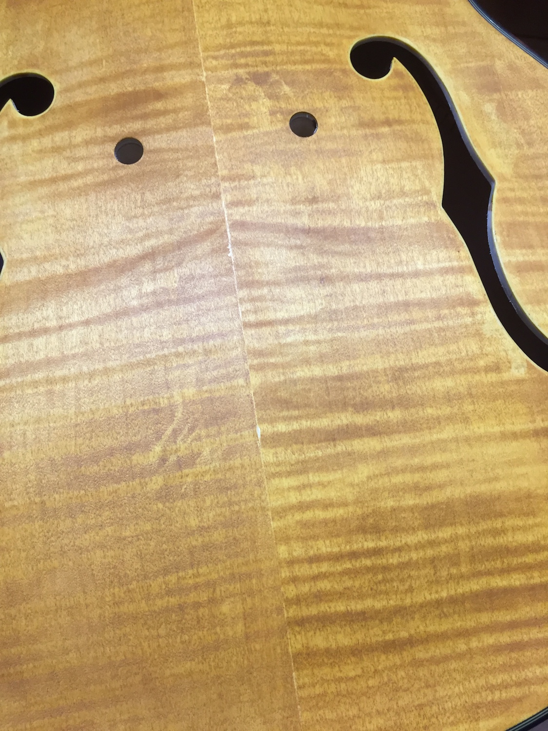

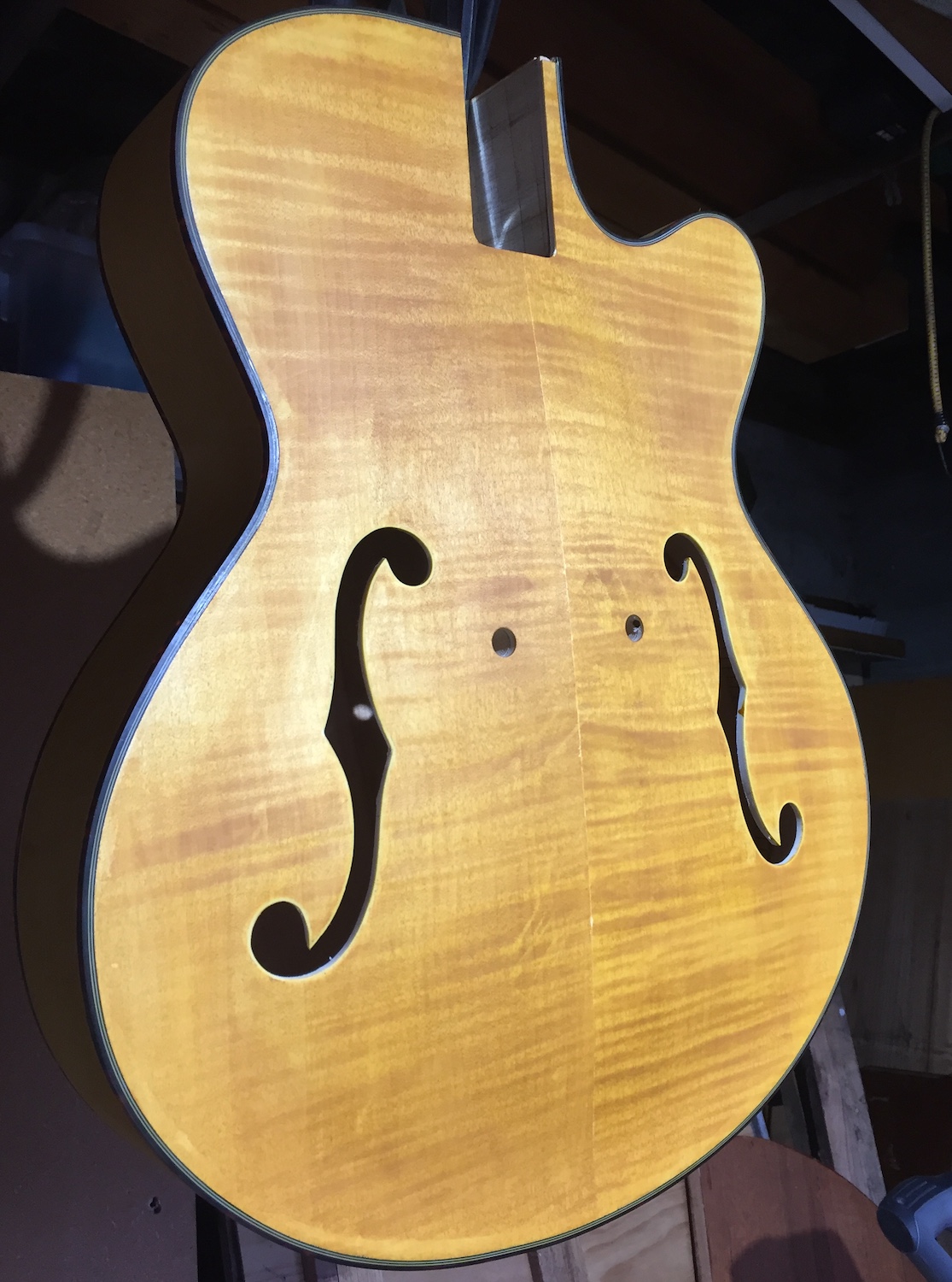

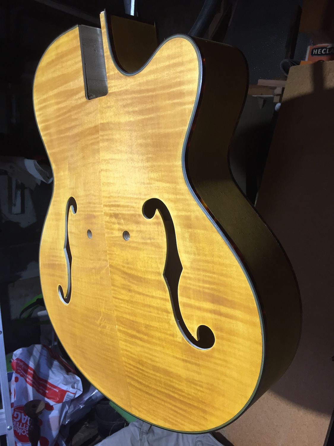

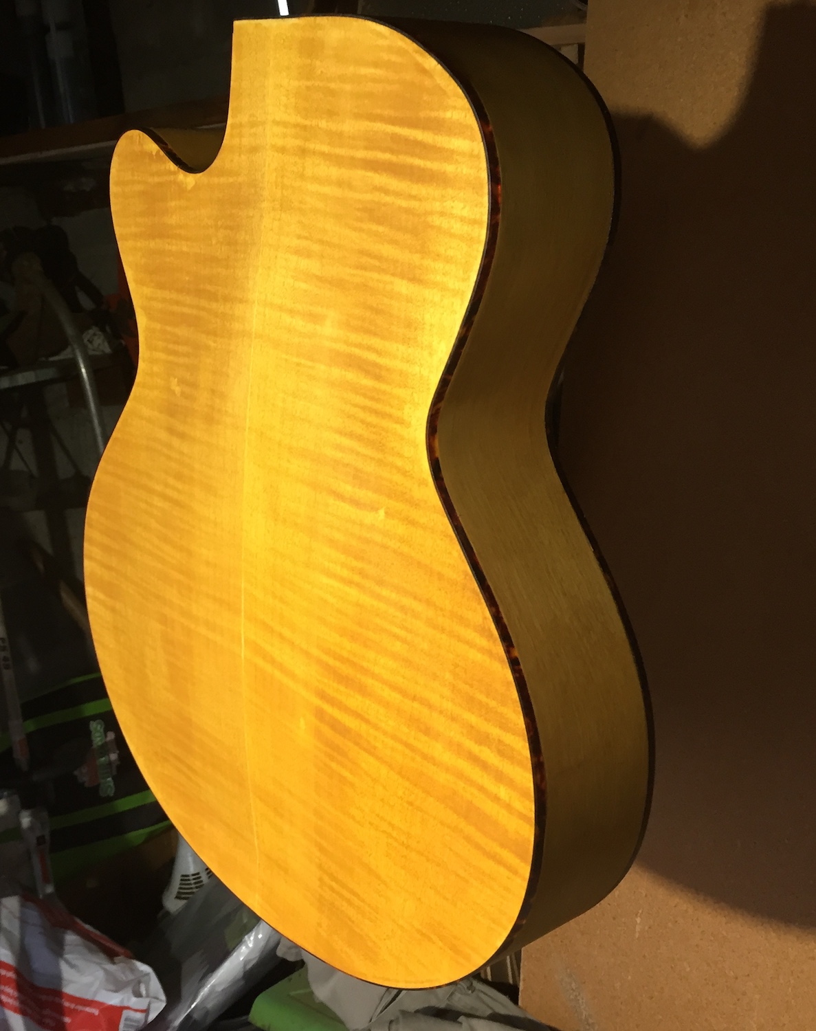

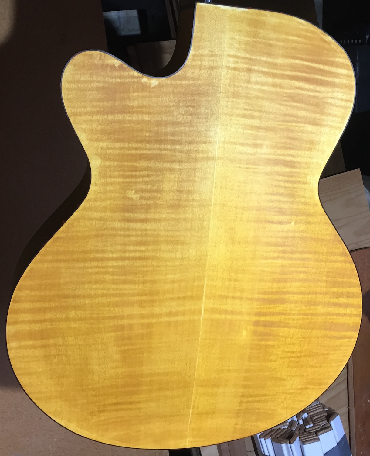

    OK, so I've fallen into the "I've sanded enough, and gotten rid of all visible glue residue, which could stop stain getting into timber" trap, and realised that the only known way to truly find all imperfections, and glue residue is to stain the bloody thing, and then stand back cussing over and over again...

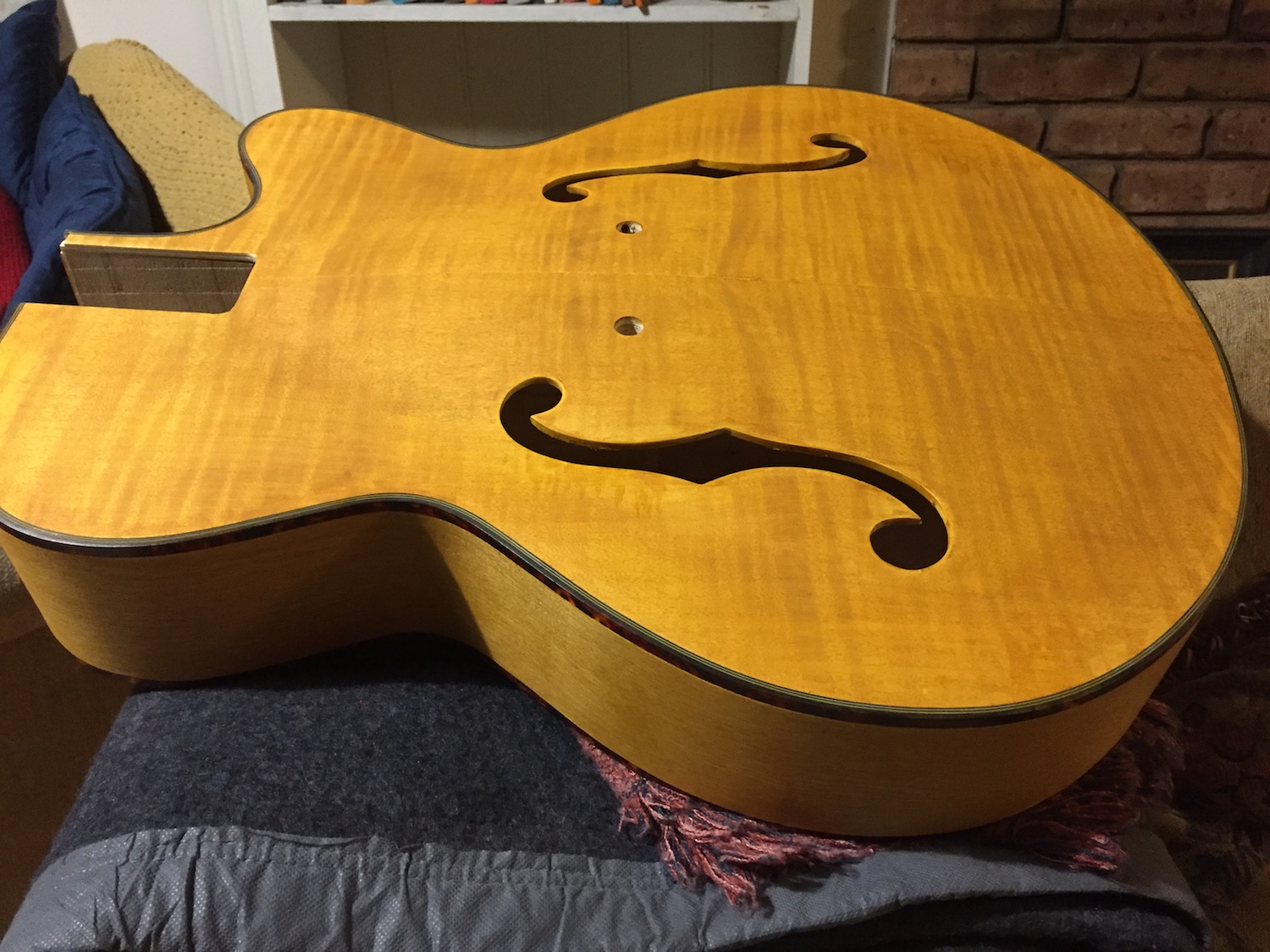

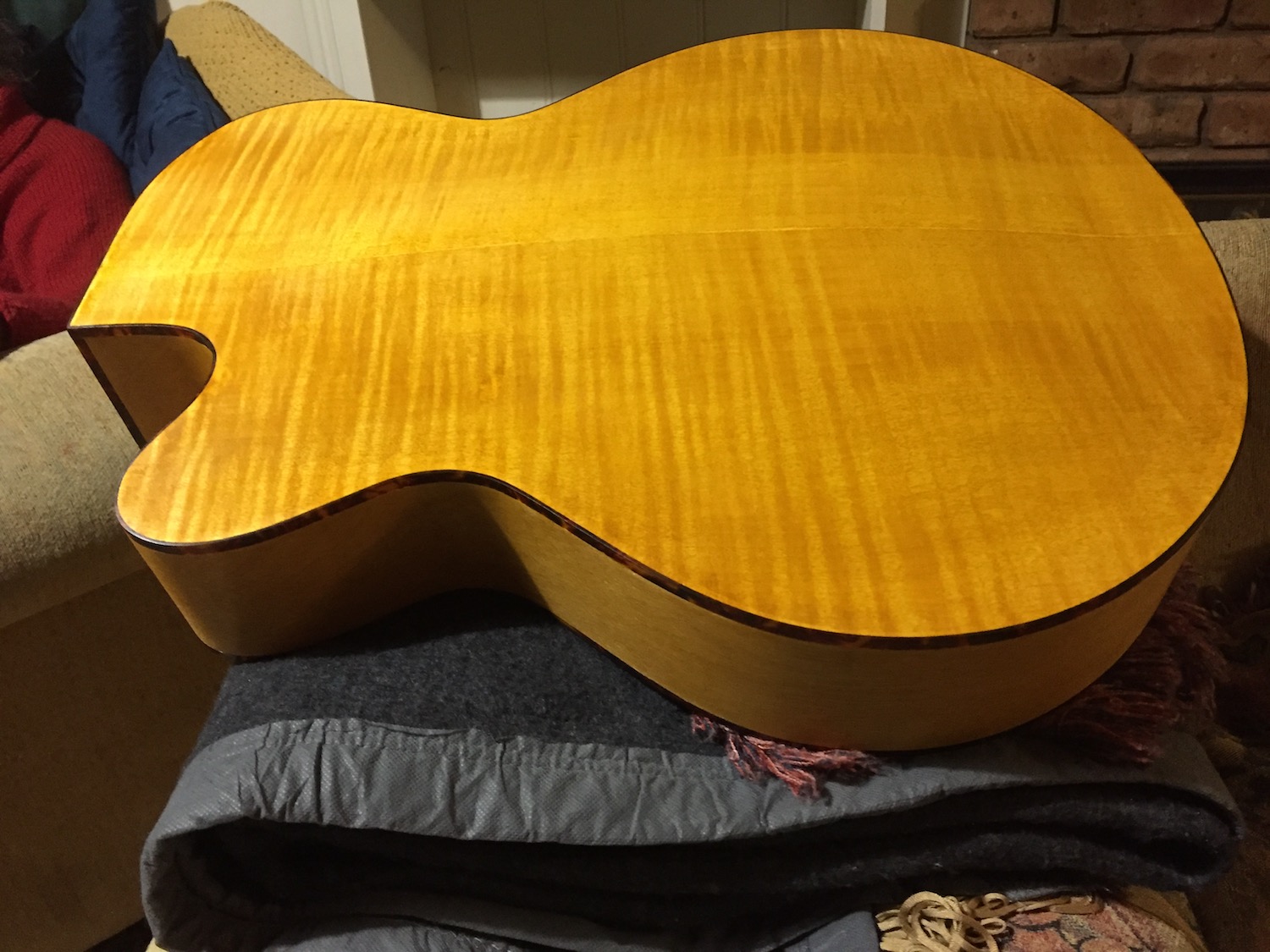

    After researching shellac, and it's application (basically, I found numerous people applying it in completely different ways, and youtube videos, of guys saying one way how to do it, then breaking their own rules in the process), so I figured, I'd just go for it...
    Acquiring shellac flakes - easy enough, as long as you want orange (amber) flakes, which I do - good thing, as it's the only kind of flakes the BGS stocks. Obviously there are other varieties (blonde, whether dewaxed, or not, and a couple of darker, red shades), but ordering online, and/or in bulk, which that would require wasn't my preference.
    Next step, was after researching the best solvent for it, was tracking down our Australian equivalent of denatured alcohol. Standard, (off the shelf from the BGS) metho was not recommended, due to a "profit before quality" mantra, which would mean shit results, with ridiculous "waiting for things to dry" times, I managed to find a local company that sells IMS (Industrial Metho), and they were happy to decant 1 litre, after I kindly declined their offer of my buying a 20l drum.

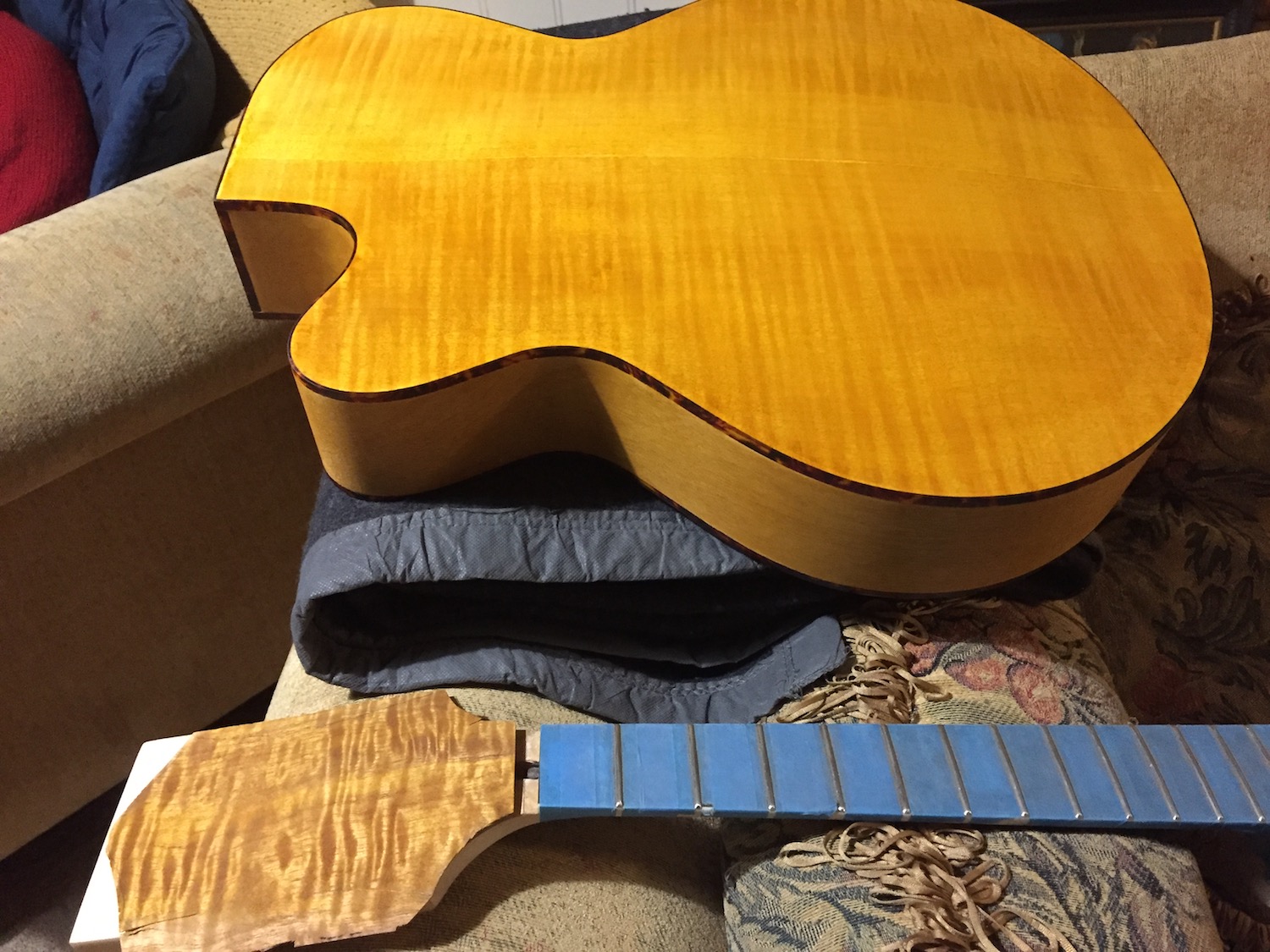

    So, this arvo, after waiting a couple of days to make sure the shellac was totally dissolved, and I had time to just go for it, I prepped up, and put a few coats on the back and sides. I was worried with the already quite strident stain, (which I had tried to tame down by sanding, and all I really did was sand through some of the flame on the back, and front), that the addition of shellac, would make it darker - too dark. However, I think the addition of some shine, from even just a small amount of shellac, has actually made it appear lighter. Must be a trick of the light due to reflected sheen - I dunno. No doubt, given time, it will indeed go a bit darker, as shellac tends to amber up over time, but I guess the gradual creep won't hurt.
    Here are a few progress shots, including one showing a bit of flame (I think Tas Oak) veneer I have roughly cut out to add to the headstock. It was naturally quite amber, so I just used the Coolangatta Gold, trying to get it closer to the body hue. Not sure, I may add a little more CG, but it's not going to be the same anyway, so I might just leave it as it is.
    Next up, is to give the top some shellac coats, and the rout out the pickup holes, and drill holes for pots, and switch, and output jack, then prepare for gluing it up, and putting it all together.
    I have been getting frustrated about the condition of this kit, (glue residue everywhere, poor workmanship, etc), which I understand is pretty typical for these kind of kits, and my being adamant about how I was going to finish it, made getting a great result virtually impossible. However, I have had to remind myself that I actually want this as a gigging guitar, not a showpiece, so I'm embracing all it's faults, and may even figure out how to add some more in the way of signs of wear n tear.... I guess only using the hell out of it will do that...
    Back, which has a few shellac coats, hence a bit of a sheen developing

    Front for comparison (in same light), without shellac...

    Back, and flame eucalypt veneer, which has Coolangatta Gold stain added, for headstock (as yet unshaped),

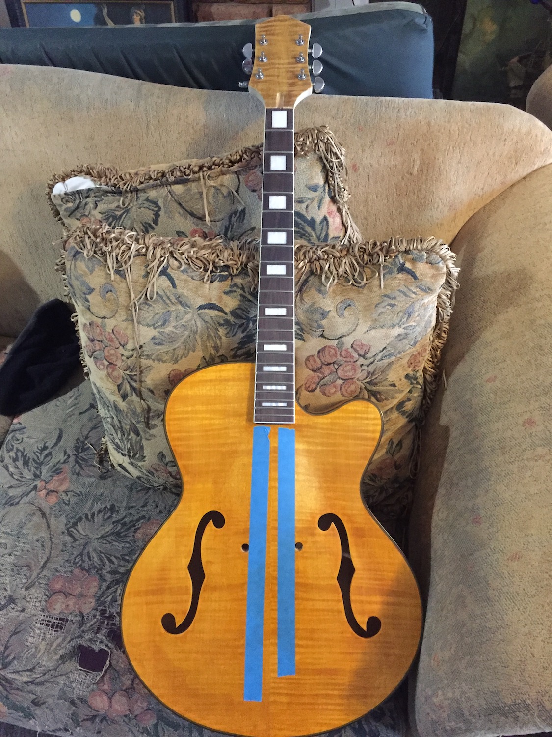

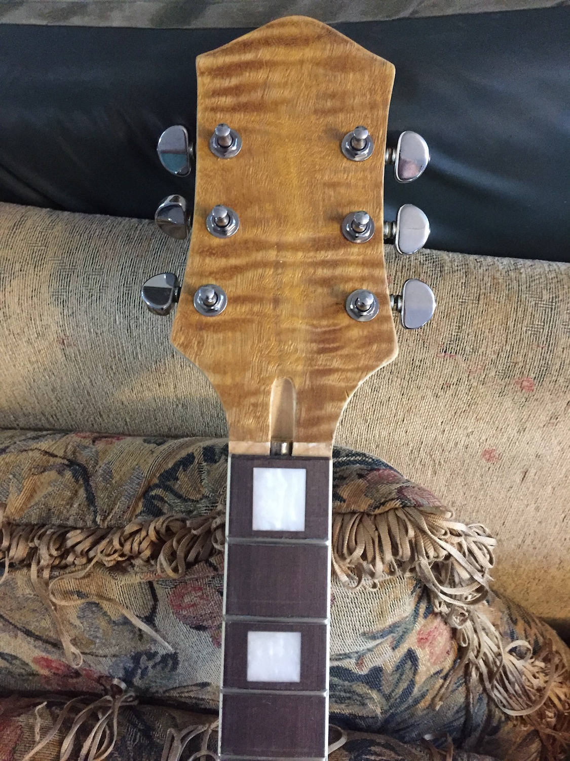

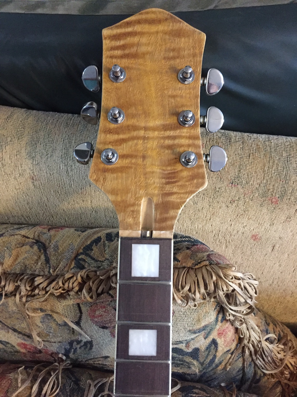

    Quick update - it's finally beginning to look like a guitar...
    I finished levelling, crowning, and polishing frets, and glued a curly eucalypt veneer onto the headstock, drilled for tuners, and have some old Grovers I was given, to use. I have gone with the "imperfections", and am running with the concept of an "old" new guitar. I'm also using a vintage Gold bigsby B6 , one 1950s Gibson P13 pickup, and some old pots and knobs I have here. The only new parts, (apart from the kit), are a switch, output jack, and one of the pickups, which is a reproduction by Curtis Novak.
    I'm not sure I'll keep the eucalypt veneer - it's similar to, but not the same colour as the body by any stretch of the imagination, but it was the first bit of veneer I found. Today I found what may pass as a Rosewood veneer, which I had safely tucked away in the shed, and I may yet use that, to get closer to the original H62 look.
    Here's a couple pics of progress.

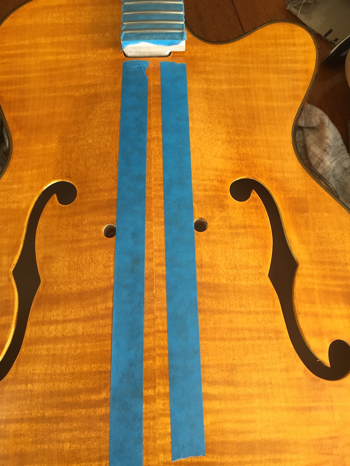

    Top taped up to check neck alignment before preparing for pickup cutouts, shows the off-centre flame maple join....

  10. #30
    Looking nice to me.
    I agree the headstock doesn't quite match the guitar body. It's not close enough in colour to be a match, and not different enough to be a contrast. Maybe try a darker stain first before changing veneers?
