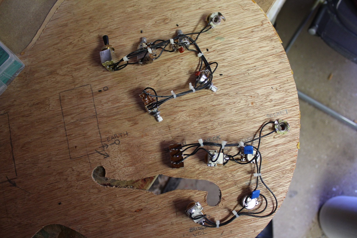

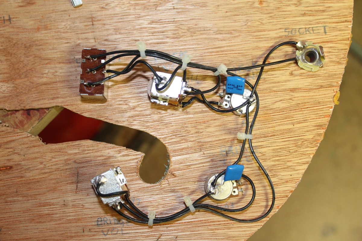

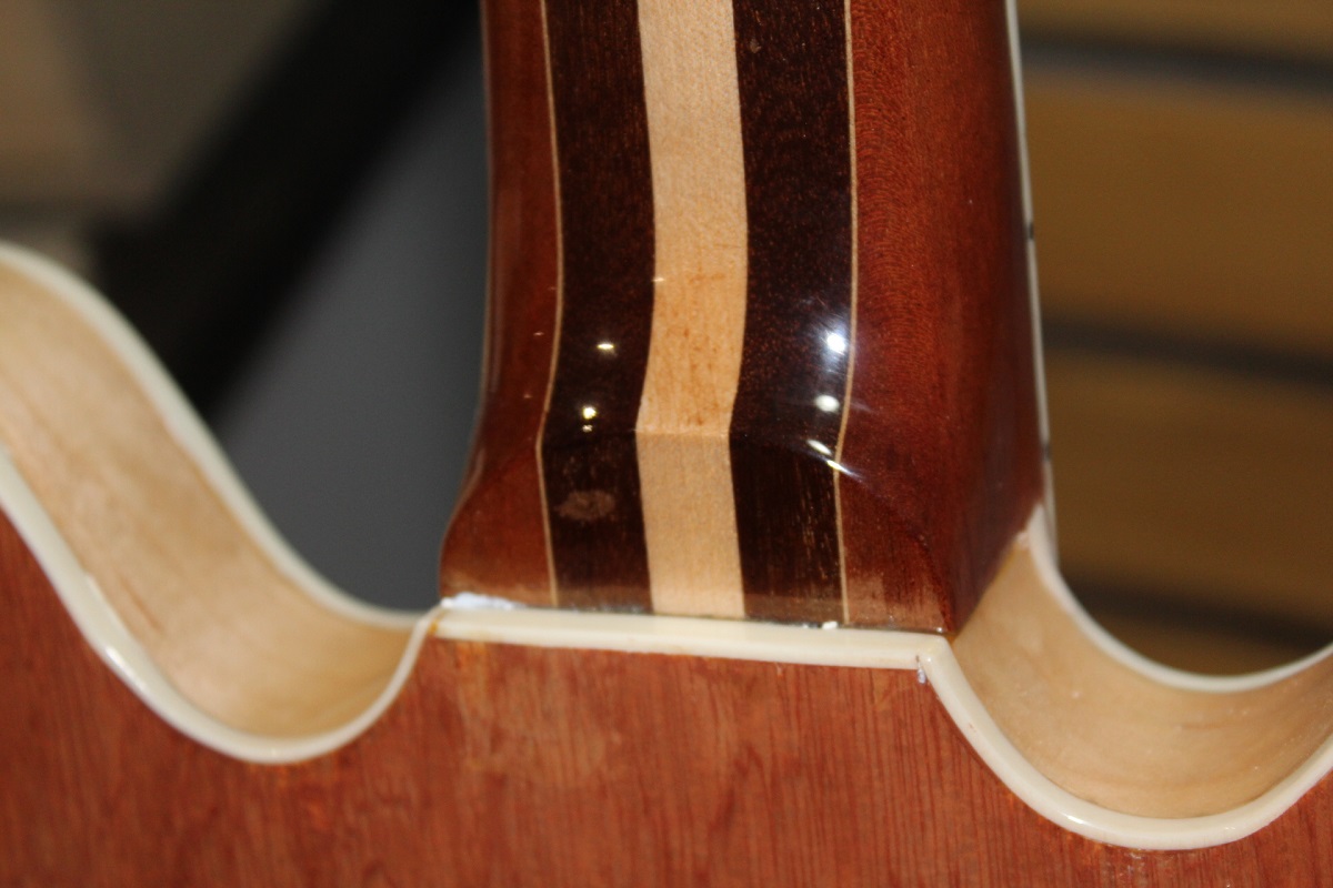

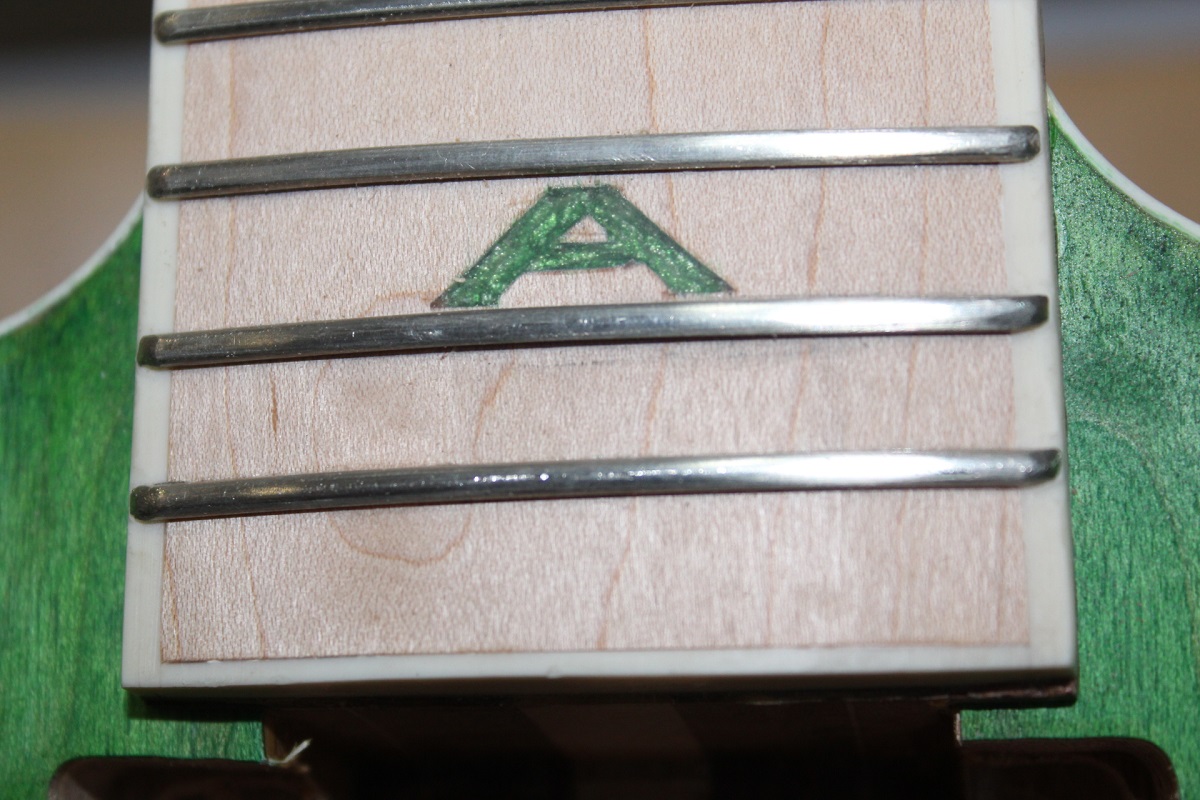

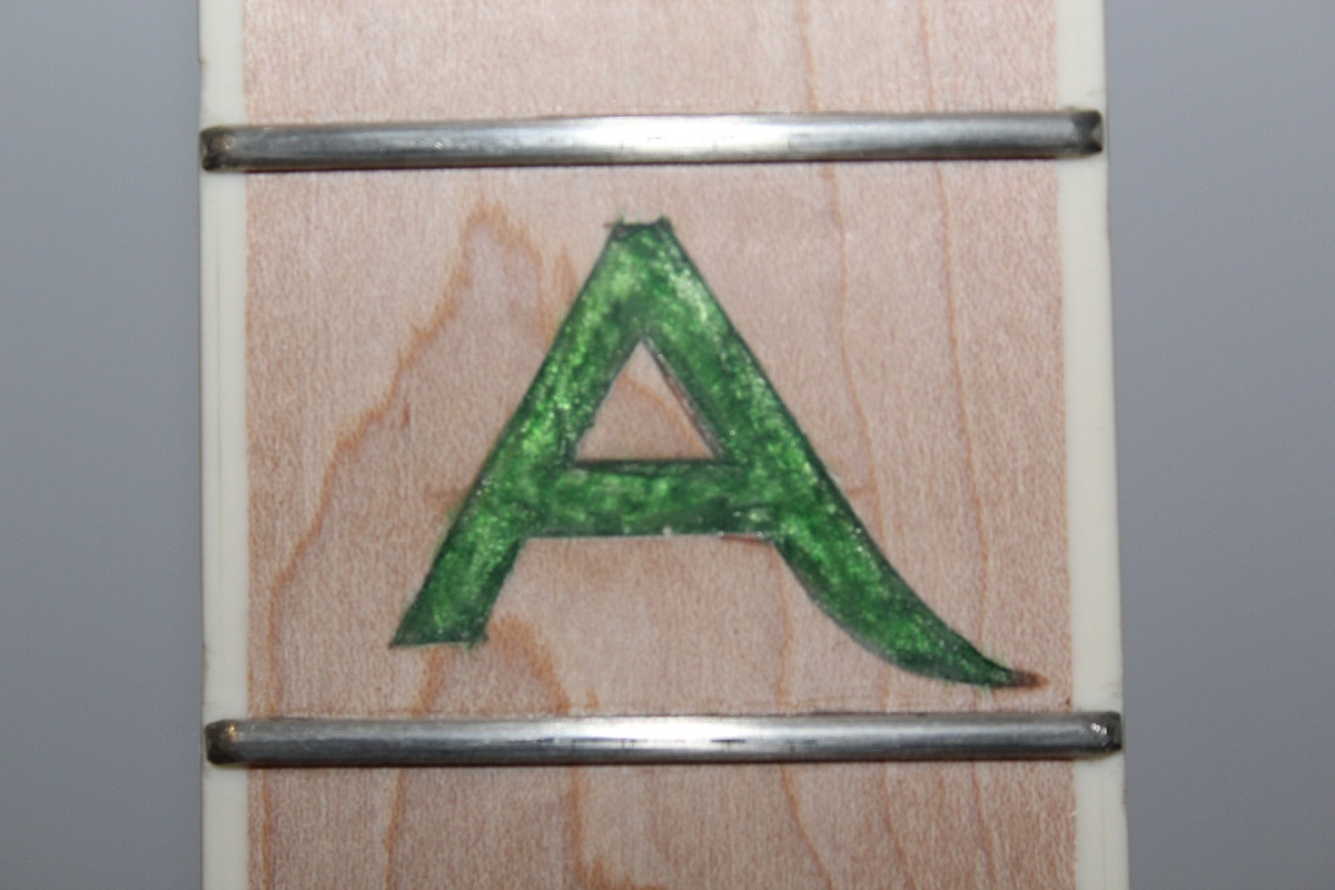

    A few more photos.
    Cheers
    Ricky
Name:	335 neck detail2.jpg
ID:	36706   Click image for larger version.
Name:	335 neck detail3.jpg
ID:	36707   Click image for larger version.
Name:	335 wiring1.jpg
ID:	36708   Click image for larger version.
Name:	335 wiring2.jpg

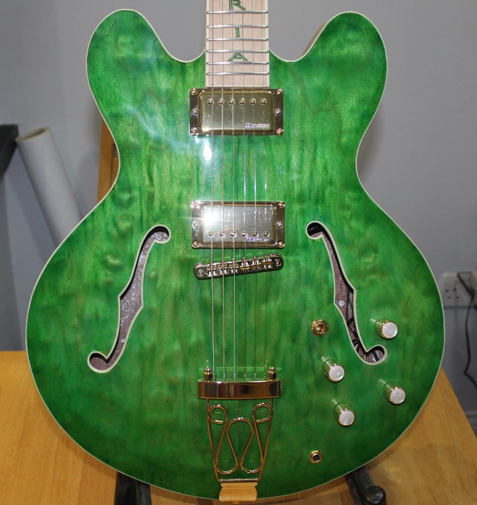

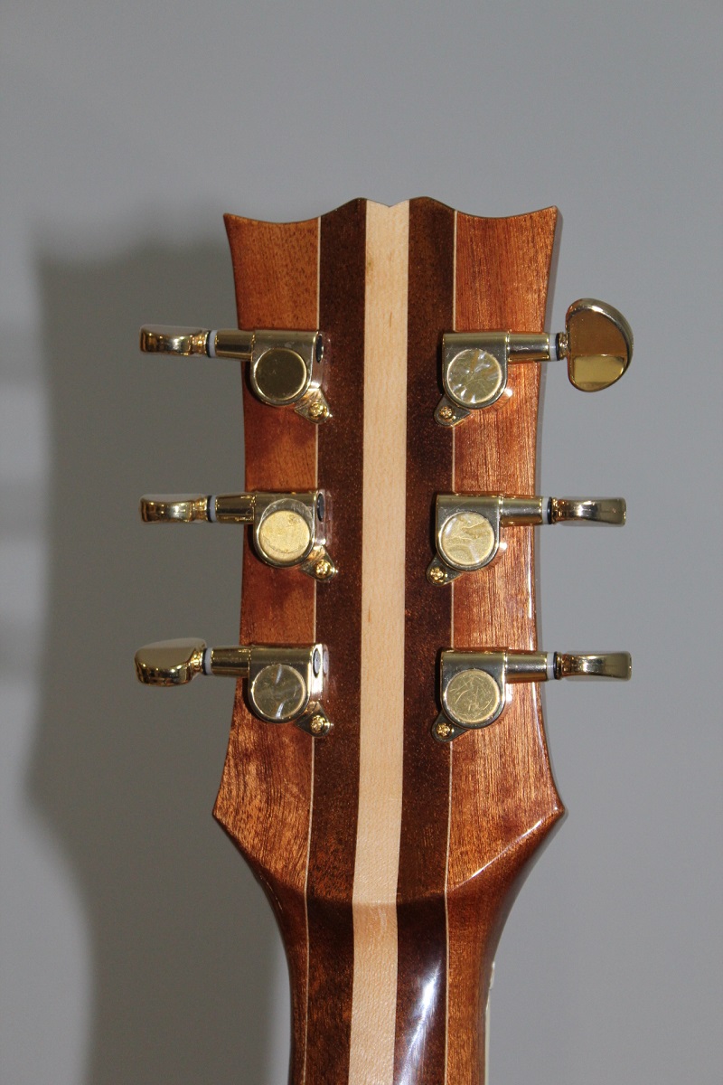

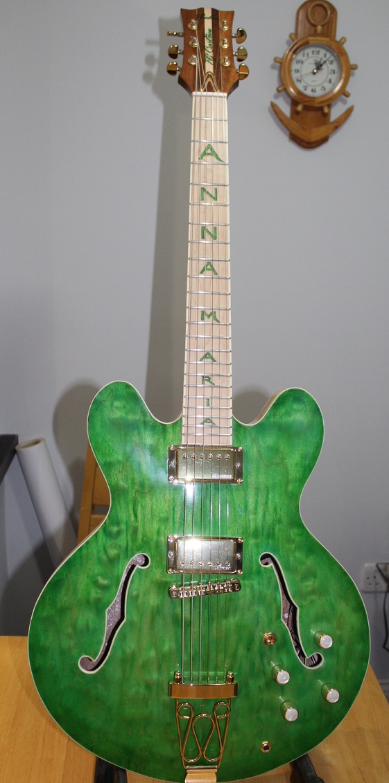

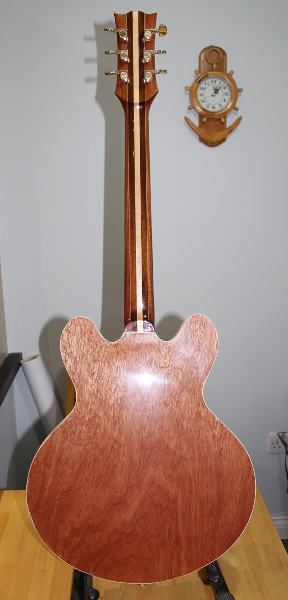

    It is Finished!
    Well, the shed project is finished!
    Polished, strung and intonated. (now all I have to do is learn to play it)
    The neck is a "D" shape so slightly thicker than the norm. I also made it 2mm wider all the way down as there are some bits of music I play where my fingers struggle with the Gibson sized neck. It is only an experiment but so far I have found that I can control the faster runs and riffs a bit better - my fingers do not slide off the edge of the neck.
    Tone is fantastic! I think this is mainly due to the solid mahogany centre beam. It is 4 inches wide and runs full length of the body. Possibly also due to the Warman Tennessee pu's.
    Bridge is at a bit more of an angle. I was trying to avoid running out of intonation space as it is a home build and measurements could be a bit off. As it turned out it intonates well.
    She is heavy but no tendancy to nose dive that I can see although I tend to play seated anyway.
    Finish is Omi-Cron 2k automotive lacquer - you definitely need good masks for that stuff.
    Probably about 24 coats - 4 at a session/day.
    Lots of wet sanding and then many hours of hand polishing with T-Cut etc.
    Great project and I loved every minute of it.
    If you have not built a guitar from scratch I can recommend it. Take each task as a separate project and take your time.
    Photo time.
    Cheers
    Ricky
ID:	37236   Click image for larger version.
ID:	37237   Click image for larger version.
ID:	37238   Click image for larger version.
ID:	37239   Click image for larger version.

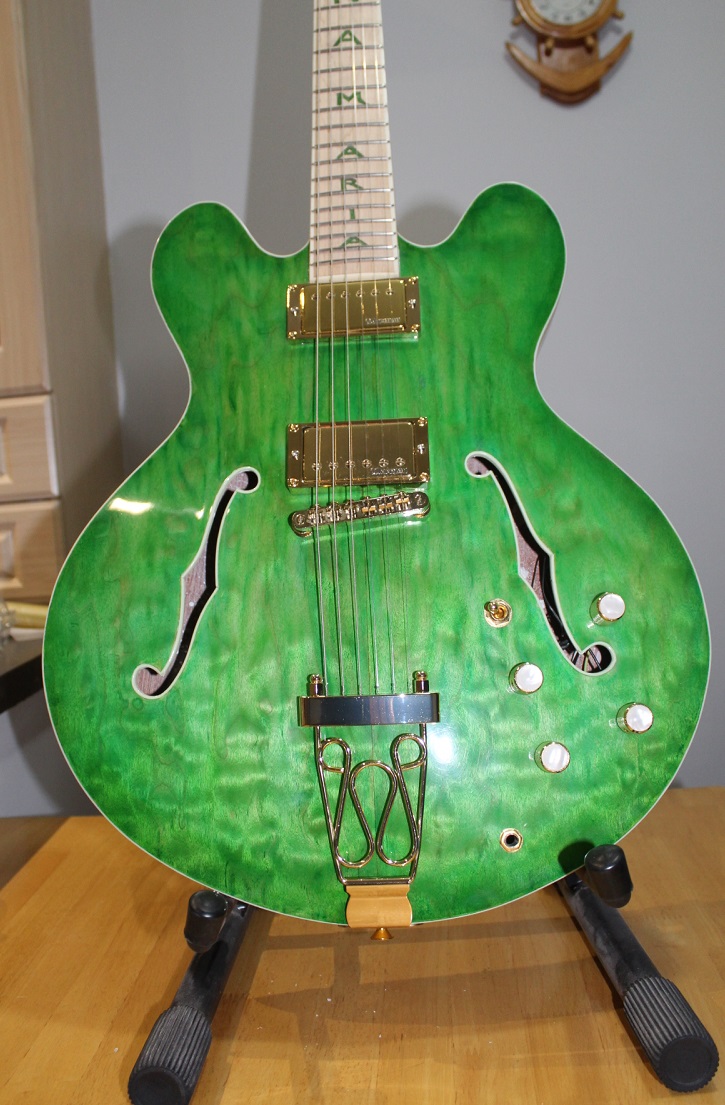

    A couple more pics.
    Cheers
    Ricky
ID:	37241   Click image for larger version.
