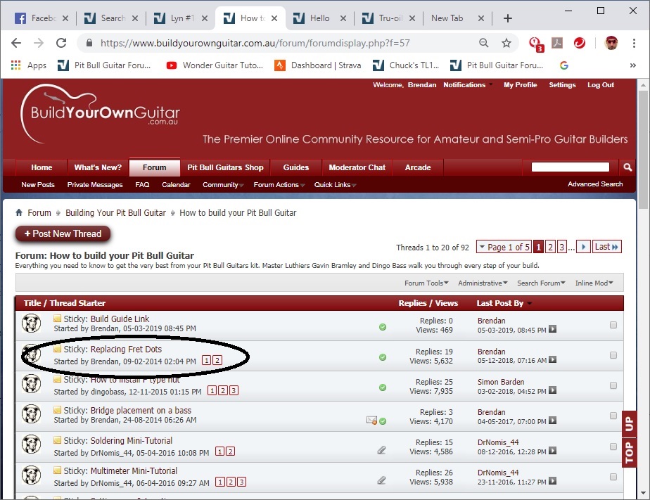

    Just tried to open & it says "invalid post" contact Admin..
    Not sure why - navigation via menus is below. There's also a dodgy vid here starring your truly: http://www.youtube.com/watch?v=9yA4c4rTseY&t=144s

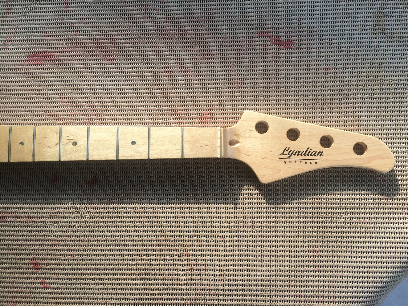

    Neck is finished...... so onto the body.

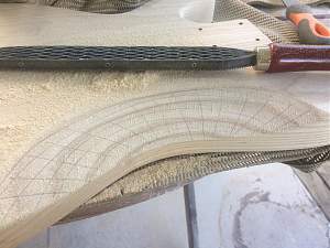

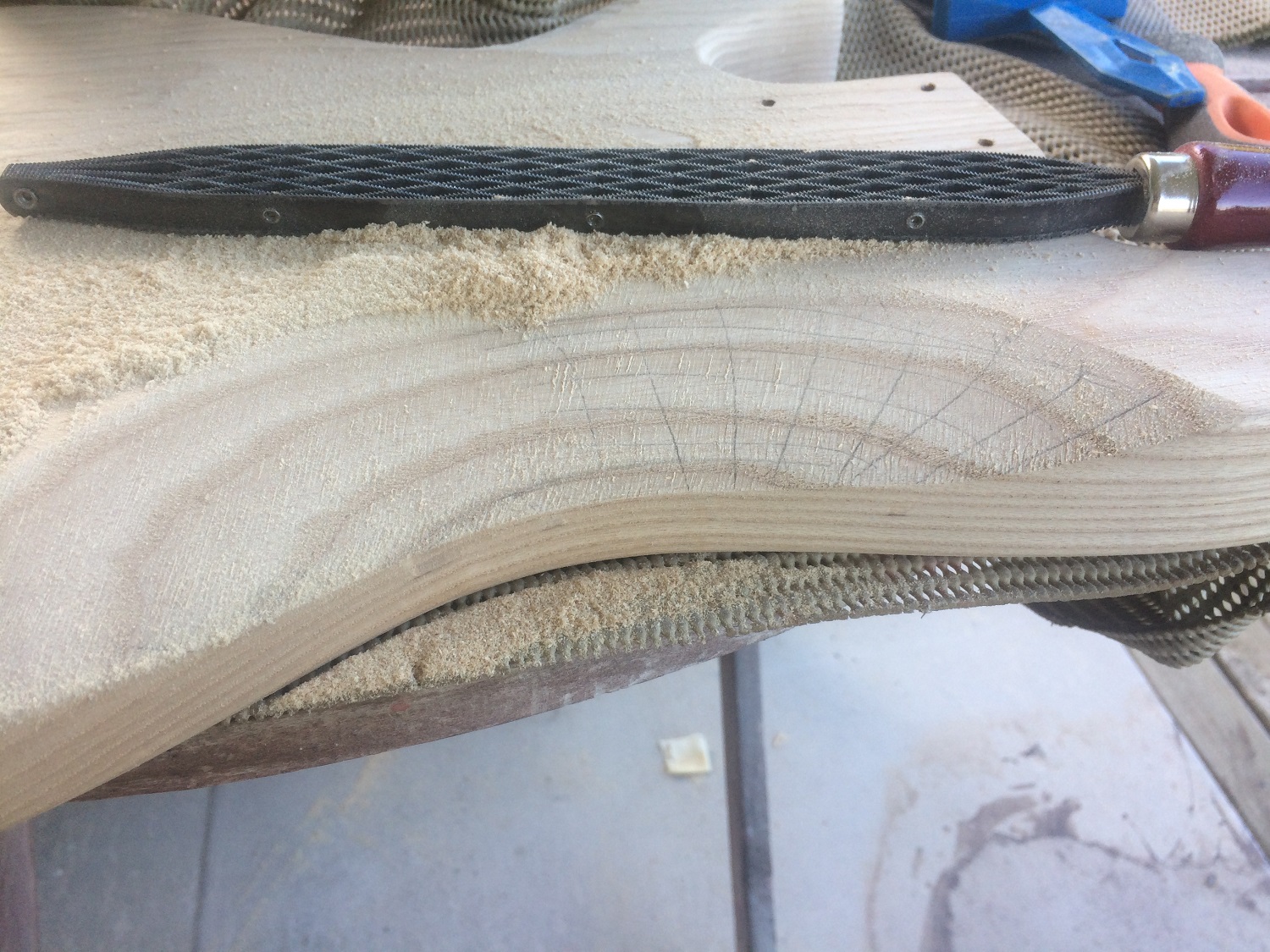

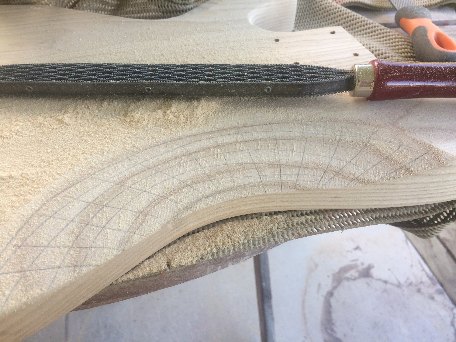

    I find that the belly cuts on these kits usually need a bit more work so its out with a pencil and my favourite toy, the Japanese Saw Rasp.
    Its a process of pencil marking the shape and removing what shouldn’t be there.
    First, roughly pencil the shape and then….
    Start removing unwanted wood. The File Rasp is a fantastic tool for hand shaping timber and it removes the wood fairly quickly but does not leave too many “chew” mark that you later have to sand out.

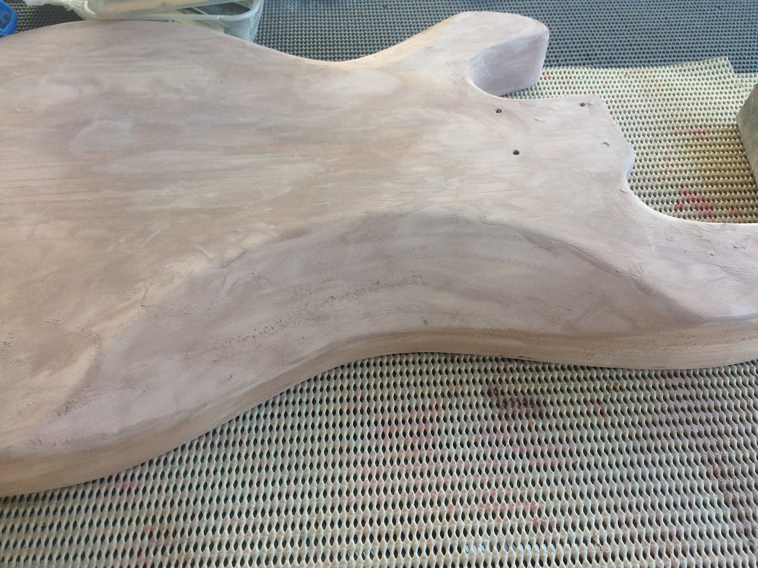

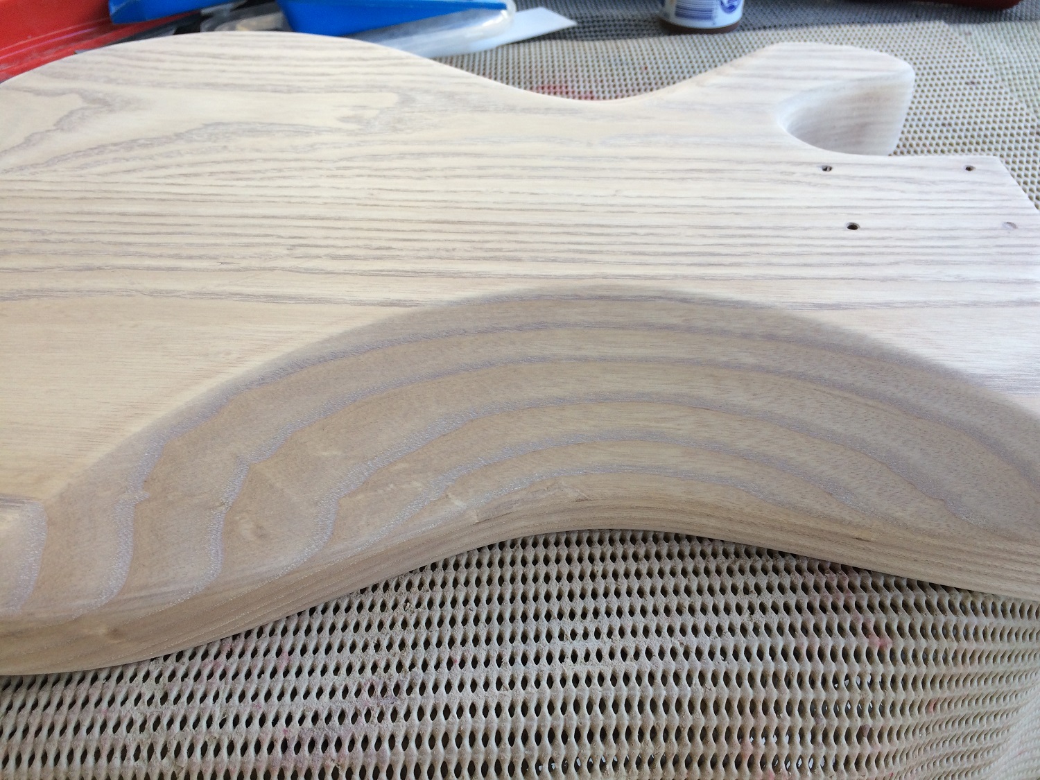

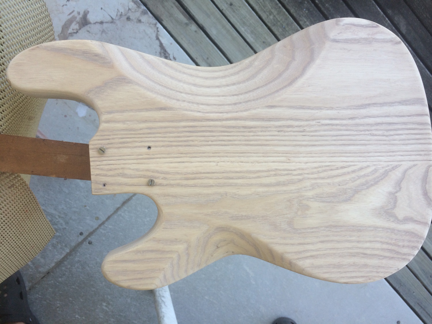

    I wanted to keep the striking grain, so I thought I would try and enhance it with some dark grain-filling. But I didn’t want to remove the grain texture, so I mixed up a slurry of Walnut TimberMate and water to the consistency of runny custard and applied it all over. Not sure it was the right idea, but I wanted to give it a try.
    When finished shaping, I applied the TimberMate slurry, let it dry.
    Then sanded it off.

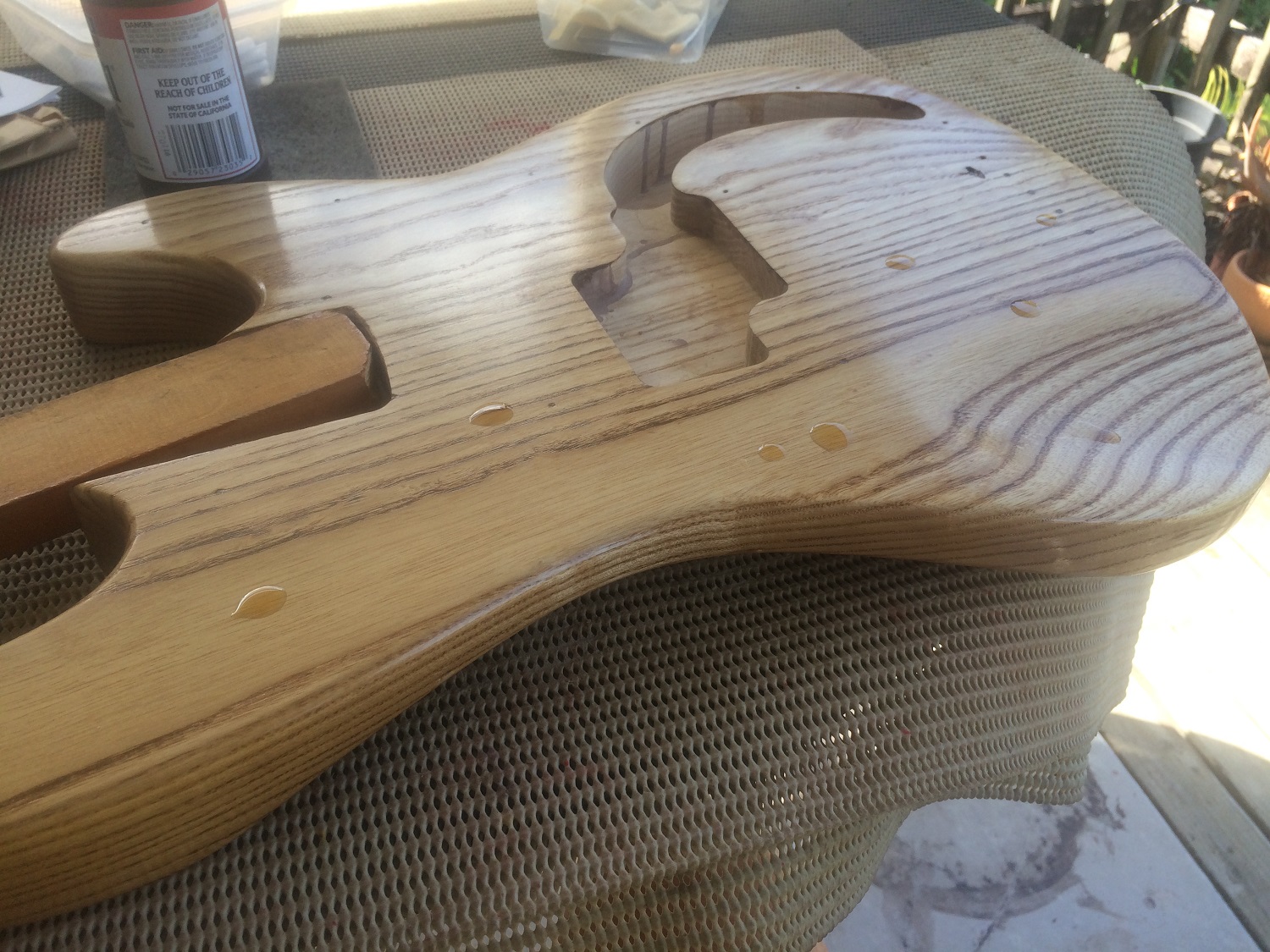

    The back of the guitar showing the belly cut. Plus, as most of my practice is done sitting down I also do (what I call) a “lap” cut. It’s a comfort thing. Lol.
    Now the fun part, applying the Tru-Oil finish. AFTER applying a “soak” coat I apply multiple very thin coats of T-O. I find that applying the T-O in sections is the easiest way to go.
    You can see 8 drops of T-O and this is more than enough to do half of the top of the guitar. By the time I have wiped this over the bottom half I can feel the application cloth start to drag as the T-O is spread out and starts to dry. Follow this procedure for the rest of the guitar and then you can hang it up for a few hours to dry. Do this about another 20 times and you will end up with a nice thin layer of T-O on your guitar.
    Here in Brisbane I can apply 4 coats a day so, weather permitting, I can usually apply all the T-O in about a week.
    I will now hang it under the house for another week until the T-O stops “gassing off” and then I will try and get a gloss finish.

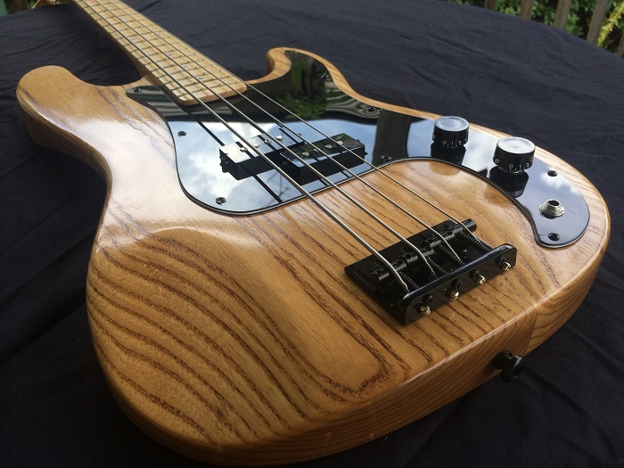

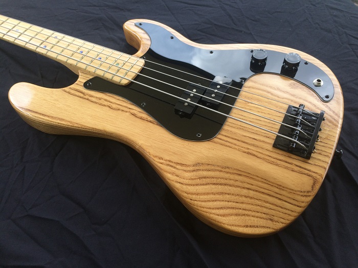

    Front

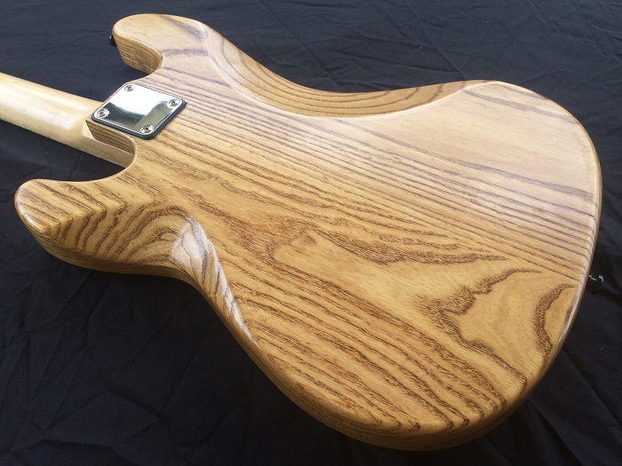

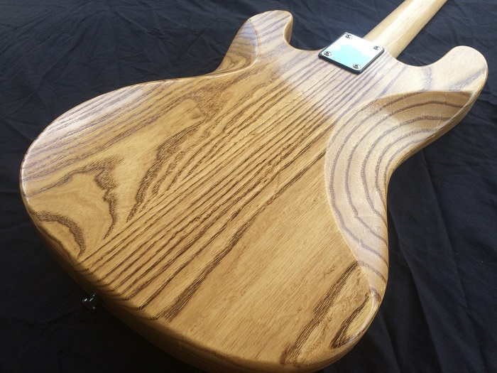

    Back

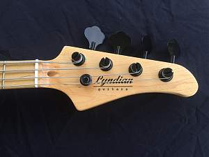

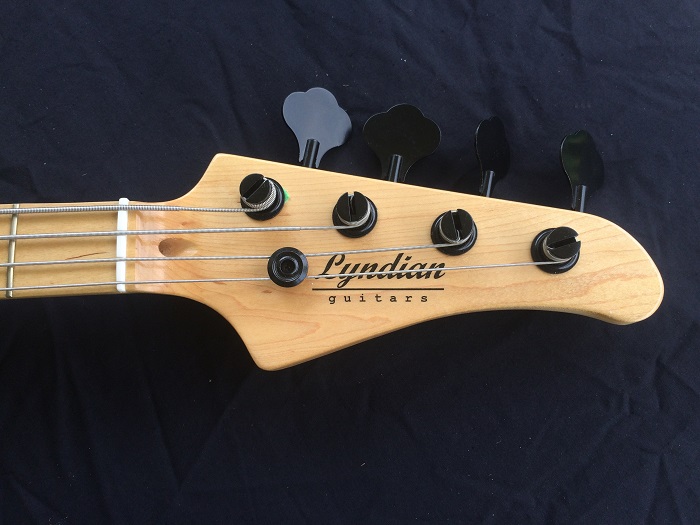

    Headstock
    All in all I am quite happy with the end result, but I need to revisit the electrics. The cheap pots are little more than on/off switches. All the control is within the first quarter turn of both pots. I have also noticed that compared to another bass used at church (a real Fender P) it lacks a wee bit of volume. I was a bit surprised as I updated the pups with ToneRiders which, in the past, have been excellent products and every bit as good as original Fender fare. I am hoping that better pots will address this problem.
    I might also upgrade the hardware at some stage and get rid of the cheap and nasty bridge and replace it with a better quality string through. This might also help address the volume issue.
    But even as she is, I'm very happy with her and she has earned a place in my bass arsenal.
    Cheers guys
