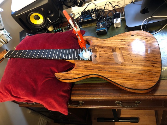

    Thanks Simon, will do. Next time I値l mask up, didn稚 think it would bleed so far
    I used linseed for the first few coats and then crimson finishing oil
    How long since the last coat went on? I'd certainly let it dry well (several days) before gluing.
    Oh really!! Ok well last one went on yesterday so I値l wait a week or so.
    I was going to do it tomorrow lol,
    I値l take it into work where it has an excellent extraction system so hopefully that will help dry it out for the next week

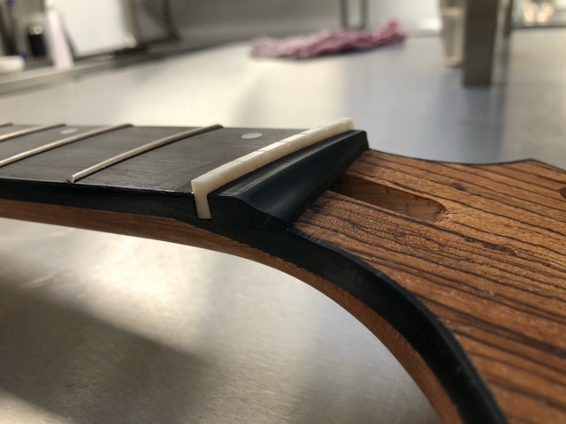

    So here goes! fingers crossed!
    i've triple checked the length and angle and they all line up, the pickup fits in (just)
    hopefully i've put enough glue in, i followed Simons instructions, used a paintbrush and only a tiny bit squeezed out, so we will see tomorrow

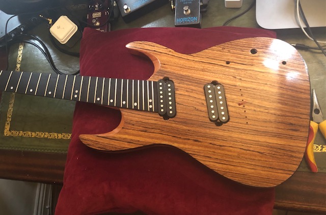

  8. #18
    so ive installed the pickups and ive just noticed that the neck pickup is a little off, the poles dont line up with where the string goes, i think the routing is at a slight different angle, will this matter much or is it something that i should worry about.

  9. #19
    Slightly off shouldn't make any difference except cosmetically. The magnetic field from a humbucker is spread out wider than that of a single coil, so you can normally be a long way out before you notice a drop off in output. But it doesn't look like the pole pieces will miss a string completely, and just be offset by a little.
    My only concern here is that the pickups have no adjustable pole pieces, so you can't adjust the string to string balance. But that is generally more noticeable when playing clean than when driven.
    It looks like there is a mm or so of spacing around the pickup bobbins which should allow some movement, so it should be possible to enlarge the pickup cavity slightly where the baseplate and legs touch the sides (stopping fully correct positioning) but just undercutting the top, so that the top of the rout remains unchanged in appearance and you don't need to worry about the finish being damaged. A small sanding drum or other abrasive bit in a Dremel would be ideal for this, though a small chisel could also be used. Don't forget to mask the top first if you do this to prevent damage.
    Paint the inside of the routs black, and you'll never see any of the extra cutaway.
  10. #20
    Member lickmydoo's Avatar
    Oct 2020
    Geneva, Switzerland
    26
    Hi,
    Im building this kit as well and had some thought about the pickups.
    On mine too, the neck pup poles are poorly aligned. Lurking the forum, i didn't find a post talking about the sonic quality of the pickups in this kit.
    But i don't think they are good pups and having the high and low strings slightly off surely won't help.
    Some guys talked about adapting another pickups to the 16ー baseplate but it must be done with rails pickups, otherwise strings spacing gonna be an issue.
    I guess the first builder who finish the guitar will add more info on this subject.
