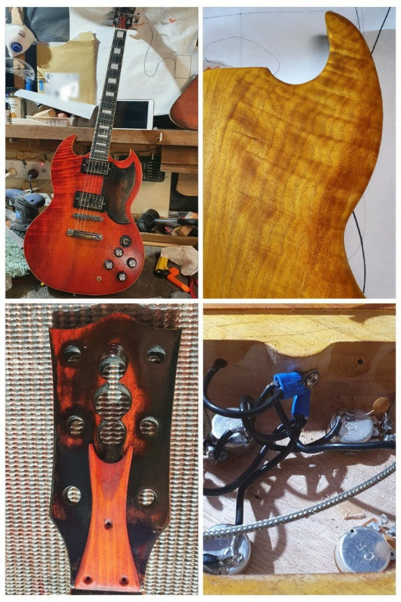

    AGM-1F modified.
    This is my AGM-1F kit that I modified to a stop tail piece, mahogany body and neck, ebony fret board, finished with a stained burst top and a little candy over the top, headstock to match and the back is also stained, all clear coated in 2k clear.
    Guyker locking vintage tuners,
    Wilkinson roller bridge and tail piece,
    Iron gear Blues engine PAF’s with their Alchymist P90 in the middle,
    Tusq black XL nut,
    Bourns pots,
    Orange cap.
    Wired so the PAF’s are selectable from the three way switch, and the P90 is constantly live, all three pickups have individual volumes with one master tone.
